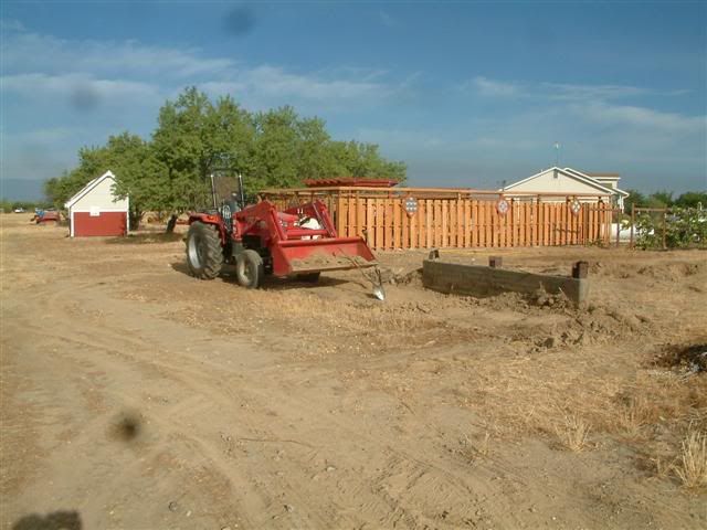

I have a similar problem on a jobsite where I'm building a pole frame equipment shed. Got a concrete/rebar reinforced pony wall left over from an old dairy barn on the site that's in the way.
It's 16ft long, 2ft above ground and about 2ft below. Need to get rid of it. Solution: a friend with a TLB is coming by next week to dig a nice grave along side that wall and tip it into the hole. Backfill and problem solved. No need to bother with jackhammers and hauling.
