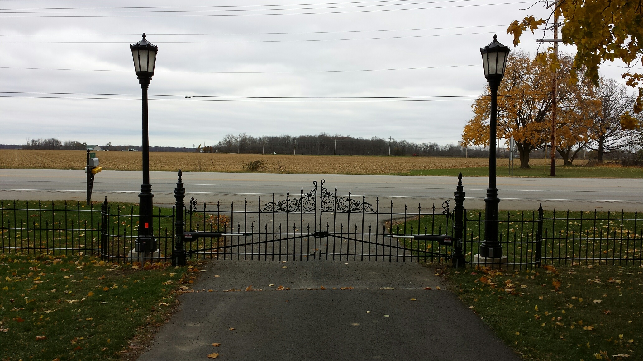

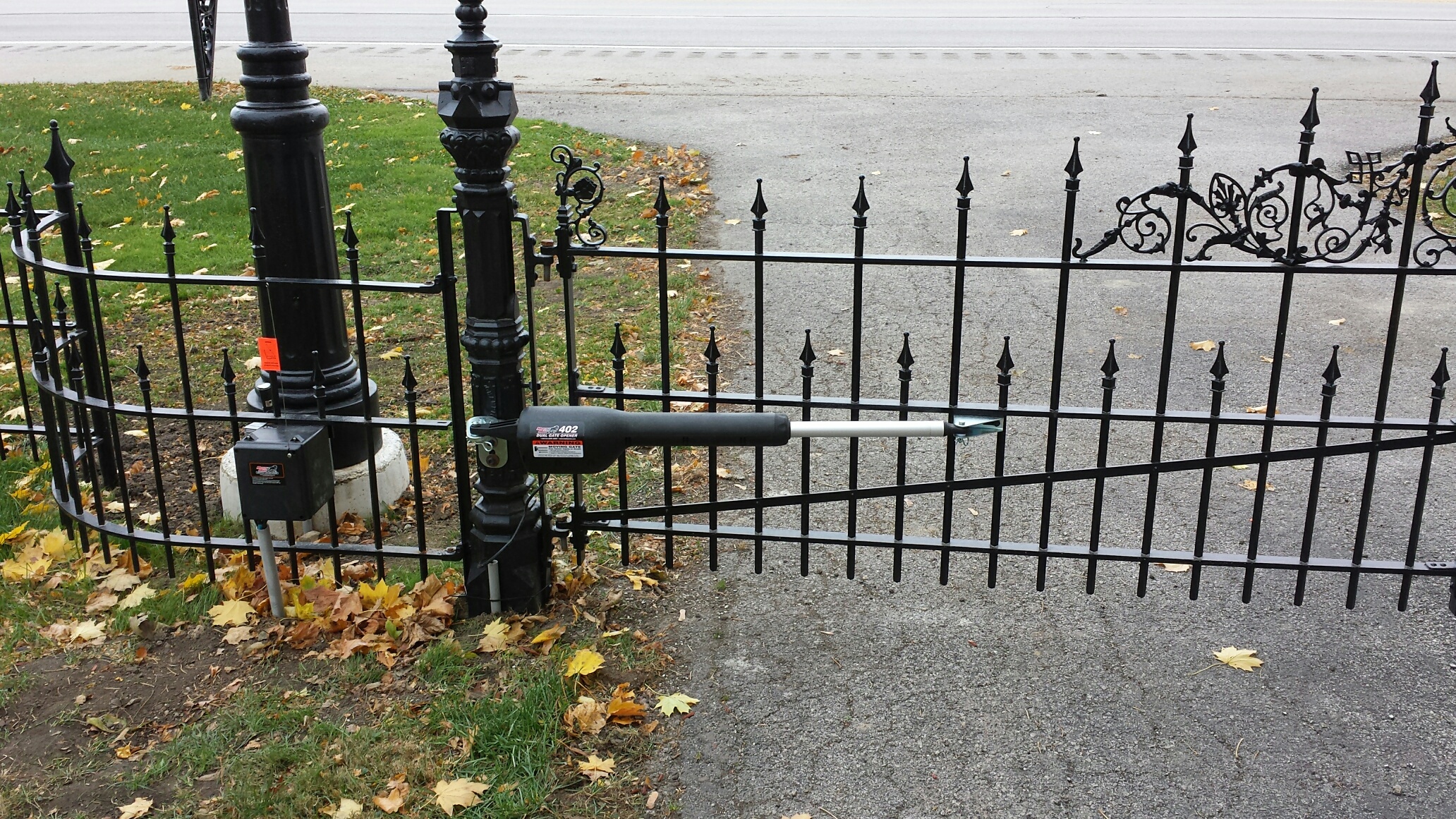

Thought I would try to post a photo or two the problem gate; 20161120_111839_resized.jpg20161120_111855_resized.jpg Well I'm not sure that was what I was tying to do. But then again, maybe it was.
