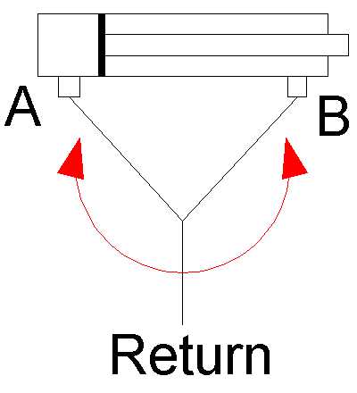

I'm pretty sure my return is at the lower side of the tank, not the top, to avoid foaming, but I'd have to do a visual inspection the next time I am out in the garage.
And yes, I agree that the two sides cannot contain the same volume of fluid due to the space taken up by the rod on one side of the piston. That's why the push is stronger than the pull on a hydraulic cylinder. The surface area of the piston is less for the side that the rod attaches to.
   / Question about "float" position #22
To all.
When a float circuit is activated, it connects the ports of the hydraulic cylinder together, allowing it to retract under the weight of the boom or arm. The fluid displaced from the piston side of the cylinder is directed with priority to the rod side , before any excess volume is returned to the hydraulic reservoir. An orfice controls the speed with which the hydraulic cylinder retracts.
   / Question about "float" position #23
There is fluid on both sides of the piston at all times. You can not afford to be sucking air into a hydraulic circuit, because you run the risk of the diesel effect, which is, if enough air/oxygen gets in the cylinder, and then it is compressed, it can explode, and destroy the cyliinder.

Yes, I agree with this rationale -- maybe. Consider fluid being returned to the tank with entrained air. Wouldnt it be better to introduce this return gently, over a broad area, near the surface to both prevent jetting air into the oil and introducing incidental entrained air too close to the suction pickup?
Conjecture.
Larry
