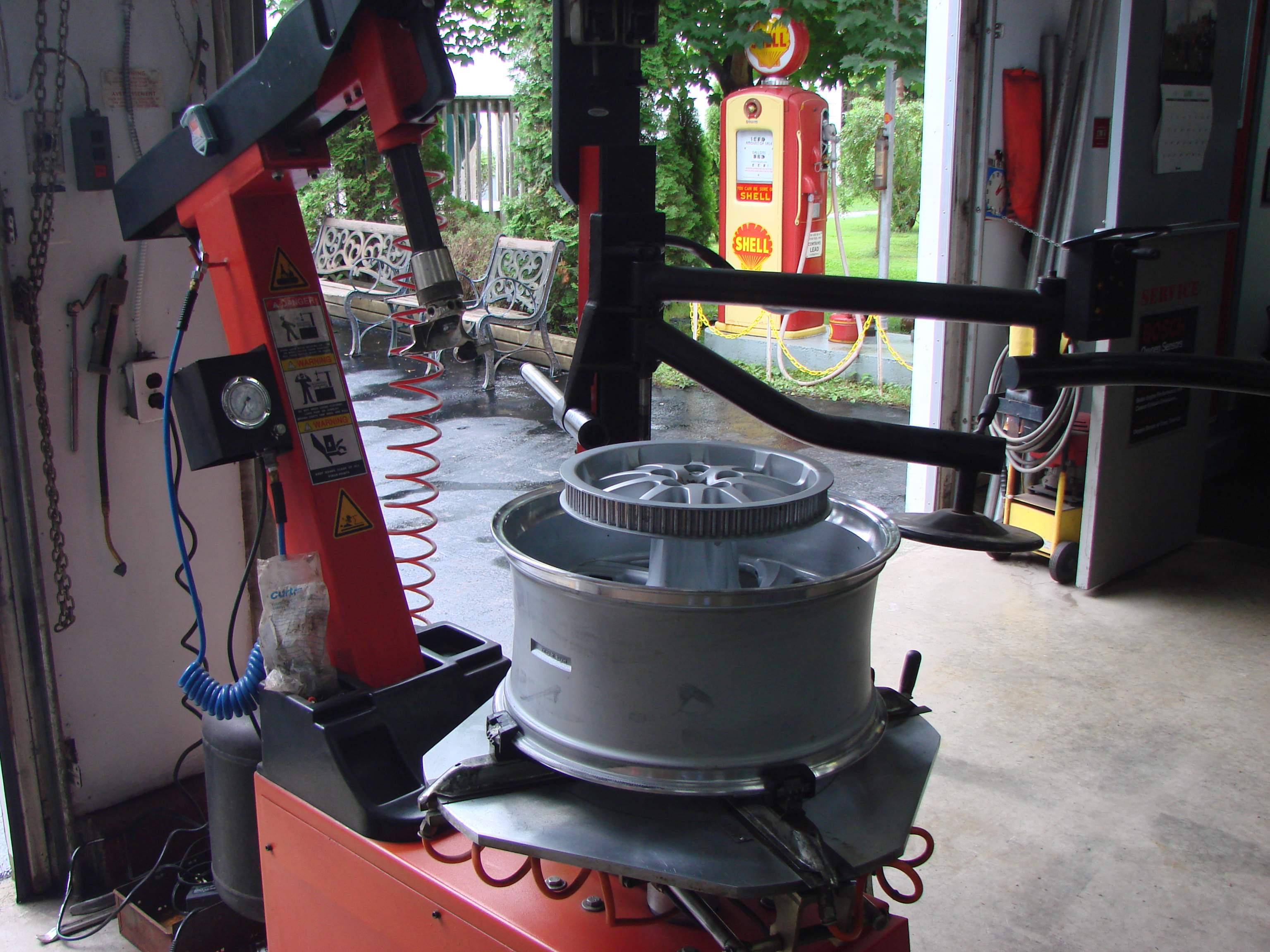

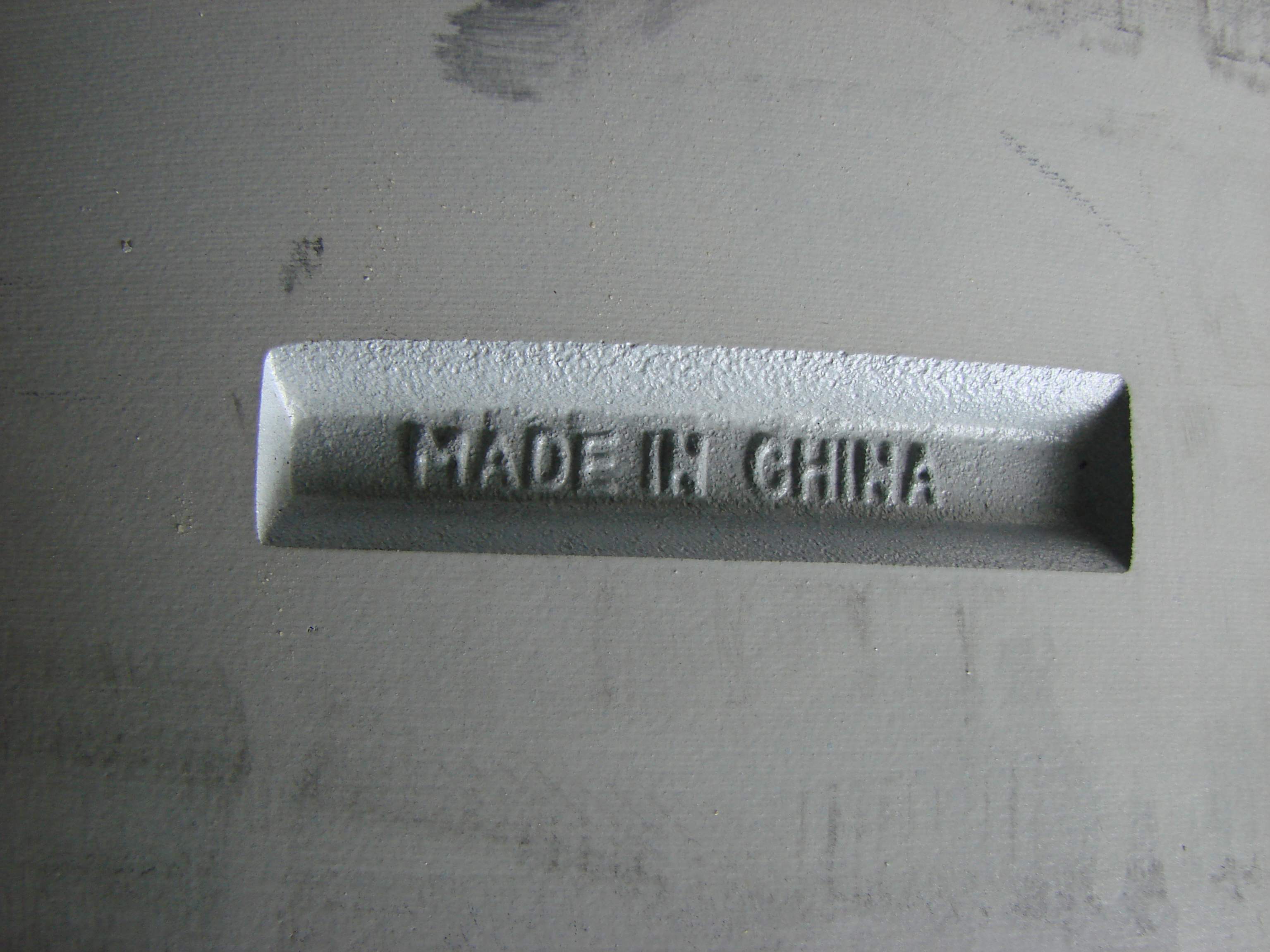

just the other day I was working on a "American" made Victory motorcycle. I pulled the rear wheel off and noticed something. Yes, the rim was made in China and I'll add it was a very well built rim.
