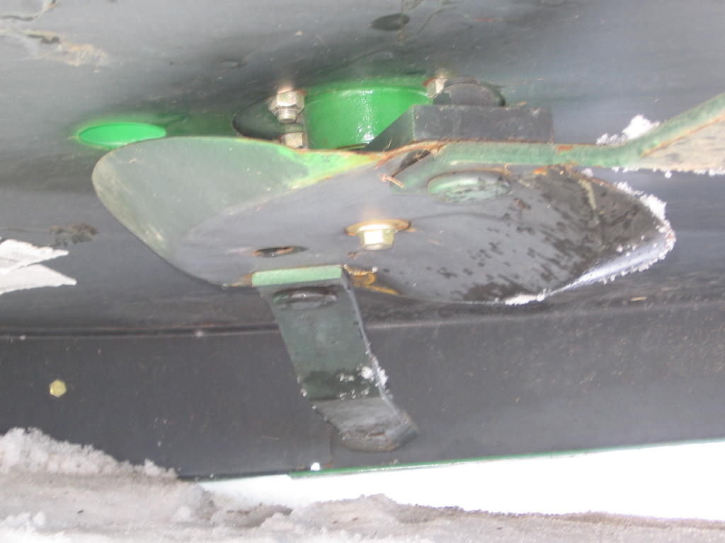

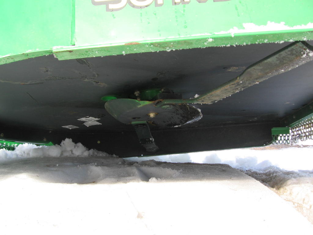

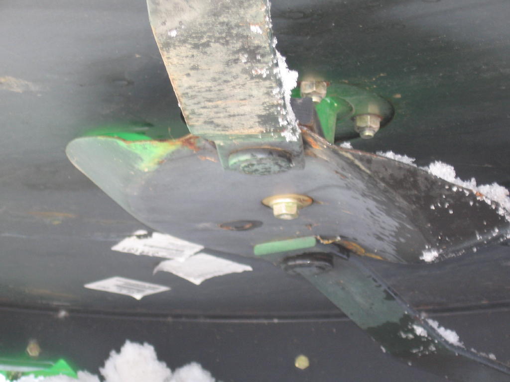

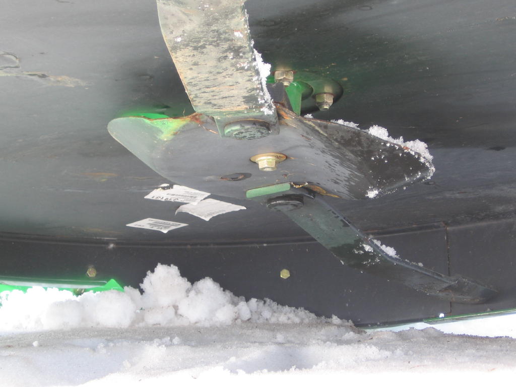

Just got my 5105 delivered yesterday, with some goodies including an LX6. When we were lowering the LX6 off the tractor, I noticed that the blade pan (stumpjumper) on it had one side distinctly lower than the other, almost like it had been bent. I asked the salesman, who looked at it and told me he didn't know if that was normal or not. Can anyone else with an LX6 tell me if the blade pan is symmetrical when viewed from the side or has one side noticeably lower than the other? If this isn't normal I'll be asking for a new blade pan or a replacement LX6.

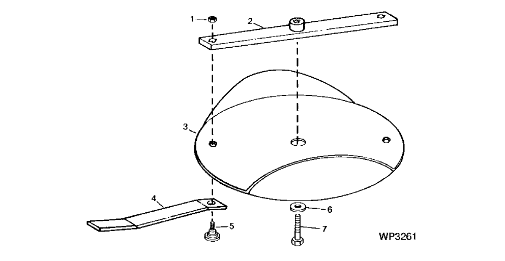

My bad... I knew they had discontinued the LX series last year. I also knew that the replacement light-duty cutters would be Frontier branded. Unfortunately, I assumed that they were the same, which in fact, as you already know, they are not... As I no longer have any Deere LX cutters on my lot, I have uploaded the line drawing from the Parts Catalog - hopefully it helps... Let me know if there is anything else I can do - and I will try not to assume anything this time... :confused:

I appreciate the post but the drawing is too basic to really tell if mine is normal or not. I'm trying to attach some photos I took today - everyone, please look at your LX cutters and let me know if this looks normal or not! I don't see any damage on the pan indicating that it was bent in handling, but it is definitely asymmetrical.

Looked at pic's time to call dealer and have them install a new pan. It should look like the green side of the pan on both sides. As I stated earlier the blade should spin 360 degrees on the blade mounting bolts. I see in one of the pic's, it looks like there is metal shaving off the pan by the one blade. It shouldn't take them more than 10 to15 min's to replace. hope this helps.

Sorry, I've been meaning to get out and take some pics of my LX6 for you, but just haven't had the opportunity yet. Still, I can tell from your pics that is NOT how the pan is supposed to look. Well, at least it's not how mine looks.

Put some pics of the pan HERE. Hope they help. If you need others, let me know.
/ Question about LX6
#15
Wow, those pics make it really clearer. It's almost laughable how bad my bladepan is bent. I'll be calling for a replacement today or tomorrow. Good thing mowing season is still a month away!
