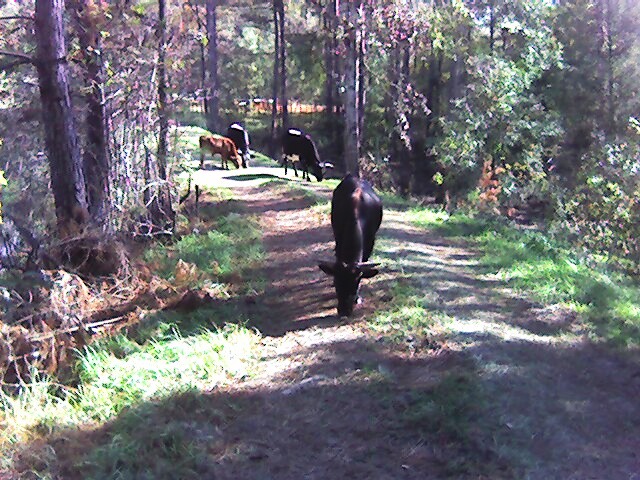

Alan, I have a dam on my farm property that we drive across on a daily basis, and it too has several large trees on both sides of it. Before I purchased the property, I had a friend who inspects dams in for the State of Florida come and check it out. He mentioned that trees are a typical no-no if you are building a new dam;however he suggested I not do anything with the trees unless one was to come down then deal with it and not replace it. Pic attached. In Goodlettesville,Tennesee my son's church owned the deed to a small dam in the area (long story) The authorities made the church responsible for the dam's maintenace and they were forced to pay a high fee for local officials to come out and "inspect" the dam on yearly basis. Ican't remember if it was each year or every 2 or 5 years or what, but I doi know the church could not afford it. I would check with your local extension office before I did anything.
