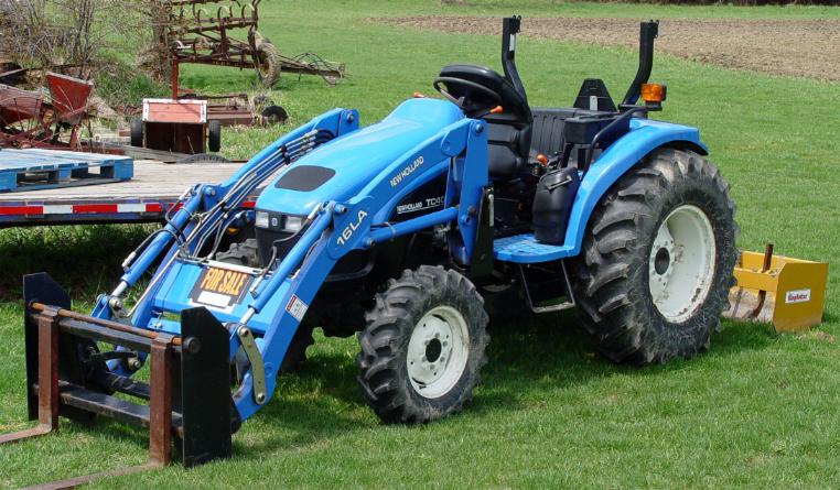

It is a standard TC40 with the adjustable sway bars, extendable ends and adjustable right lift arm. I popped the hood and there are no signs of any issues with the battery. It has the standard, non tilting steering column which makes no difference to me and the actual hours are 276. There is a small dent in the front grill that you only notice if you are trying to figure out how to open those little hoods. Nice of NH to hide the hood release under the tractor. The larger tractors have the release built into the front grill making it easy to get at but I guess it is one of those things that people get use to. Here is a pic of the tractor, the box blade is a King Kutter.
