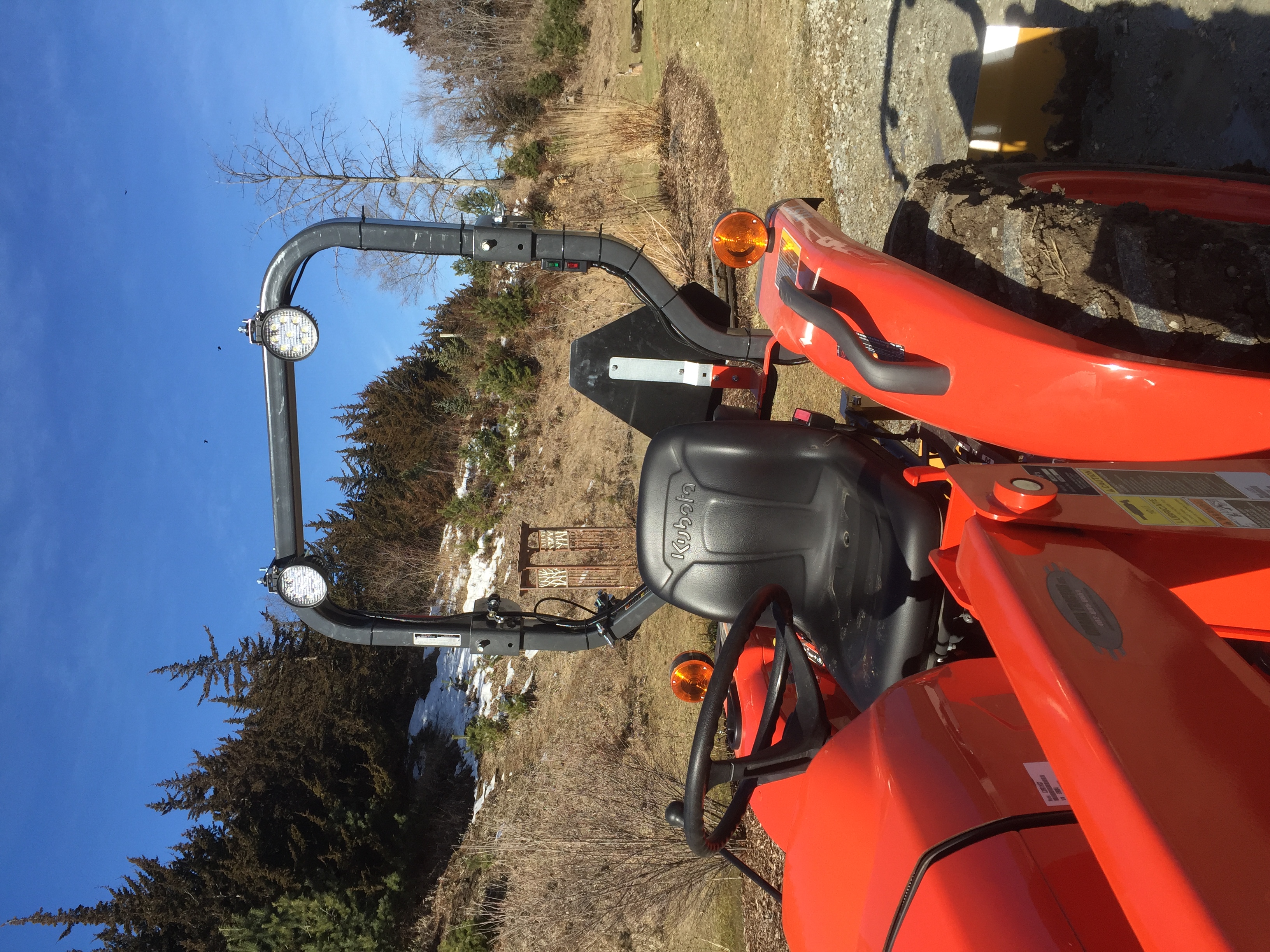

Just switched to an 8", 36W light bar with magnets so I can reverse it if necessary. This is the 18W.
