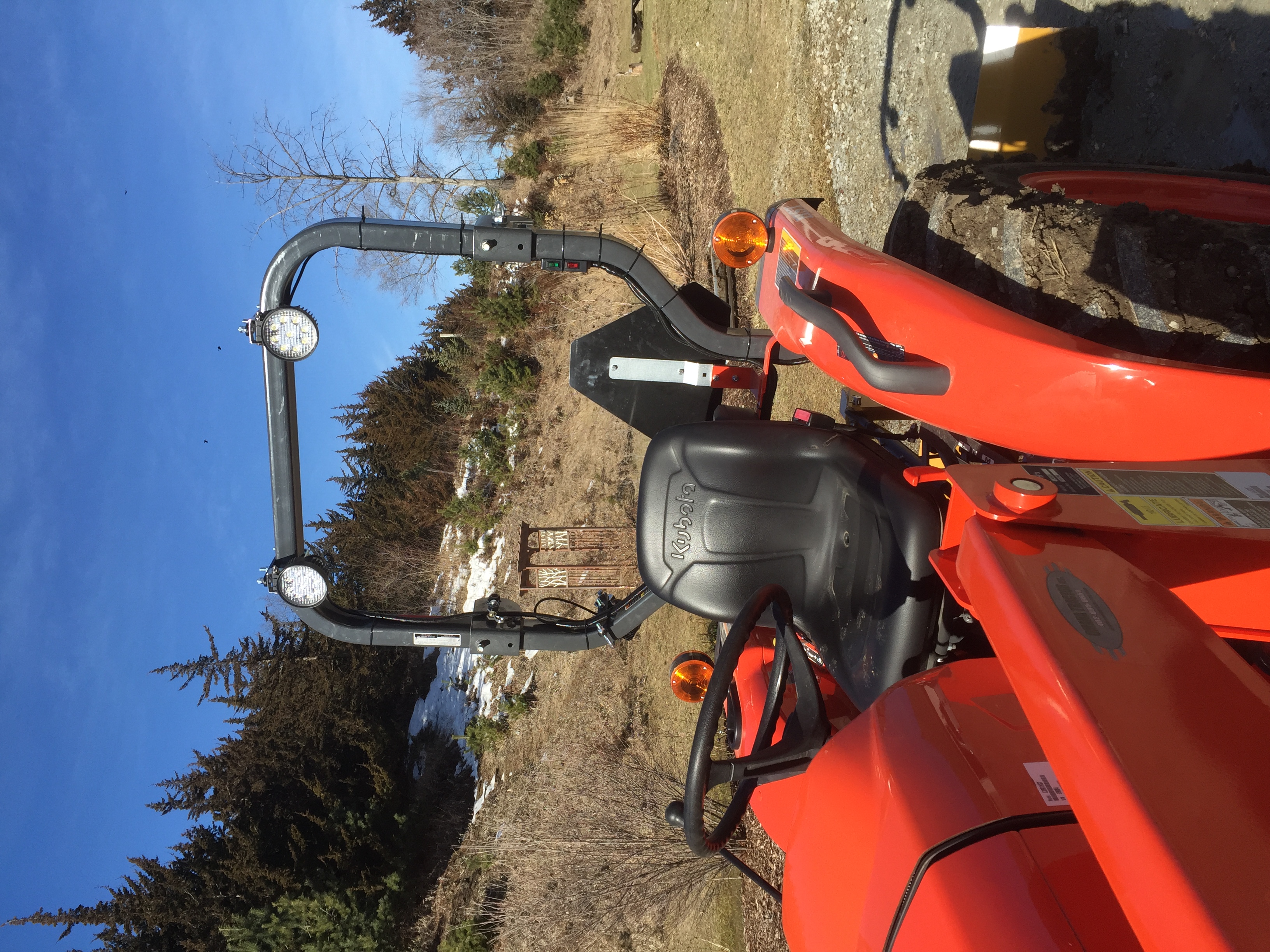

Mission accomplished. Ran the front light bar direct from the battery to a 30 amp fuse and then to a switch. Ran the two small back LED's off the back work light connection and to the switch.
Pretty happy with the results, wish I made my wiring a little cleaner around the switch box but I can still fix that.
I also cut the extra length of the U bolts off.

Here is a picture of the two LED's on top...one mounted facing rear work area. Switch is over my left shoulder as I drive tractor. Switch has 2 on/off for forward facing and rear facing lights. Tractor lights.JPG
