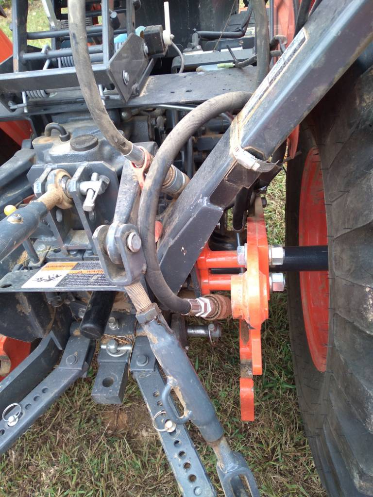

I can use the third function valve and backhoe at the same time. I just have to make sure that I don't hook the backhoe up first. Both the backhoe and third function valve have hoses that hookup after the steel fittings going to the backhoe loop. Some day when have plenty of time I will try to figure something out after the steel fittings.
Randy
   / Question about third function valve #29
I have not found a backhoe install manual for your tractor/backhoe combination, but I did find a Youtube video of it. I now have more insight into the problems with this install. The backhoe install replaces the Item 46 hose with two rearward going hard lines. The P1 end terminates in a QD, the T1 end terminates in a rubber line with the opposite *** QD. When the hoe is not installed, the two hoses are connected to keep the hydraulic loop intact.
This statement gives me hope the 3rd function is plumbed before the backhoe. I would like to see pictures from the rear with the 3rd function hoses plugged in though. I am guessing that they extended the 3rd function hoses to the rear and added matching QDs to the hoses. They could have precluded any connection errors by removing the backhoe QD from its hardline and connecting the 3rd function rubber hose P line directly to the hardline with an appropriate adapter (likely a NPT coupler, maybe NPT to JIC coupler) Please provide some pics.

Here is a picture of the back of the tractor. They plumbed the third function valve to use the quick couples and hoses that makeup the backhoe loop. I can leave the grapple connected to the side supplying pressure, then connect backhoe to the t side of the grapple and finish with the t side of the backhoe going to the tank. Not a real elegant solution, but it works. If I do that then I have FEL, grapple and backhoe all working.
I understand the hesitation to start cutting the metal lines while everything is under warranty.
   / Question about third function valve #31
Thank you for the picture. That should work perfectly and is how the logical flow from device to device should be done. If you want the 3rd function permanently in the loop, you could remove the lower set of QDs replacing with a properly threaded coupler as I previously mentioned.
For even more elegance, one could have a custom hose made with a banjo fitting on one end to supply fluid from the loader PB port to the 3erd function and skip a couple of connections, but what you have works.
I think we are done here.
   / Question about third function valve #32
Yup. If the T side of the grapple/3rd is what is supply the backhoe, and the backhoe returns back to the tank than it is plumbed correctly in terms of flow order
