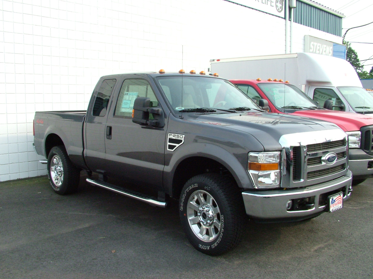

That is great to know seeing that I just took delivery of my new 08 Ford SD 250 with the tow package. I plan on using the truck to tow my Kubota B7800, FEL and Woods BH-70X ~ weight 4,000 pounds.
See the attached picture of the truck still on the dealer's lot :)

Just not on your truck - just kidding :D show us some pictures when you get it
It should be in the lower dash, with two buttons and a small display which probably wont light unless you push the buttons or have something hooked up the the rear pigtail
