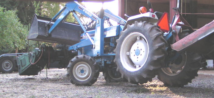

I flipped the front rims outward on my Ford a few months ago.
Then finally flipped the rears to their widest position.
I haven't noticed any steering changes.
This was before setting the wheels wider.
Undoubtedly fronts had hit the stops. If you look closely at the photo, the right wheel had too little pressure and flattened.
Anyway, the wider stance sure seems to help, especially when carrying equipment such as my drum mower.
I don't have axle spacers, but just the setting the wheels out by about 6" on each side does seem to have a dramatic impact. I don't know if I want them any wider, but I'll know as I do some mowing shortly.
