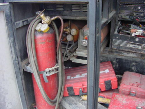

Acetylene is unstable under pressure. The bottle, when empty is not really empty or hollow. It is full of a pourous material, sort of like a rocky sponge. This keeps it from sloshing around in the tank. This sloshing can make it explode like nitro glyceryne. I was taught to never set the acetylene above 10 lbs. for this reason. Also never let your gas bottle get totally empty, because there is another chemical in there, I think it is tolulene, it will ruin a regulator.

You are correct, the porous material in the cylinder is to keep the material "stable", or not sloshing around. If the cylinders are used in the horizontal position you run a risk of getting liquid state material into you regulator and system, not desirable. If your cylinder is horizontal you should stand it up and give it a day or so to settle.
This has to do with the triple point of acetylene, which wants to be liquid at the pressure and temperature in the cylinder. When we let the pressure off the acetylene flashes to a gaseous state and can be drawn from the top of the cylinder.

A colorless, flammable liquid miscable with water and alcohols. Classic solvent for celluloid. Acetone is good for degreasing metal and glass parts before assembly into objects to be sealed under vacuum. A good leak detector, a little on a cotton swab will alter a vaccum gauge reading if it enters a leak. A temperature of -75 C or lower can be obtained by mixing dry ice with acetone. Acetone can absorb many times it's volume of acetelene, the common container for acetelene is a porous chamber saturated with acetone. This is why acetelene tanks should not be used on their side, because some of the liquid acetone might flow out!

Ahh.. It was the acetone that was helping to keep the acetylene in solution. I could not remember the whole bit. Thanks for reminding me, it has been a long time.

The interesting thing about acetylene tanks is that they were used on early automobiles. The "B" tank stood for Bus and the "MC" tank was for motorcycles. I know that the "B" tank was mounted on the running board in a horizontal position and the bottom of the tank had a gauge to show how much was left in the tank. I also know that the tanks should be used in the vertical position, so I have no idea why they were mounted horizontally on the cars...
