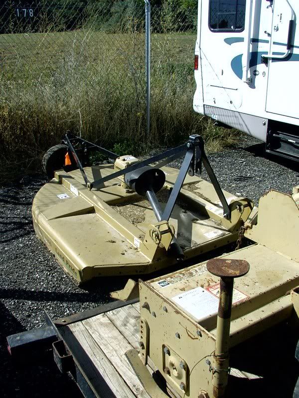

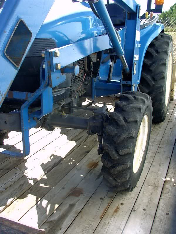

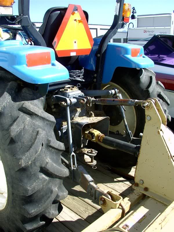

Thanks for the help. I don't know what was wrong with the clutch but do know the guy bought the tractor brand new. It is 700 miles from me and am planning on going to get it Friday. Here are a few pics.

it looks pretty good:thumbsup:. it looks more like newer TC series tractor that older vintage, although yours is pretty new. Land Pride implements are good and demand good price. if answers to the questions I asked previously were favorable then I think it is a pretty decent purchase, specially if you know the guy that you can trust and it is one owner. That was partially the case with my rig. Did the Land pride tiller come with it? that's a very good tiller indeed.

Tractor is in above averge cosmetic condition compared to other 1997 models-so it appears it was always kept indoors and maintained. If you buy it replace the rubber on the running board asap. That is an injury waiting to happen..slick as snot metal in the rain or ice.
