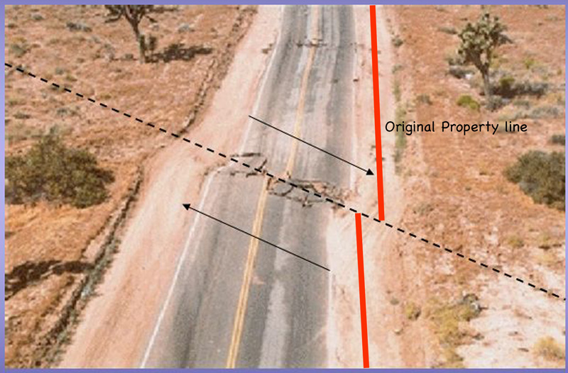

I live out in the Mojave (earthquake country) and I've always wondered what you own after the quake. About 25 years ago there was a 7.3 earthquake at Landers which is not too far from where I live. That quake resulted in a horizontal displacement of up to 18'. If your property was on the fault line and part of it moved 18', what do you own after the quake? Are your old property corners still good or do you now own 18' of your neighbors property?

I've read bot the "legal opinion" and the "technical opinion" and they both left me fuzzy. Per the attached image from the actual quake, after the quake what does a person actually "own"? If my neighbor had an outbuilding 10' from the P/L before the quake and the quake shifted it 18'. do I own his outbuilding as it's now on my property?

This is what I was trying to explain; the RED lines do not move (they are imaginary and contiguous) just because the earth under them shifts. You own the same amount of area, it's just the nature of the area you own is now different.
As for the shed moving that distance (without collapsing), you could conceivably just retrieve your property and move it back to its original position EVEN THOUGH the dirt is was sitting on has now moved to the neighbor's land.

Pretty sure that the best answer you're going to get here is "it's fuzzy" and "the courts will have to decide".
That's pretty much what the law I quoted says.
Once again:
[if] lands are in a location different from that at which they were located prior to the disaster, an action in rem may be brought to equitably reestablish boundaries and to quiet title to land within the boundaries so reestablished​
In English, "if the land moves, you may ask the court to figure out where the proper boundaries are now".
In the pic shown, though, typically the lot line will be in the middle of the road, or some offset from the middle of the road, so the end result will probably be that the lot line has a jag in it.
