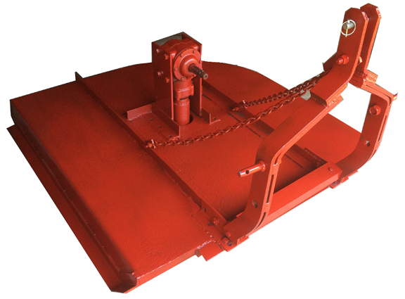

I have a old bush hog that is equipped with chain support instead of rigid brackets. My usage for this equipment is rare and the working range is limited to feet instead of miles. I removed the tail wheels because is easier to maneuver for an occasional small clearing in the woods.
My question is, would be better have rigid brackets or chains? I realize that chains would allow to follow an uneven ground but I am not so sure that it would be better for my situation especially with the tail wheels out.
What you think?
   / Question for the Bush hoggers #2
With no tail wheel(s), theoretically, it won't matter because the tail wheel(s) are the only thing that touches the ground. No ground contact= no flexing with a chain attachment and no stress on a rigid one.
   / Question for the Bush hoggers #3
...would be better have rigid brackets or chains?...
Either one is fine... as for "Rigid Brackets", they are not really rigid... they do allow free play in the system. The toplink will pivot around allowing movement.

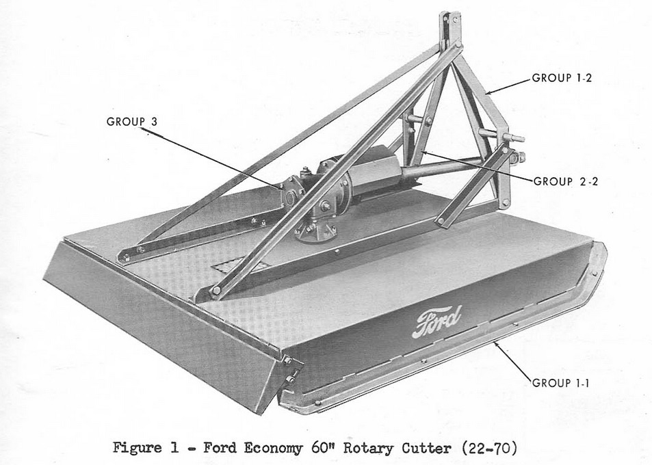

   / Question for the Bush hoggers #10
These skids I mentioned were meant to be the only support. There was no provision for a tailwheel, and the skids were taller (lower?) and wider than the skids on a regular cutter.
There was a lot of homemade equipment on small farms in the 40's and 50's after welders became common. Those I saw may have been homemade.
Cutters were often tongue-pulled as 3pt hitches were rare. They had two wheels on the side or rear.
Here's the first image I found.
