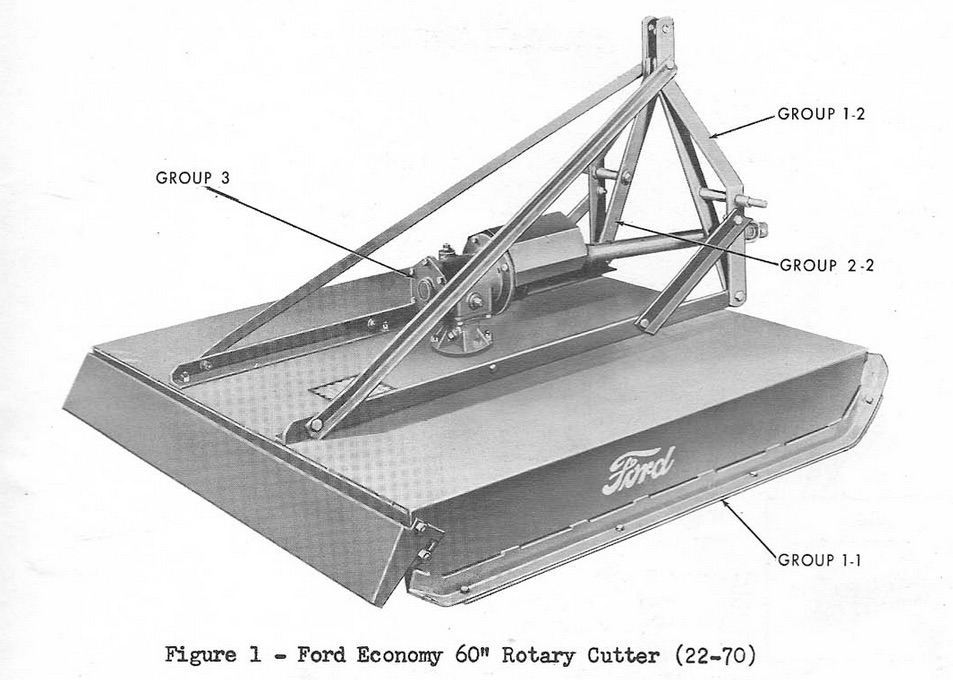

These skids I mentioned were meant to be the only support. There was no provision for a tailwheel, and the skids were taller (lower?) and wider than the skids on a regular cutter.
There was a lot of homemade equipment on small farms in the 40's and 50's after welders became common. Those I saw may have been homemade.
Cutters were often tongue-pulled as 3pt hitches were rare. They had two wheels on the side or rear.
Here's the first image I found.
Bruce
I stand corrected. I had not seen one like this.
   / Question for the Bush hoggers #12
1952 Ford mower as pictured. Has a triangle on the back supporting a tail wheel. The back flap was removed for better discharge. It was not used in town after the flap removal because of rock tossing.

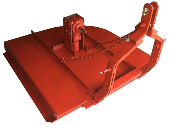

Thank you all for the sensible comments. Now I have enough to digest.
In another topic, this my vintage and probably modified machine. Even though I may not use this equipment frequently, I just painted it because I hate rusty brown.
I have no idea what brand this machine is. Not that makes too much difference, but out of curiosity, does anyone recognize the brand?
   / Question for the Bush hoggers #14
That's an odd critter, never seen one with the gearbox up so high. Does the red vertical tube turn or is there a shaft inside of it? What supports the blades?
The ones I've used typically mount the blade holder directly to the gearbox output shaft hence the questions.
Also make sure you're running a slip clutch with a splined gearbox input.

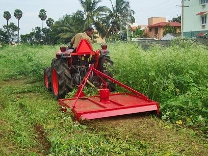

Having no tail wheels is a common design in other countries.
The shaft runs inside. I am not sure what support the blades, all I know the blades are attached to the dish which is attached to the shaft. Yes there is a slip clutch to the gear box input. This machine has evidence of farmarization, but it is a solid working machine, for my purpose anyway.
BTW for the sake of clarity, I do not do field work. Occasionally I clear a small vegetation area and the tail wheels would just get in the way.
P.S. Actually looking again at the design, I like the high gear box. While operating, it keeps the drive shaft parallel with the tractor PTO shaft (less stress, I think). I limit the 3PT lift to a small amount.
