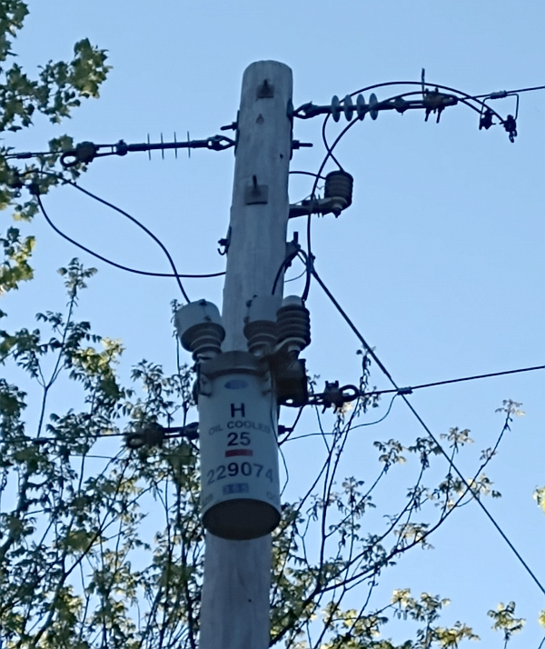

This is at the end of my road where it Tees off the main state road. The main power circuit runs along the highway. This branch travels about 4 miles serving around 20 houses, then dead ends.
The transformer is less than half the size of the one for the residential service drops.
Note what the two read arrows point to. Is the one hanging on the pole some kind of shunt or lockout they would insert above if they need to turn power off to the road for some reason?

That is a fusible link or "trap". When it is installed the line is hot when it is out the line is de-energized. It serves as a protection for lightning & as a safe way to kill power down the line for service.

The line on the left is the source. On the right is the load tap.
The can is a breaker, or recloser, more commonly.
The red arrows point to a fuse holder and its fusible link.
The fuse assembly is for repair or replacement of the breaker.
A bypass, in layman's terms.

It's a single phase re-closer not a transformer, it will trip and reclose twice before locking out if the fault on the line doesn't clear itself, the other thing is a fused cutout that would be used as a by-pass switch in case the recloser needs to be changed out, the door with a fuse inside of it is hanging on the pole, pretty common rural set-up. Are you served by a co-op?, looks like co-op specs.

Cool. Makes sense. We got a lot of outages 20-25 years ago where a tree would drop during a storm and touch while it was wet. Then it would be out until a crew came out to inspect and reset. Maybe this is an answer to that. I've seen it drop for a few seconds, then come right back on in more recent years.
