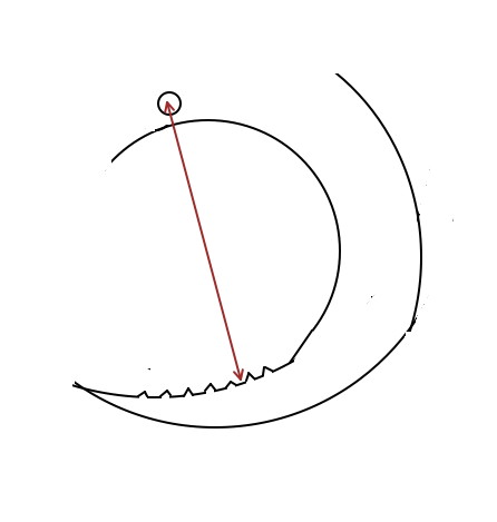

Has anyone designed a tooth whose front sawtoothed curve is close to a constant radius from the pivot pin? This would allow a sawing motion by curling and uncurling the tooth, for roots too large for smaller backhoes to break.

A quick drawing. The red line represents a constant measurement from the toothed section to the pivot hole, so curling the blade saws instead of pulls, on that section. The rear would be sharpened for conventional pull cutting.

I see now. That's a pretty racial curve which might make it difficult to position up under the root. I was thinking of just a sharp blade bolted to the tooth I have that I can slip up under the root then curl and lift to cut through. I have plenty of curl since it wraps all the way back under. I'm still weighing the value of teeth vs a simple sharp edge or something like a shark's tooth maybe. It usually pays to look to nature for engineering solutions.

As a professional woodworker for 40 years, I've learned a couple of things about cutting wood. First, a saw-toothed ripper that has pointed, triangular teeth, is never going to cut wood efficiently, and a backhoe is not designed for reciprocal action. If you take a look at a saw blade, circular, hand or otherwise, you will see that the teeth are flat-tipped and act like small chisels, each taking a tiny shaving of wood. Sharpening a ripper tooth with the geometry most commonly found, similar to a steak knife, will cut steak, but not wood. Try it out, take the sharpest steak knife you have and try to cut a 1/2" dowel. Not going to happen. It won't help much to grind a ripper blade to the geometry of a saw blade, as even saw blades cut poorly when dull, and nothing dulls a sharp blade faster than dirt & rocks. You will spend more time sharpening than getting any work done. I was strongly considering a ripper blade when I first got the BX. I have loads and loads of tree stumps to remove for several projects I want to undertake. After some practice and a few tips found here, I've come to the conclusion it would be a waste of money for me. The 12" bucket on the BX BH works fine if you learn how to use it for this purpose. Dig away from the stump where the roots are smaller, take small bites, digging deeper and closer as you go, breaking roots. Dig on all sides of the stump. The stump is going to loose. I've never had a stump beat me and i've taken out some monsters with my little BX. With a bucket I can break roots that are 2 feet or more deep. Plus get rid of big rocks that are locking the root ball in place. Not so easy to do with a ripper blade without switching back and forth a lot.
