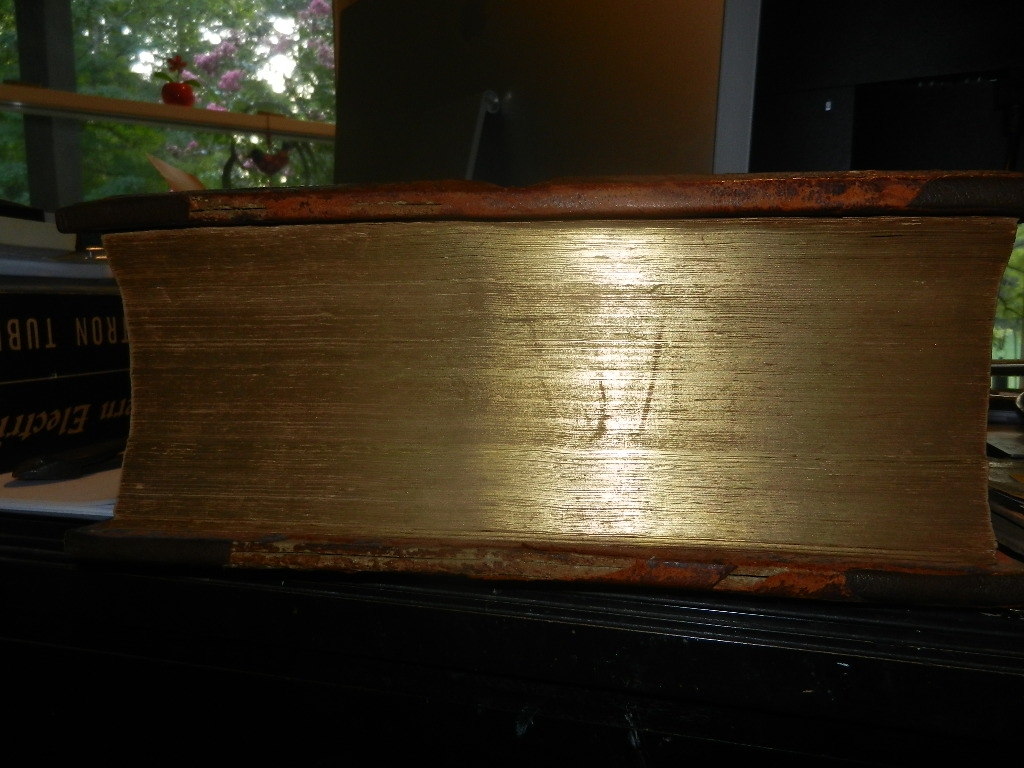

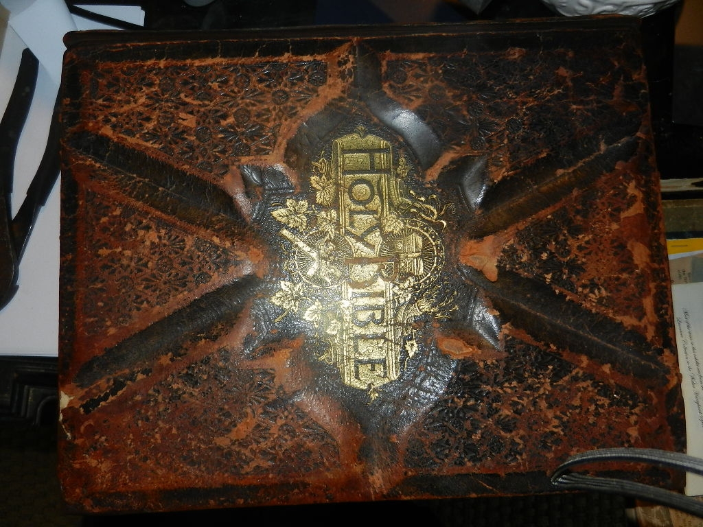

What I'm wondring are wood types. Basically a flat/base portion and a removable box with the clear top (think like a cake plate)
I can do the cuts. What I really suck at is the artistry of what wood to use.
Oak? Walnut? How about Walnut for base, Maple for the box with the clear top?
Olive wood?
I've got a nice piece of Zebrawood
I fall flat on my face here. If someone said this & that would go well.... I can make it happen. I get stuck and indecisive when I go to the wood place and see 325 different sizes and types of wood.
Cherry?
So if you think two pieces, flat bottom and the removable sides (with the clear top on it), what wood might look classy, timeless (since this is a bible, it's got me thinking the olive wood)
100% one wood? (walnut base & sides?)
Split it? (Walnut base, zebrawood sides?)
Paralasis by analysis.... helppppppppppppppppppppppppppppppppp!!!

Piece of paper in there with 1888 written on it by Dad. Implication is he spoke to someone or otherwise ascertained or guessed that was year it was made, if so, it's 137 years old.

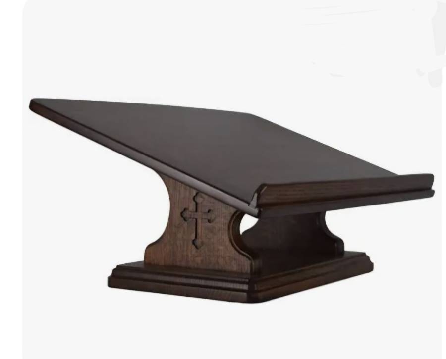

I'd be tempted to make a Bible pedestal like this, easy if you have a router. Then you could make an acrylic or glass top which would be just a cover to go over it. If Bible is 12"×14"×10" cover would be, say, 13"×15"×11"

Quick answer is I don't really know. This is a clean sheet of paper to design.
I envision an open book on a stand... I envision a grandchild or in time, great grandchild with chocolate melted on hands, curiously looking at that book....and creating a mess. The first (and to be hones, only) idea that ever came to me was the "cake plate" idea. Bible in an enclosed box, clear top. Therefore, it would HAVE to be removed to be viewed which I suppose, would mean more hand interaction than a fixed base.

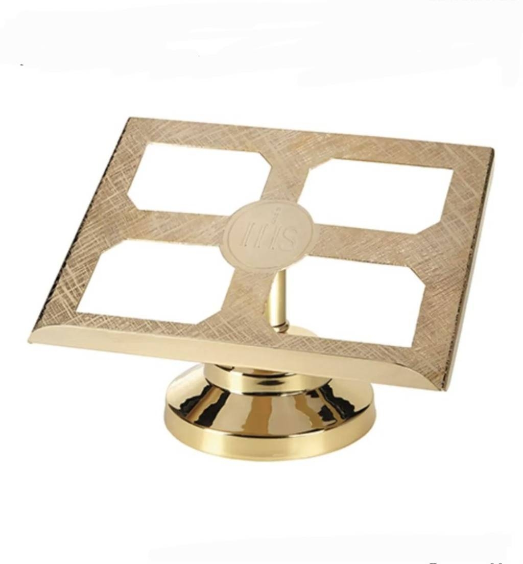

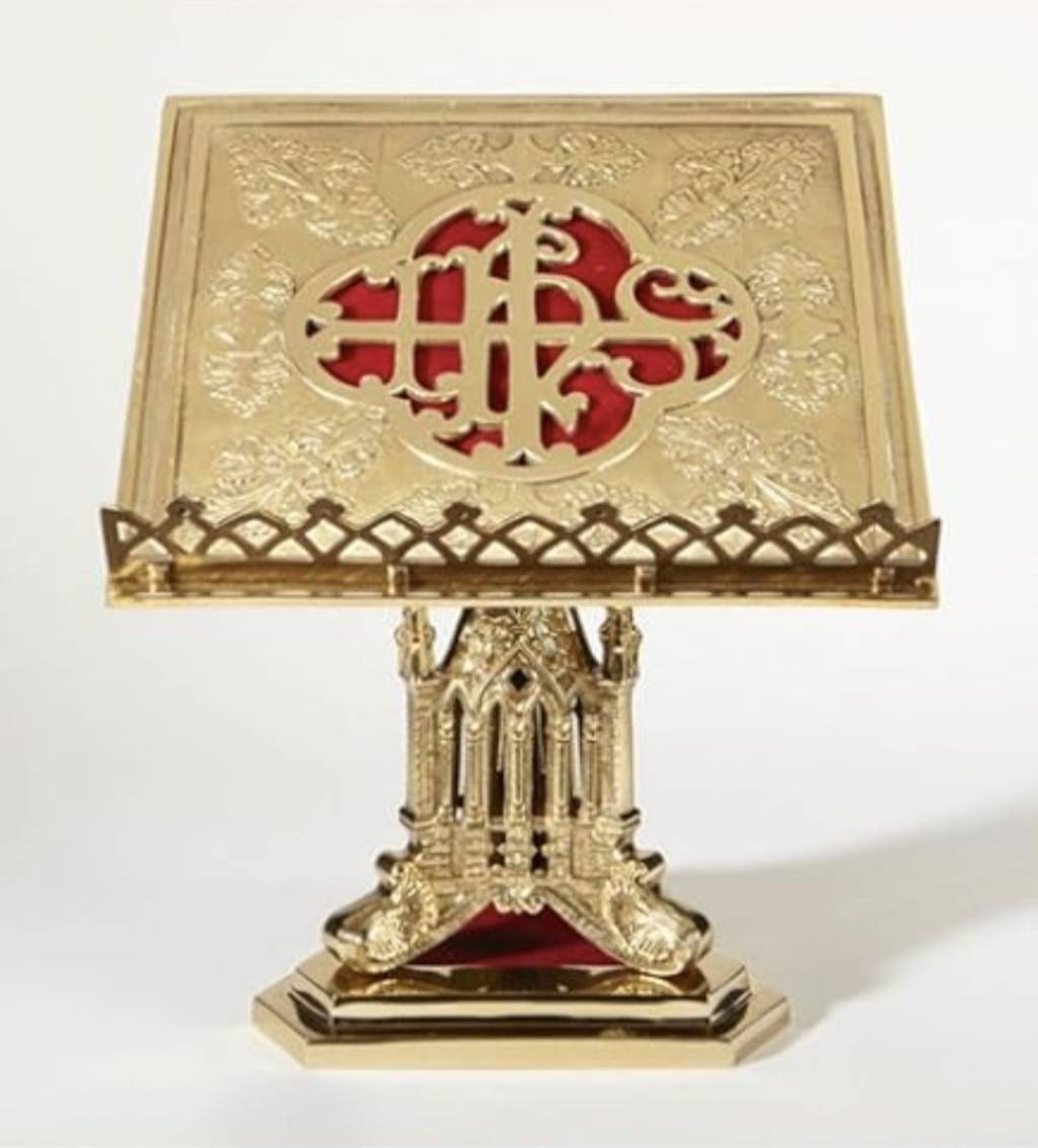

Lots of choices. There's a metal (brass) Basilica stand, from basic to ornate. The basic one could be fabricated easily with brass parts like a lamp base, the top if you know a metal fabricator or buy ready made.
Attached to a walnut wooded base, basically a box with drawer.
