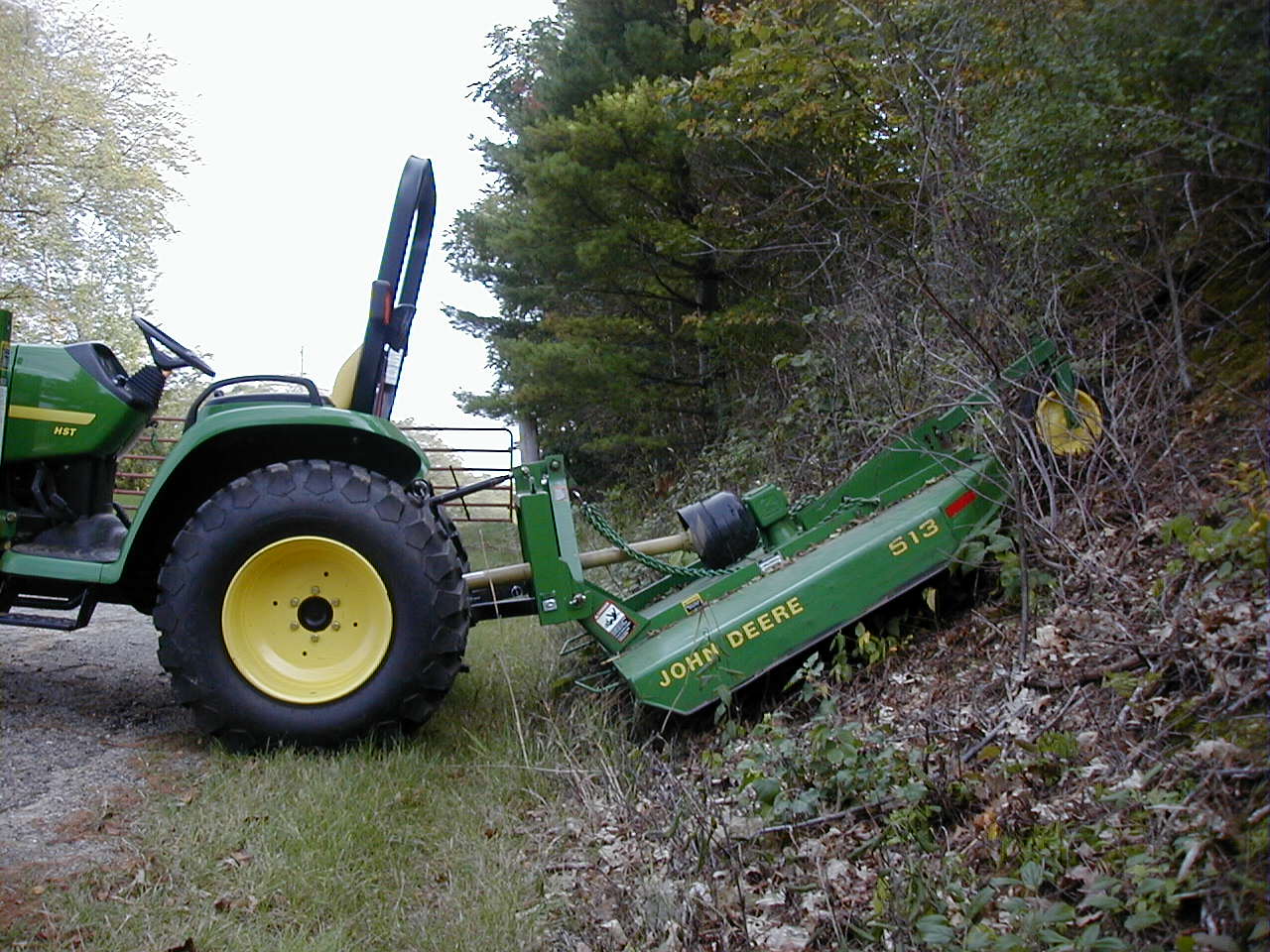

I got an I match hitch to make life easy with my bush hog, only to find out that the center hook allows the floating link on the Taylor way bush hog to roll out of the hook when it takes the weight. Would anyone here recommend welding that link so it can't move? Seems like the only way I will be able to lift the thing.---------- Suggestions please!!--------- I was sold on this Taylor way bush hog by my dealer because he said the JD 5 foot hog was more expensive and the Taylor way was a better implement
because of a slip clutch rather than a shear pin.

Looks like you will just have to re-make that top end to work with the iMatch. Believe me, it will be worth it.
I replaced the steel straps from that top end to the rear of the hog with chains. Then I take that bolt out and just use one of the short steel straps to connect to the top arm pin of the iMatch (have a long enough pin there so it fits nicely. A rigid configuration could be welded for it, but have to get off to connect the PTO shaft so it isn't any extra pain to fasten to that top pin.

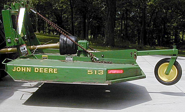

My Deere 513 rotary cutter is older model and not iMatch compatible.
The chains allow the deck to float (much more than the short floating link straps will allow).
The long support steel straps will bend without the floater links, as the deck will not lift the 3 ph arms when the rear wants to lift up. The chains go slack, and is why the chains are much better than the steel straps. (for extreme emphasis, posted this pic)
You can almost see one of the short floating straps attached to the top arm pin of the 3 ph. The top hook of the iMatch doesn't connect to anything on the 513 RC

I think what I am going to try is welding that link to the 15 inch height , but I'll change out the rigid straps to chains as in your case. It's the only way I can see to use the I match and still have the flexibility of a floating back. Thanks for the pic, it helped to clear things up in my mind.
I am still open for other ideas from anyone that have them.!!

Really no need to weld anything, just remove the swinging top link and replace with appropriate spacer for the top hook,if the distance is correct from the bottom pins to were the top link bolt is, then replace ridged supports with chain like you had in mind.
