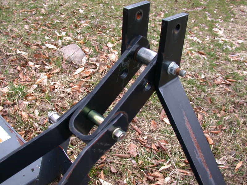

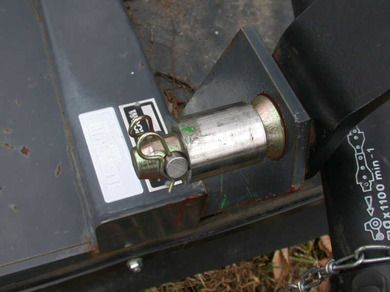

Hi Guys,
I machined stainless bushings to fit my Woods HC60. I didn't know about floating the hog (Nice job Beenthere!).
I used Woods set up and I have no problems, the distances were ok, there is some flexibilty in the arms but not like you get with chains.
Rob

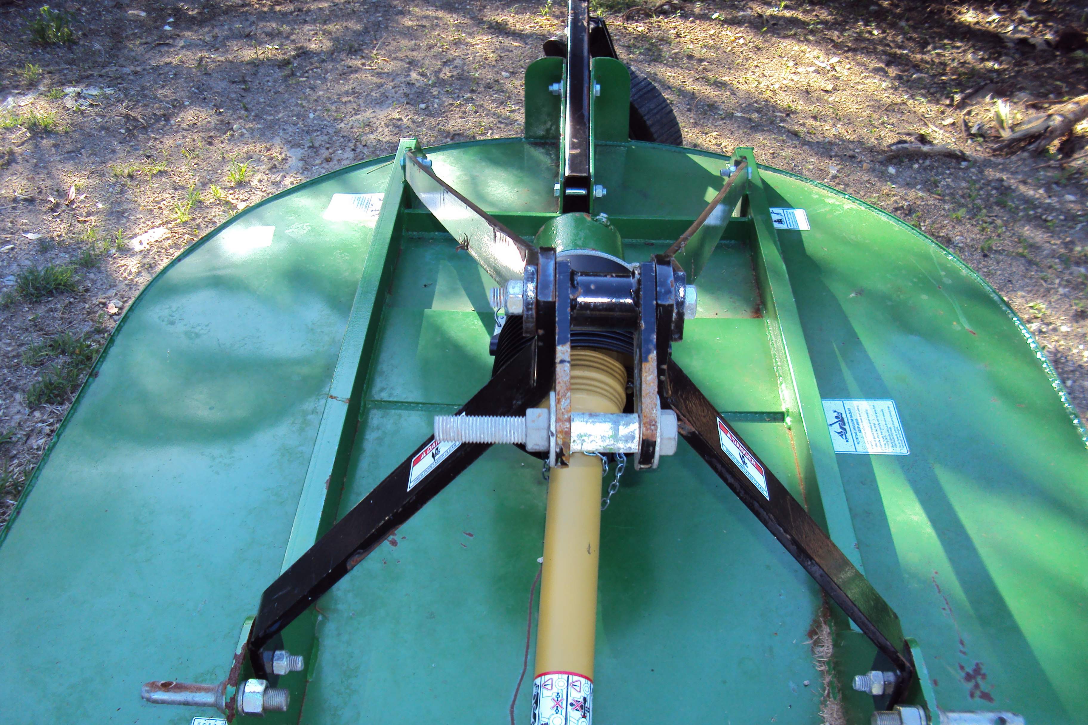

Here is what I have. I an trying my best not to have to weld that floating link and maybe if I drilled new holes in the deck bracket and lowered the top link to the required 15 inches it will not pop out of the i match center hook. It's worth a try.

Wooden,
What if you moved the the arms from the back to the front bushing where it attaches to the I match. Would that be the right height? Sort of like my third picture.

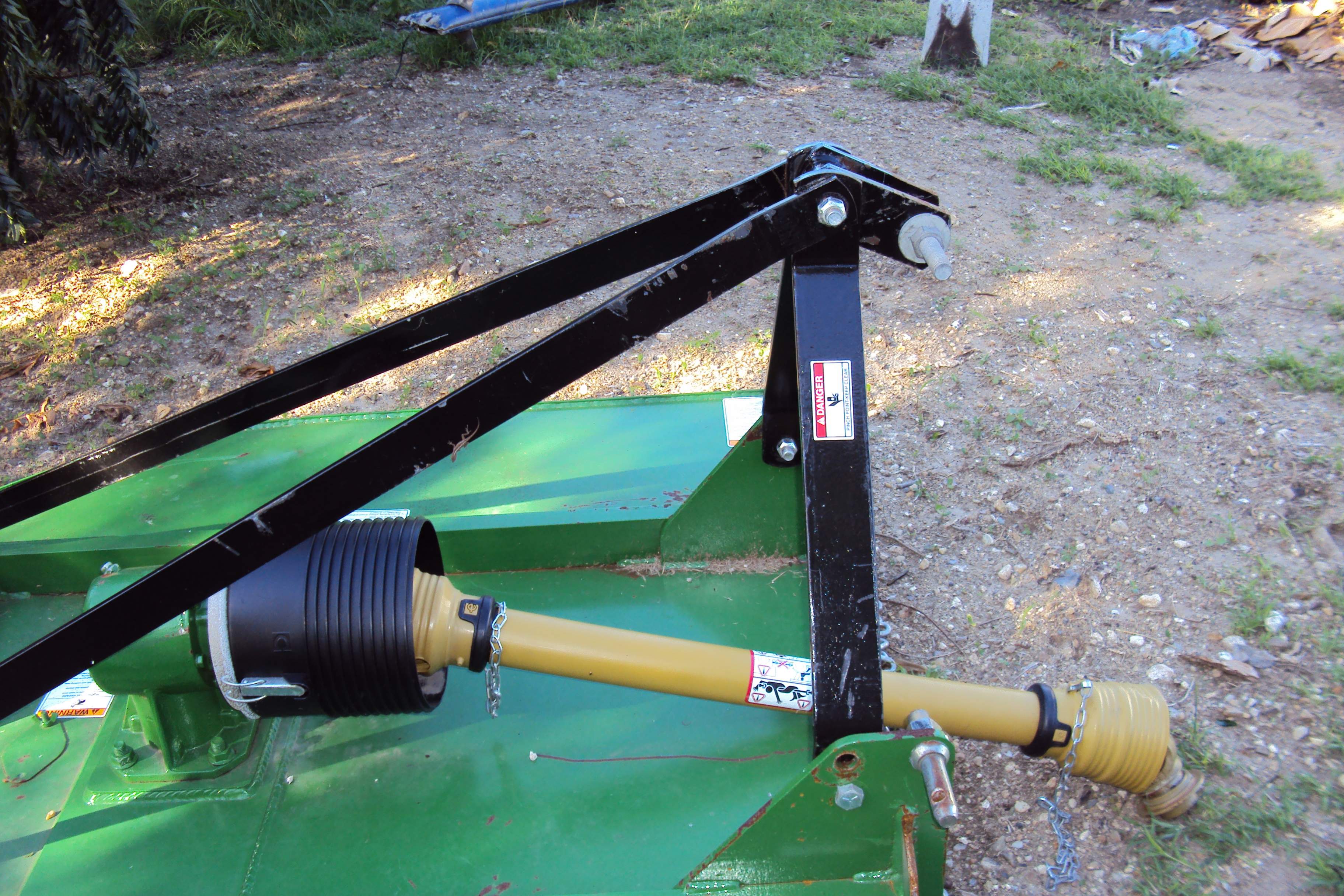

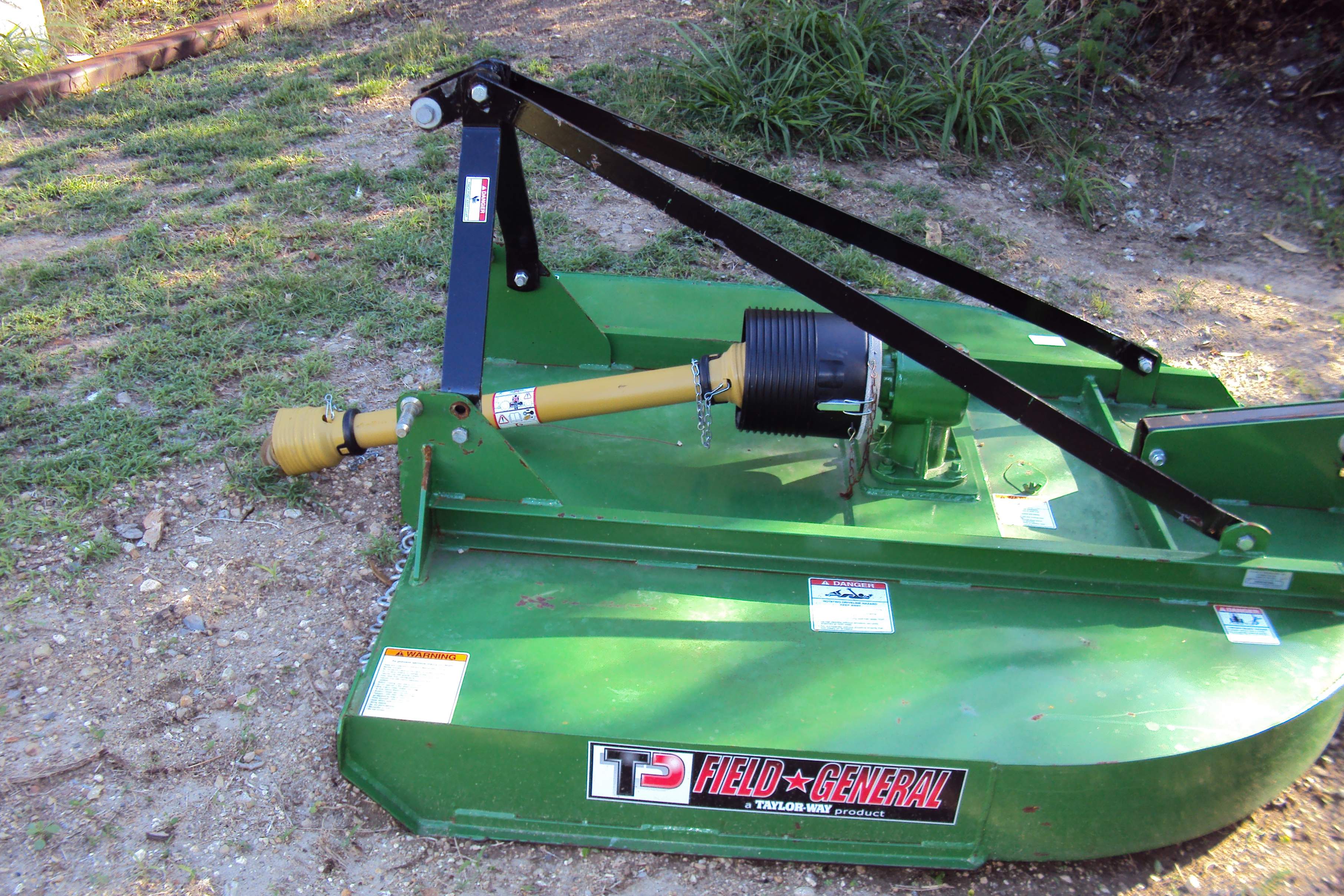

Here is what I have. I an trying my best not to have to weld that floating link and maybe if I drilled new holes in the deck bracket and lowered the top link to the required 15 inches, it will not pop out of the i match center hook. It's worth a try. You can see that the lower mounting bolts were lowered already by 1 5/16" which was not enough, so I will try putting the link in a horizontal position and measuring the distance from lower pins to the link, and setting new holes so that they are at 15" apart. Its the only choice I have at this point.
Less of course someone here comes up with a better idea!! I am wide open and learning!!

Do what you want, but Rob has a great solution.
If me, I'd toss the short floating link, and put the top hook of the QH right under that top RC pin/bushing. Then toss the steel straps to the rear and replace with chain.
I wouldn't try to trust the floating link to not pop out of the center hook.

Wooden,
Looking at your pictures, I would drill new holes in the gusset plates on your deck to lower the entire top link assembly. I would then unbolt the swivel sections, remove the two braces from the joint and retighten this connection. Next I would flip the short bars rear wards and bolt these too the rear braces with a nylock bolt nut and washers (needs to be loose enough to swivel). When you rebolt the bottom end use nylocks there too so the lower mounts can swivel.
When you do this assembly the top link with bushing should line up almost plumb with the lower lift pins.
All you need is about 4 nylock nuts and a bushing for materials and drill two new holes.
