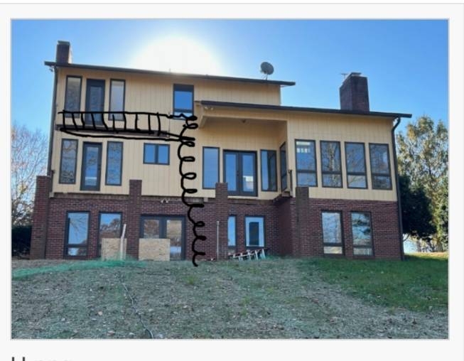

What's the view from 3rd floor? If it's nice it certainly wouldn't be that expensive for a small balcony I wouldn't think.
Sort of like this (as drawn by a slow 3 year old) .
Sort of like this (as drawn by a slow 3 year old) .View attachment 831696
That 3rd deck by the bedroom will still stay.

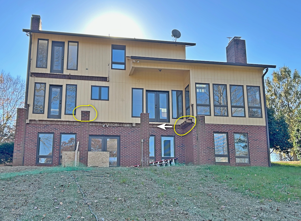

I know what you mean about a sprial stair case. Giving it more and more thought, my hesitation is growing just for this one application just as a cure all for access from that 3rd deck.
I do think the contractor was right in wanting to extend the 3rd deck to the left and widen the basement deck even more to the left, but budget constraints wouldn't allow that (added my wife didn't really want that one tree removed as I had mentioned).
So I have a better understanding of what your line of thinking is, see attached (pic I took when I just replaced wood on the deck 15 years ago and added those stairs). What I'm failing to envision is how you tie the the top roof line (red) to the second roof line (light blue).
The distance from the exterior wall from the bedroom to the end of the deck (yellow line) is roughly 12'. Are you talking about extending only a portion of the top roof (red line) out further, and how far? Or are you taking about extending the entire top roof out? (again,red line)
The purple line represents how the deck is going to width, but it's going to add about 6' in length away from the house to go out to the end of the deck (yellow line).
Like I said in the past, when it comes to woodworking and building /cutting with wood, I'm not the guy with the brains leading the work.
Also keep in mind, my wife actually likes that 3rd deck from the bedroom even though we don't really use it that much.

Unless I am mistaking what Eddie is saying, the purple lined deck could be rebuilt as a slightly sloped roof instead of being rebuilt as a flat deck area.
If you rebuilt it as a roof, then you'd likely want to eliminate the two windows and the door above it so it doesn't look odd, but install a window that could be opened for fire escape onto the deck/roof to climb down someway to the second floor deck to reach the stairs.
One advantage to keeping the third floor deck as a deck is it at least gives you a staging area to get any upstairs dogs out of the house in the event of a fire although I'm not sure how you'd get them off the third floor deck thereafter unless you were prepared in advance with a sling and rope system to lower them down.

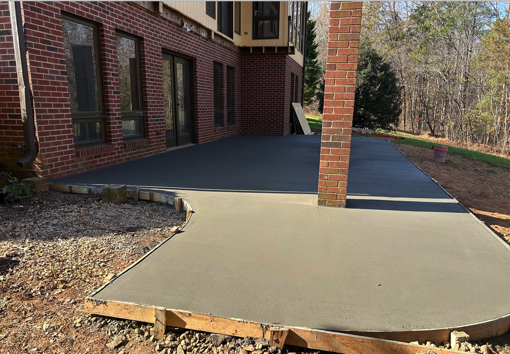

Anyhow - my suggestion. That ground level area. Do it with something that will be easily "dug up" if needed. Gravel or pavers. Let the future owners spend the big bucks if they want to make a change.
Your not using the area and likely it will not substantially increase the value - if you spend big bucks.
Day late and a dollar short ;)
After Eddies comment about cement and talking with the contractor who was doing the job, we did lay cement on the ground. In all honesty, like it very much and my wife agrees. As mentioned, this contractor was compeititve with the cement vs others quoting wood deck on the ground, so we're still on budget on what we were willing to pay (I got 6 quotes, not like I didn't try to get options, believe me).
