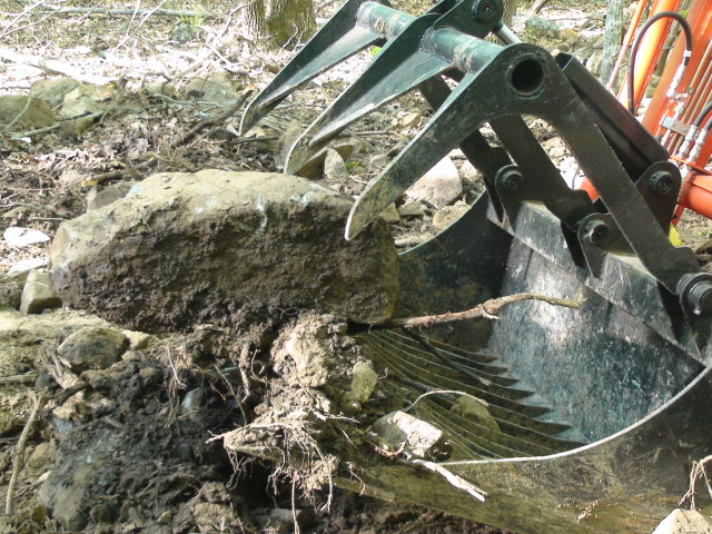

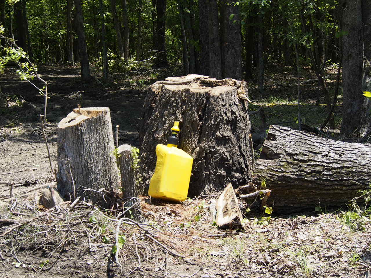

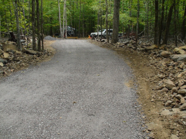

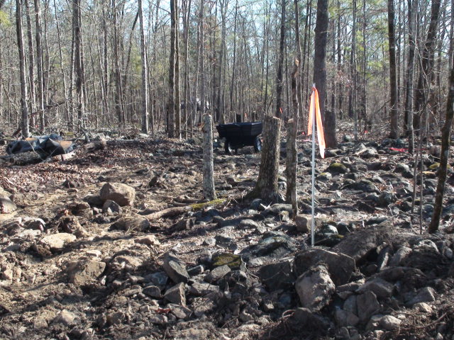

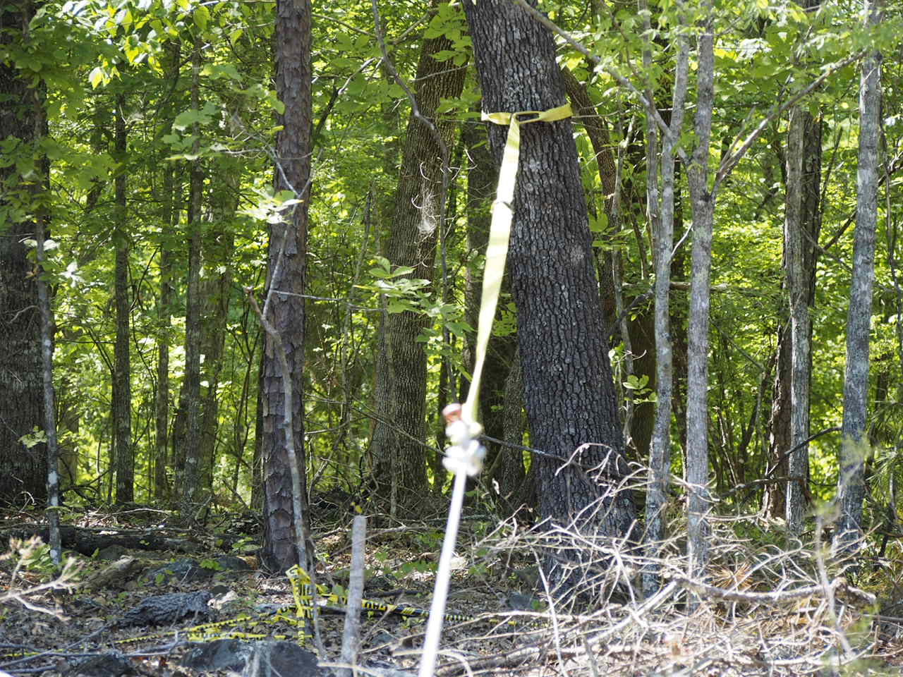

I recently finished clearing a smaller, similar tract on very rocky, dense clay soil. I have a HST DK45 and would not have wanted anything smaller. I hope yours is HST for this type of work, as all of the back and forth with a geared unit will be troublesome. I did not have a hoe and sure needed one a few times.
In the end I removed the stumps in the driveway by digging them out with a 48" grapple rock bucket and a stump bucket. Anything larger would have been less efficient. You will not have much maneuvering room for awhile and I never wanted for a wider bucket that would have decreased my maneuvering.
After getting the driveway cleared and covered with slag, I had more room to move around and access attachments stored in various areas of the property. I then just started cutting down the trees, then into manageable lengths and then moving to large storage piles. I would think a 48" grapple bucket would be more efficient, time wise, than a hoe with a thumb for moving things. I left my stumps ~ 3' tall to make removing easier. I ended up having a bulldozer come in and remove all of the stumps from the property. This was a very quick, time and money efficient way to finish up and it left my property with no holes and everything relatively smooth. This was a great decision for me. In hind site the bulldozer and no hoe worked out best for me and I would do it the same way again.

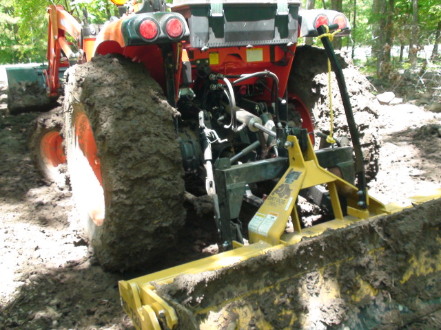

My box blade is 6' wide and 725 pounds. I needed a heavier ones many times and a lighter one would not have done the job and would have been a jumble of metal in short order.
Some before, during and after pics that did not attach in the same order I selected:

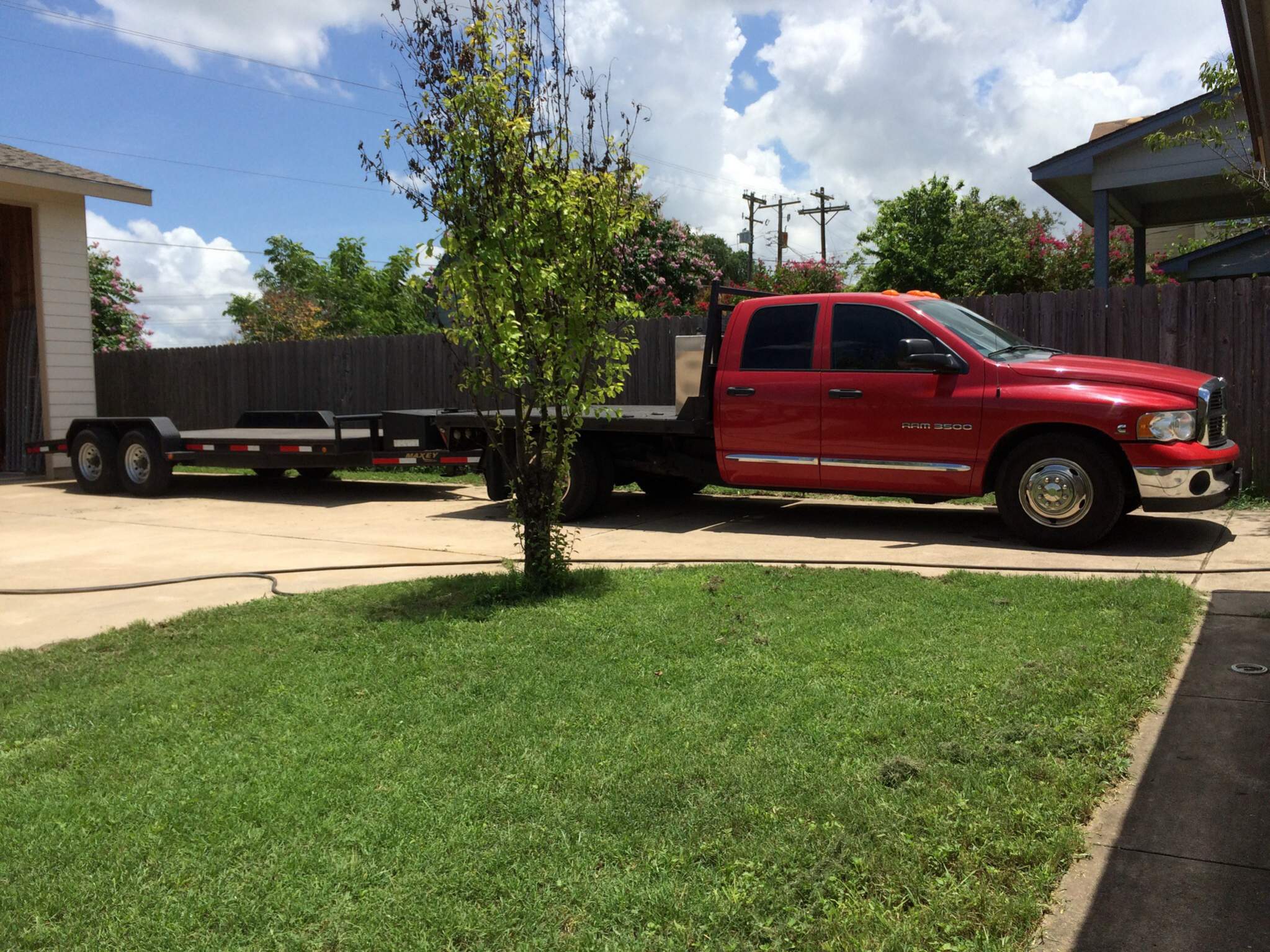

just got the 25 percent for July forth weekend at Harbor freight, looks like the mill would be 500 of the 1999, so with shipping and tax shoulder around 1800, will mill the wood at my shop in Austin,let it season there, and then bring it back to the property about 100 miles from north Austin,I bought my trailer 5 years ago,it is 18 foot rated for 12,000 has 12 k winch truck is a 3500 ram Cummings, set up with a 90 aluminum tank on the fact bed wishing I had bought a longer trailer, when I am cutting logs to be milled for beams of 16 to 18 foot, this trail will work just fine, but no room for tractor and logs, may be looking for a goose neck trailer to be able to haul tractor and wood in one load, a lot to consider, thanks for all the help and suggestions, Butch

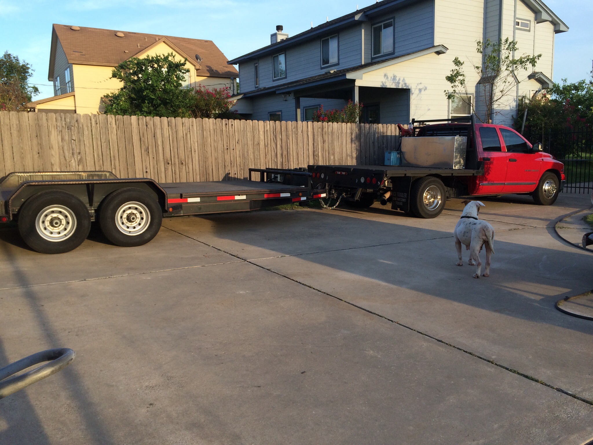

image.jpgimage.jpgimage.jpgimage.jpgI am going to build my own Auger stand for a 9" unit, have a Kioti dk45 planning on building steel pallets
for all implements to allow quick connect, for Auger,box blade , grappler,fork quick attach. I will be working over 100 miles from my home, so have a 3500 Dodge Ram with a flatbed, and a 20 foot flatbed rated for 12k so will be removing tress pines and oaks up north east Texas way, planning on milling the tress back home, have a very large workshop with room to cure wood, the plan is to clear the land for building my retirement cabin on the lake, have an out 4.0 acres to heavily treed you can barley walk onto the property
have a nice 1 acre pond I own 1 /2 of on my property, looking forward to getting this started, looking at buying the harbor freight saw mill and making some changes to their unit, picking up the tractor Monday July 6 Monday, will not start the clearing until I fab up a thumb or buy one on eBay ,comments suggestions are welcome

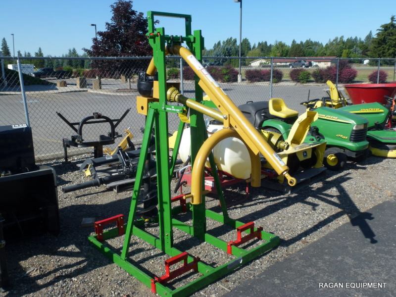

View attachment 431744View attachment 431745View attachment 431742View attachment 431743I am going to build my own Auger stand for a 9" unit, have a Kioti dk45 planning on building steel pallets
Nice rig. I have been working ~ 35 miles from home for two years (part-time) clearing my retirement property and putting in the driveway. I built a camp site there and have three storage bins for working supplies of all kinds, porta potti, etc. I kept most of the expensive things (chainsaws, etc.) in the vehicles and left the support equipment, fuel, chains, straps, etc., etc. at the camp site. Nothing was bothered until the transient contractors started working there.
Currently the contractor has started on the home and I am leveling a 48 x 85 spot for a shop with a lean to for implement storage and outside equipment trailer storage. Shop itself will be for tractor, new truck, tool and work shop area. I just got (300 miles) a 2015 RAM 2500, crew cab, diesel, 4WD, moderately loaded Big Horn.
Glad I did not have to work 100 miles away. Might be a good idea to have a camper on-site once you get a spot cleared.
