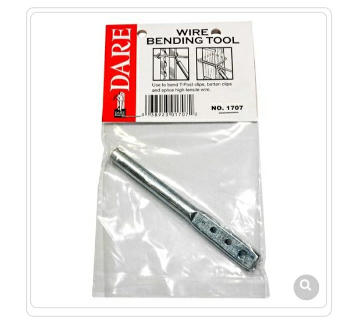

T post clamps aren't too bad with the bending tool and I use small vice grips where I can. 20210211_152942.jpg20210211_153541.jpg
