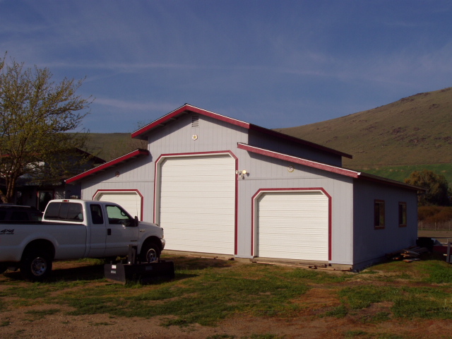

Can anyone help me figure angles for truss's on open loft/storage for a barn style roof for a shed. 16 by 20
If you want to achieve a barn style roof that has an upper gable roof and two (one on each side) mono trussed shed roofs that all have equal roof pitches, determine the dimensional floor plan and center bay wall height, take that information to a truss company and ask them to calc them out. Please don't spin their wheels-be sincerely in the market.
