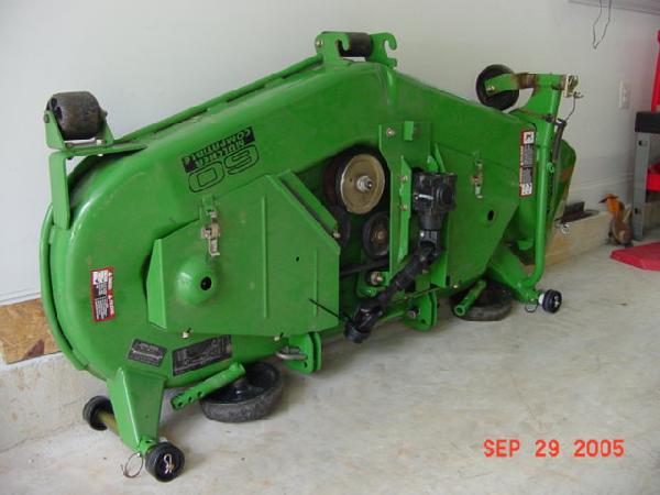

The reply that the 2x4's won't work is probably correct. If the deck didn't scoot, the tires probably wouldn't climb the deck easily. There are tabs on the deck that the tire lugs match up with and you wouldn't want to have it any higher. I use the loader to raise it and put wheels on it for vertical strorage. However, I can lift one corner at time without much trouble and slide blocks under it if I want to lower the wheels and I'm not that young or strong.

I don't have a drive over deck, and I'm not sure why that matters but I use Larry's Mower Axles to store my deck vertically:
kennyd, I was looking at those mower axles...how do you lift the deck to install the axles?
...I use the loader to raise it and put wheels on it for vertical storage. However, I can lift one corner at time without much trouble and slide blocks under it if I want to lower the wheels and I'm not that young or strong.

I basically "stole" the design and made my own. 1/2" pipe fits through the John Deere rear wheel mounting holes. I put 5/8" threaded rod in the end of the pipes and bought 10" Harbor Freight wheels/tires on sale. I had an old thread on this and several others have done it. Once you have the parts, it's a 1/2 hour job.
