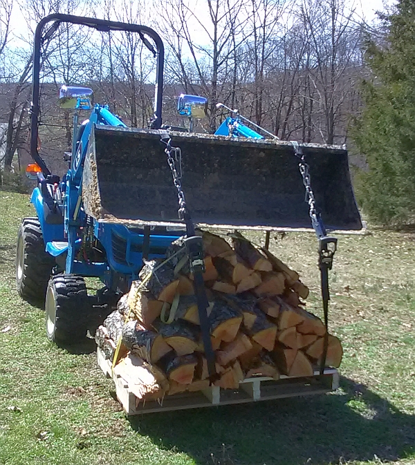

Who needs pallet forks when you can sling'em around? NOT the way I'll be doing it normally, but it works for now to position a few a short distance. Low (just off the ground) and slow. Worked fine. Yea, I know the one strap is in too far, but it was the first one as a test. The other two worked fine also. Under the bucket instead of out in front might be better though.
Pallets are cut in half to make them easier to stack with irregular firewood, so there's a lot less weight to begin with.
