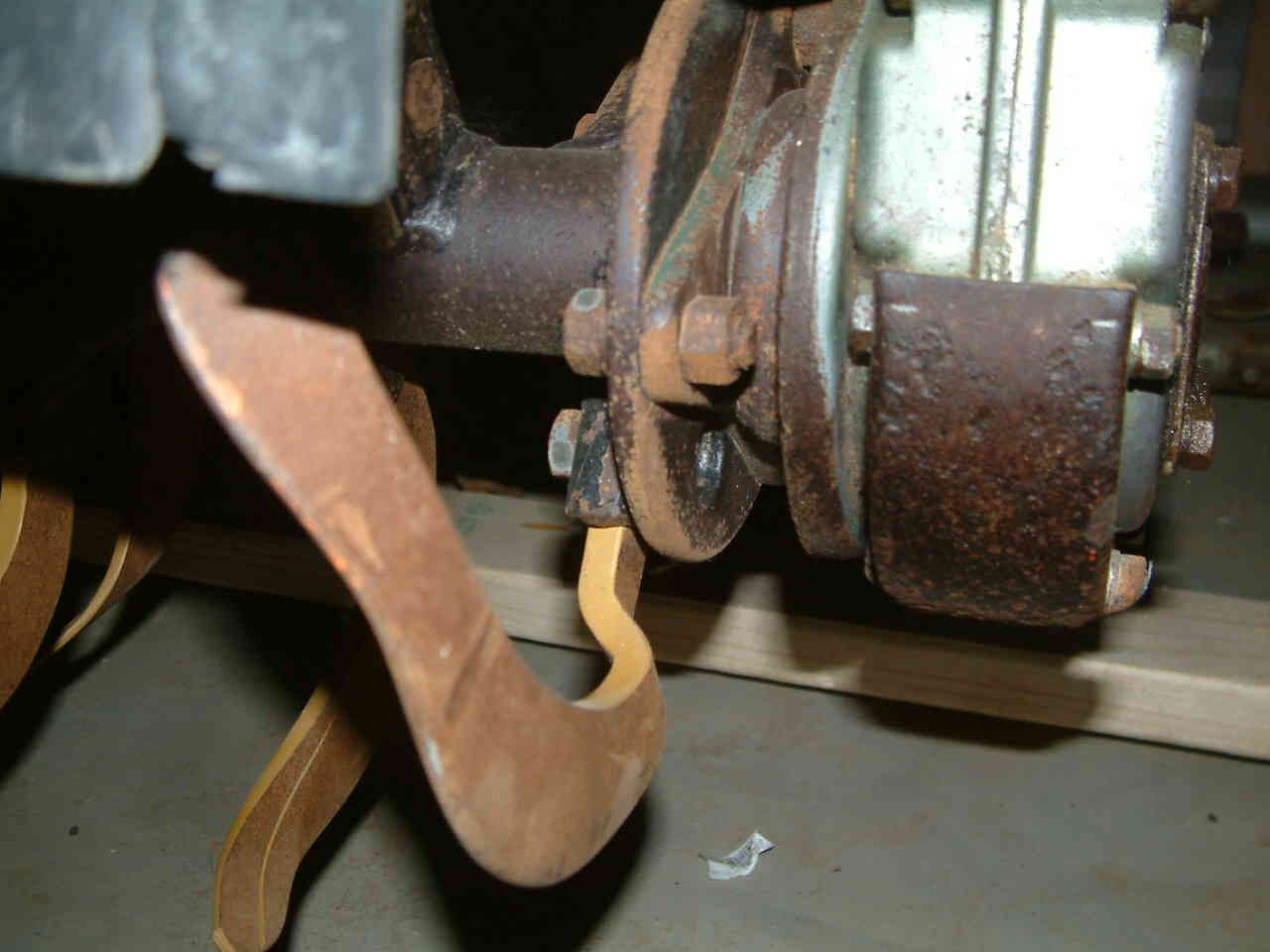

I bought an RS1200 tiller last month and am getting ready to use it. Don't have a manual showing the parts so I'm feeling my way to hooking it up to my Kubota B7510HST.

According to this thread, there's a shear pin on the tine shaft. Here's the quote:

I checked my tiller and found three bolts that connect the chain drive to the tine shaft (see attachment).
Question: are these three bolts supposed to function as shear bolts for this tiller?

</font><font color="blue" class="small">( are these three bolts supposed to function as shear bolts )</font>
No. Look at the PTO shaft between the tractor and tiller and either on that shaft near the tiller or through the tiller input shaft itself.

The shaft on the tiller has a hole drilled through it where a shear bolt might be installed. But that shaft is splined, not smooth like, for example, the shaft on the gearbox of my KK brush hog which is set up for a shear pin. This makes me think that the tiller shaft is not designed to handle a shear pin.
That's why I did the TBN search and found that thread I referenced in my earlier post which seems to say that the RS1200 has a shear pin somewhere on the tine shaft of the tiller. I checked the tine shaft for anything that looked like a shear bolt and the only things I found are the three bolts shown in the attachment.
The PTO shaft that I got with the RS1200 has splined female connnections on both ends. This makes me think that this tiller is not set up for a shear pin in the implement end of the PTO shaft.
   / Question on Yanmar RS1200 tiller #4
Ray, I'm not familiar with that tiller, so I think you can ignore my previous post. That one is obviously different from any I've used or looked at. I still don't think it would be those 3 bolts; I would sure expect it to only be one somewhere, but I could be wrong even about that.

I agree with you. Hard to believe that Yanmar would use 3 shear pins on that tiller.
That said, I'm still wondering what they were talking about in that old thread I cited in my initial post. Very confusing.

my RS1400 seems to be like yours. I dont have a shear bolt either, if the tiller catches hard ground or a rock, it will push the tractor.. I will be installing a slip clutch soon.
