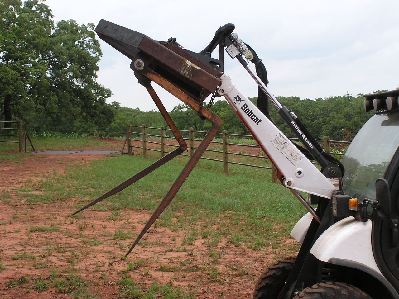

I vote for the rail type pallet forks that latch in place. You can dump something of off them if you want to.
Look at the chain on the fork P6190011.JPG, if you can't dump something off of that, then gravity quit working! :D

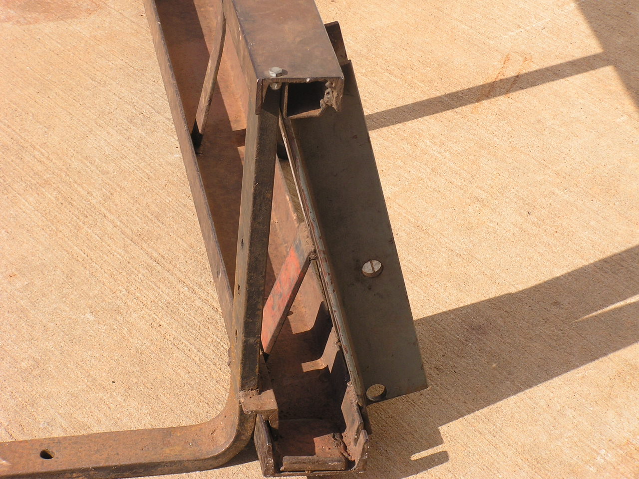

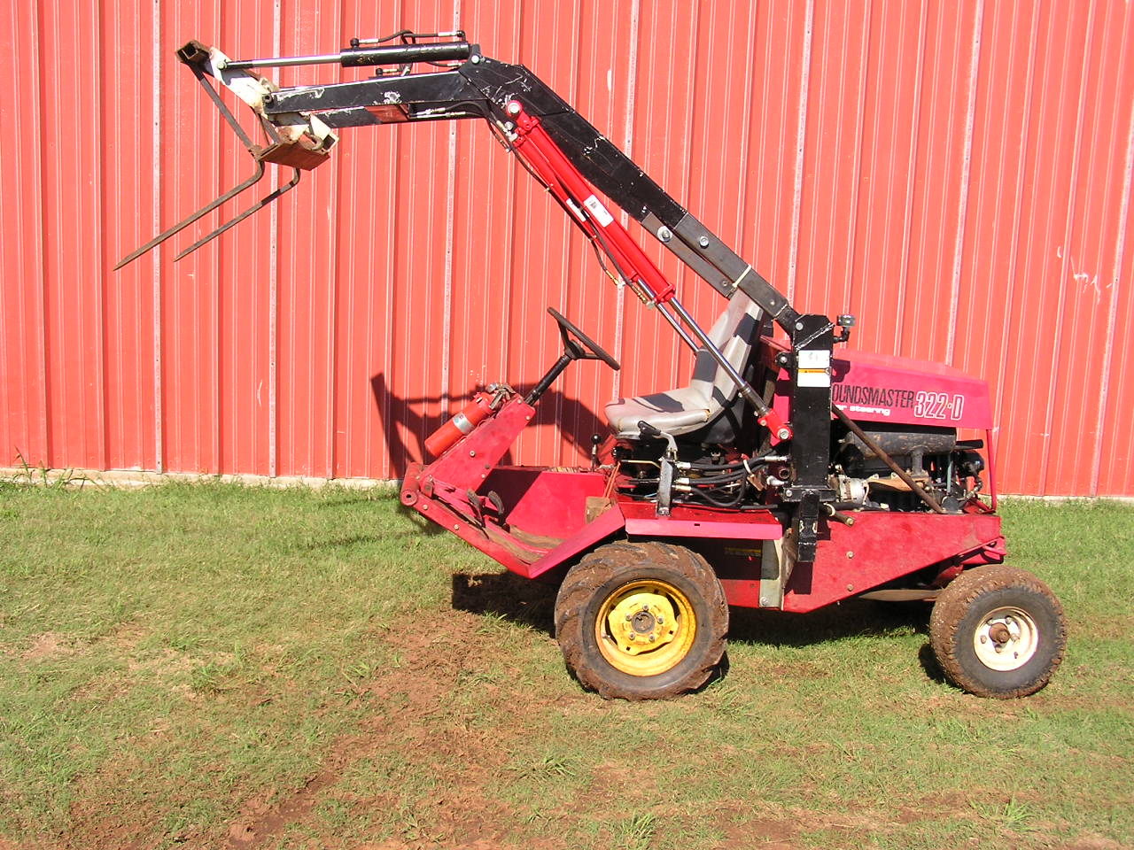

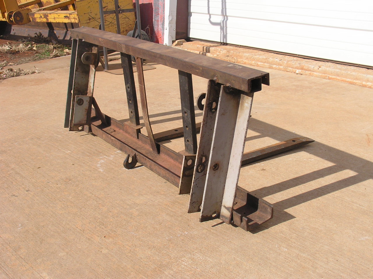

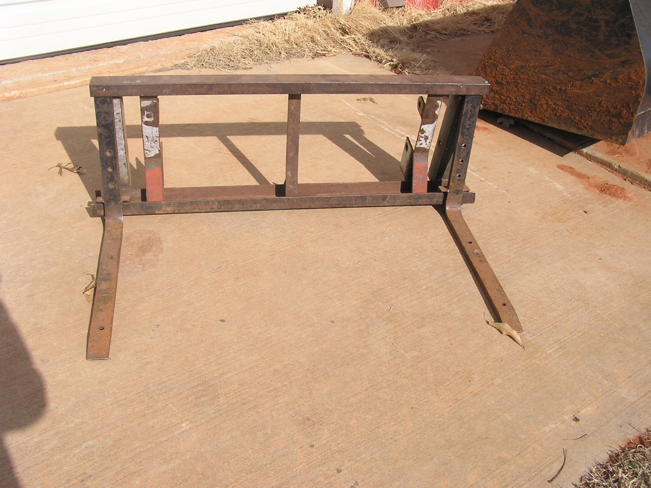

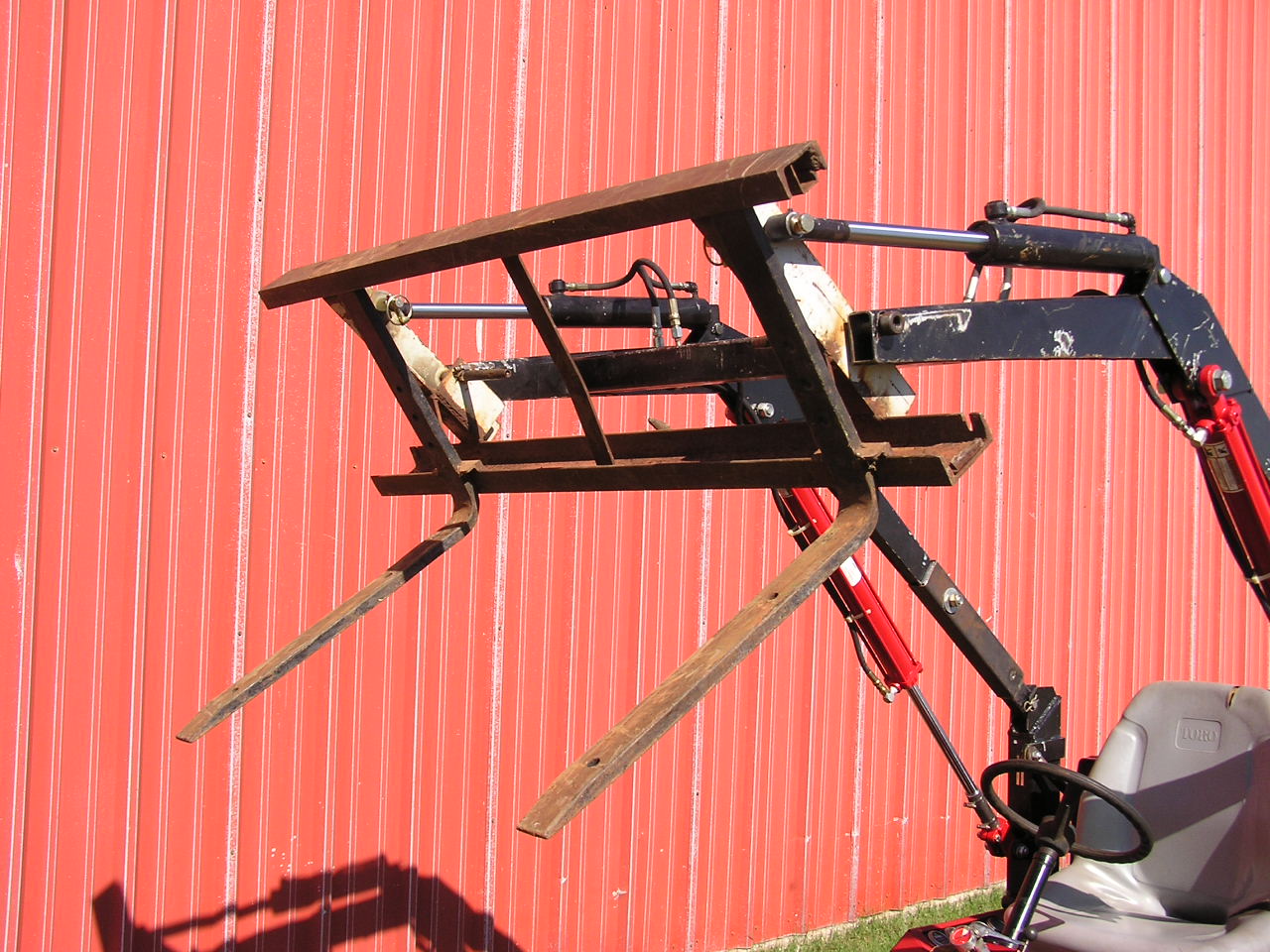

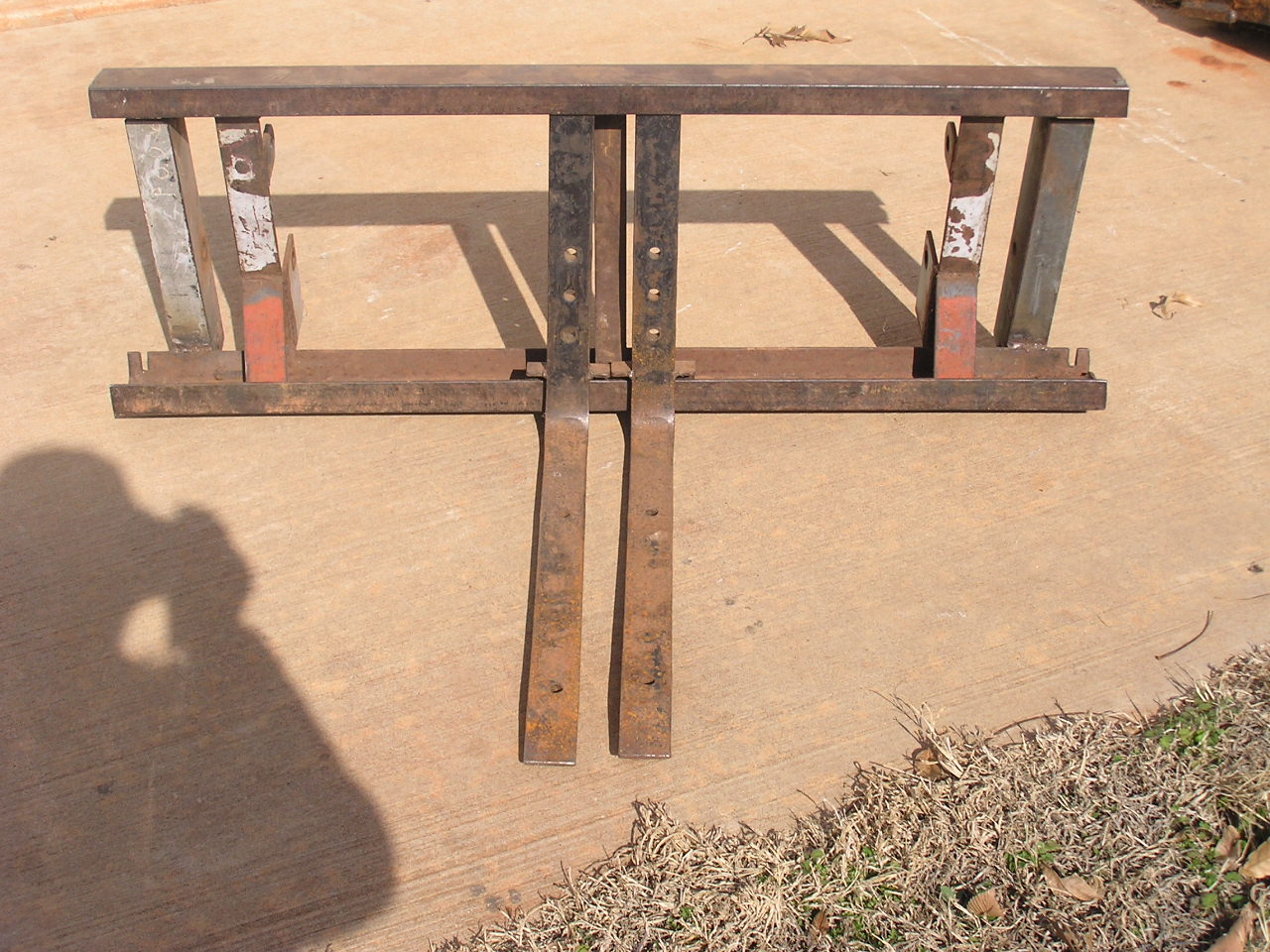

I also have rail type forks that I built the frame for about 30 years ago.
PC040004.JPG PC040005.JPG PC040007.JPG PC040016.JPG P8181940.JPGP8181941.JPG
