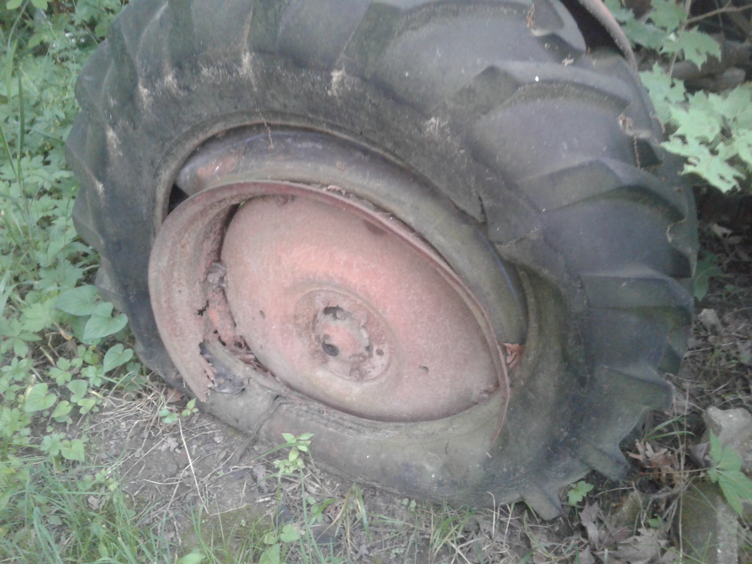

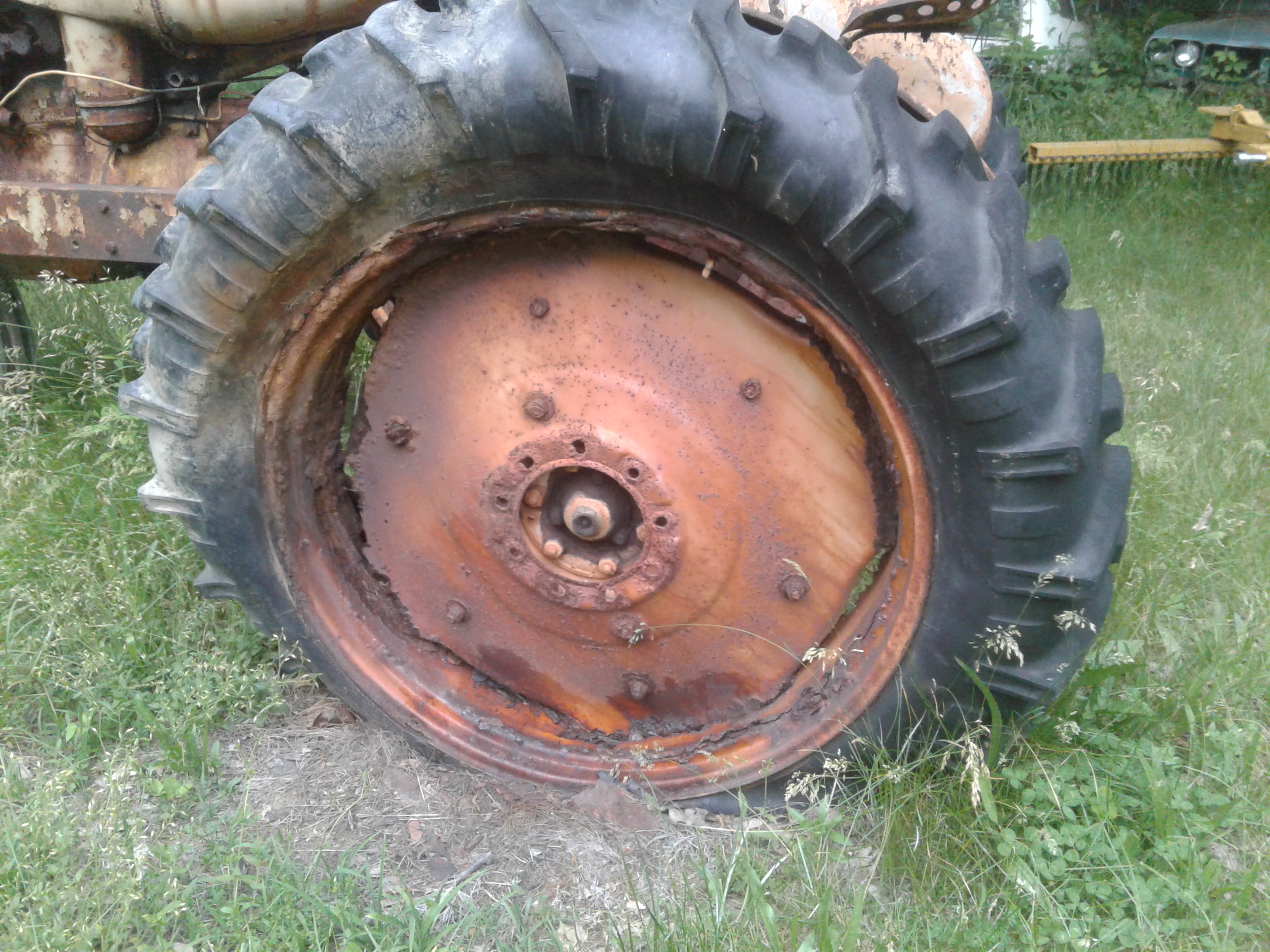

They may LOOK fine, but when you need to replace tires, you will most likely need to replace rims also.
   / Question regarding calcium chloride in tires #14
I 2nd that idea
   / Question regarding calcium chloride in tires #15
If the tires are tubed (which the OP's are not) and leaks are immediately addressed there will be no rim damage. In 2017 I sold a 1976 Case 885 and 1970 Ford 4000 both with pristine original rims that had been calcium filled for many, many years if not since new.
   / Question regarding calcium chloride in tires #16
Not if you use the tractor much, you will wear the tires out long before the cal. affects the rims enough to need replacement.
At least that's what I'm seeing from myself, and my farmer friends...
SR
   / Question regarding calcium chloride in tires #17
Well many years ago all of our farm tractors had calcium filled tires.
This past year two of them had to have new rims the JD 4020 and one of the IH 656's.
The 560 got new ones a couple of years ago.
My 574 because it is not used for heavy work got about 10 hours of welding repair and grinding last year.
I think out of over a dozen tractors on the farm, one may still have calcium it the rest are all dry and carry wheel weights instead.
I have seen rims that rotted out in a dozen years and others that have made it 50 years.
I use iron and will not fill a tire with liquid if I can avoid it anymore,
that said calcium fill is the least expensive way to add considerable weight to a tractor.
