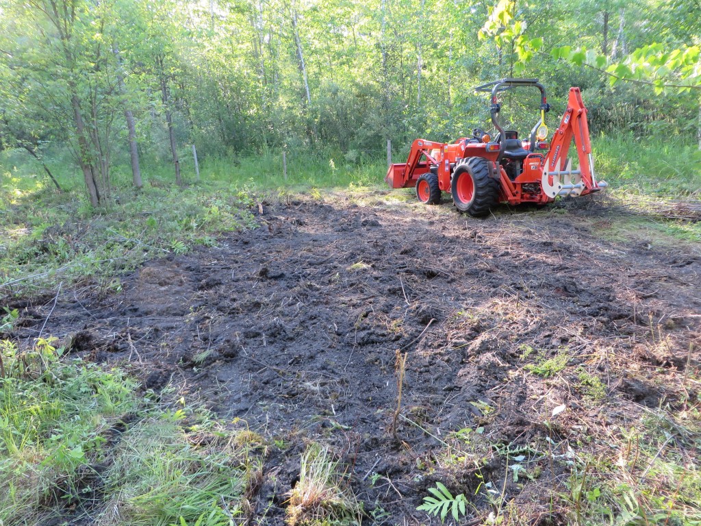

I have a few acres of roots to deal with. All are shallow and fairly easy to pull with backhoe, I have been considering a root rake, but because of the volume of roots, I will constantly be jambing up and just spinning the wheels. The land is mucky, and it isn't difficult to get mired.

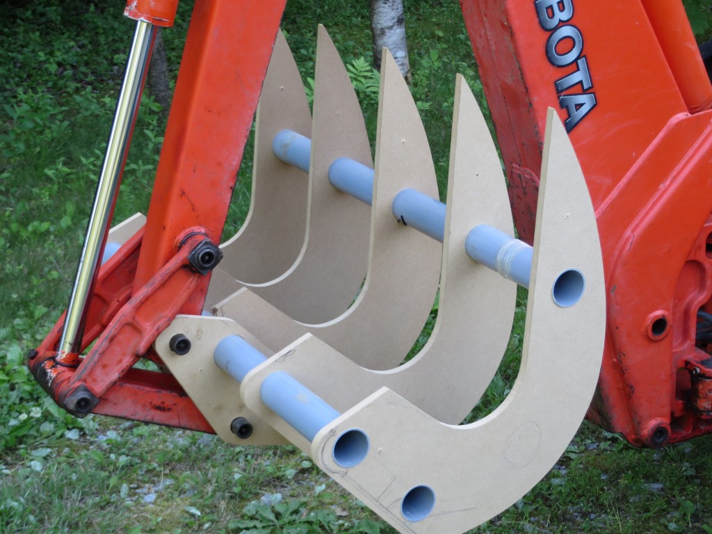

I think that a backhoe rake would be best suited to my needs. Since I cannot find any such thing, I prototyped this design out of mdf. and plastic pipe which I plan on getting this professionally cut and welded out of 1/2" steel and thick walled pipe. Do you think it will work. That is will it need more than pipe to keep it from racking and twisting? This prototype is 32" wide. I just took a stab at the shape of the tines, nothing scientific.

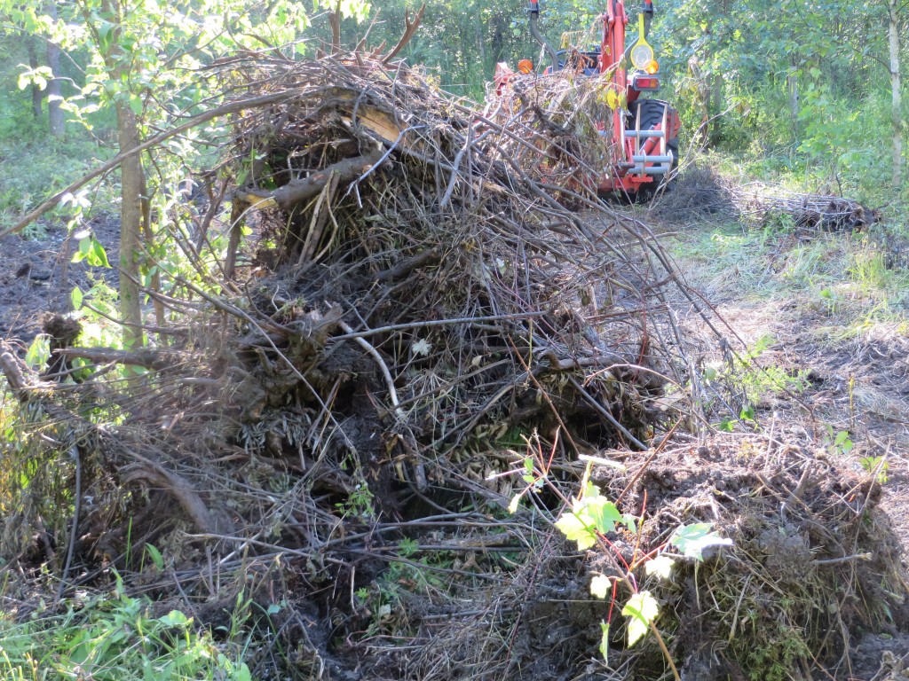

I have included pictures of a small patch of ground I cleared experimentally, and show also a picture of the mountain of roots from that small zone.
Thanks and I look forward to your inputs.

I'll take a stab at this, and say that given the size of the backhoe, I think it'd work out.
The 1/2" thick tines should be plenty. Make sure you specify at least Schedule 40 or thicker for the pipe.
Only concern I'd have is on the total length, with the outside tines really pulling on those pipes. But since it's a small backhoe, I'd imagine you'd hit the relief pressure or drag the tractor around before it could really bend anything badly. And even slightly tweaked tines would still rake just fine.

Thanks for the inputs. I will specify the schedule 40, and probably should add some plate steel between the pipes as well to keep the outer tines a bit more stiff. I'll be happy to post pics when it gets done.

Looks good and I agree with the others I think it would work fine. Lot of excavators that have these are designed with replaceable teeth was wondering if you had considered them of course these excavators are sometimes used day in and day out in every soil type there is. I don't think you would need them it would take years to wear down the tines digging roots if you have minimal rocks in your area. In your 3rd picture I don't see any rocks.
Looks as if your design gives you a full range of motion. Nice mock up. Later on you might want a hydraulic thumb to compliment your rake. I like suggesting ways of spending someone elses money.:)

No rocks to dig out A thumb will come at some point I hope. My land clearing strategy is to leave the big trees alone for now. I use my brush cutter to level all the vegetation. Any big stumps will be removed by bucket. Next I'll swap over to the backhoe rake. My wife will maneuver tractor about, and I'll rake. I will sort compostable stuff from the woody roots. And finally I'll dig pits to bury the woody roots or burn them. Slow process, but it's fun.

I'm thinking of skipping the welding, and adding flanges to the tines and attaching them to the bars with bolts. This would make it adjustable until I find the most effective rake width. Then I could weld afterwards. Now I just have to cad draw the tines, so I can go to a water jet cutting shop to get the parts made .That's gonna be fun.
   / Question regarding homemade backhoe rake #12
There are other sizes of pipe available. Schedule 80 is twice the wall thickness of 40. There is also "double extra strong" that has much greater wall thickness. Also if standard pipe diameters are not what you are looking for then you can go with mechanical tubing. I've used some 3.5" x .625" wall DOM that was really great to machine and took a weld much nicer than pipe. Go to ALRO.com and search under tubing. It will give you an idea of the material available at least. You can also get some pricing just to see if your local steel supplier is in the ballpark.
You can save some money by having the tines flame, plasma or laser cut rather than water jet. WJ pieces have a really nice finish and tolerances are tight, but in my experience more expensive than other methods and in this case as long as all the tines are identical, a moot point. Maybe look at using AR400 or AR500 plate for the tines, since you are not machining them, this harder material will give you longer life than a HR A36 or CR steel.
