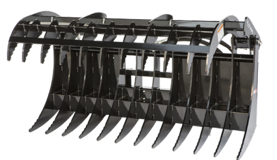

I'm looking to buy a root rake style grapple for a Case TR320 compact track loader (skid steer). What I picture using it mostly for is brush clearing/land reclamation to clear overgrown areas of buckthorn etc. and then be able to handle the brush (move it into burn piles) without picking up too much dirt in the process. Last year we had a forestry mulcher come in, and we followed up with a brush hog to take down some of the more fine stuff. However the operator didn't put the mulcher down into the ground (leaving the stumps) and there was a lot of material to clean up afterwards. We used a landscape rake (with casters), but it was difficult to do a clean job and not pick up too much dirt.
Anyway, I'm kind of stuck between these two styles, one which has more of a skeletonized bucket/tines and the other which has very short tines that seem much more suited for plowing/raking through the dirt. I'm figuring that a rook rake style will be more suited to our needs but a brush grapple might be a little more versatile for material handling.
Case options I'm considering below. Unfortunately it doesn't seem like root grapple has independent grapples, it it seems like the grapple could function as a push bar for controlling the brush as it's taken down?
vs
I'm also not sure what brand to go with. We have a good relationship with the local Kubota dealer and have bought a number of tractor attachments from them over the last few years, however the grapple Kubota advertises as their "root grapple) seems like a bit of a hybrid with medium length tines? The tines also don't seem as heavily built and suited for plowing through soil? What they call simply a "claw grapple" seems more like a root rake style, but it doesn't look as heavily built as other brands (and is single grapple).
vs
My questions are:
  1. What style would be best suited to what I want to do?
  2. If I go with more of a short tine, root rake style, is dual, independent grapples desirable? Does anyone sell one?
  3. Brand recommendations for a Case CTL (in Canada).
  4. What size? Just wide enough to cover the track width (74")? Is bigger better or do they tax the machine when working?
I appreciate any input I can get. I don't have a ton of experience outside some small root rake grapple use on BX SCUT and traditional bucket grapple use on farm tractors.
I'll be looking to purchase a something similar for a SCUT plus a 100hp loader tractor in the next year or two, so I'd love to hear opinions when it comes to these kinds of grapples.

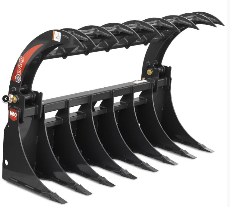

For what you want to do I would go with the rootrake grappler and the one showed your second picture the tines tip are re in-force so one they are more ridged and you can safely remove rocks with it not like the last picture you showed … The it depends on your soils type, it’s easier to rip roots out in a sandy soil then a clay soil… then there are the type of trees … aspen and willows have very deep roots so you need to grab them deep to pull them out, alder can be challenging to rip out as well because of there dense root ball … spruce are the easiest they don’t need much.

The V60 model from Virnig looks nice. I could probably move down to a V50 since this won't get steady use. One dealer in my area.

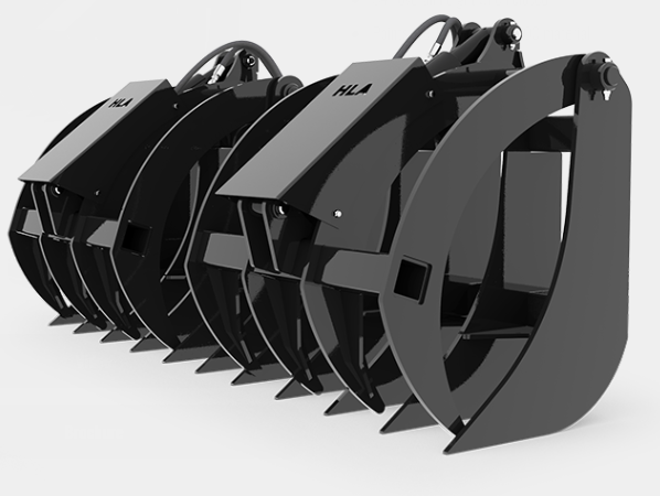

HLA (made in Canada) has some models, but without the pin on teeth, they look a bit light to me. Bonus that they have model with independent grapples though. They seem to have a pretty wide dealer network.

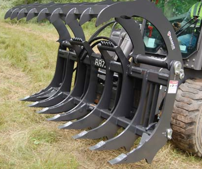

The Palladin/Bradco model looks pretty rugged, and again there's a lot of dealers for them around. We've got several of their other attachments (bought a number of years ago) and they seem decent.

The only thing I notice from all your model above is the tines don't have the V shape taper in between the tines... my grappler below has it and these are so useful without them there would be lots of things I couldn't pull out... and that what holds the stumps with the roots out of the ground it drives it to the end and wedge it. Just one thing to consider

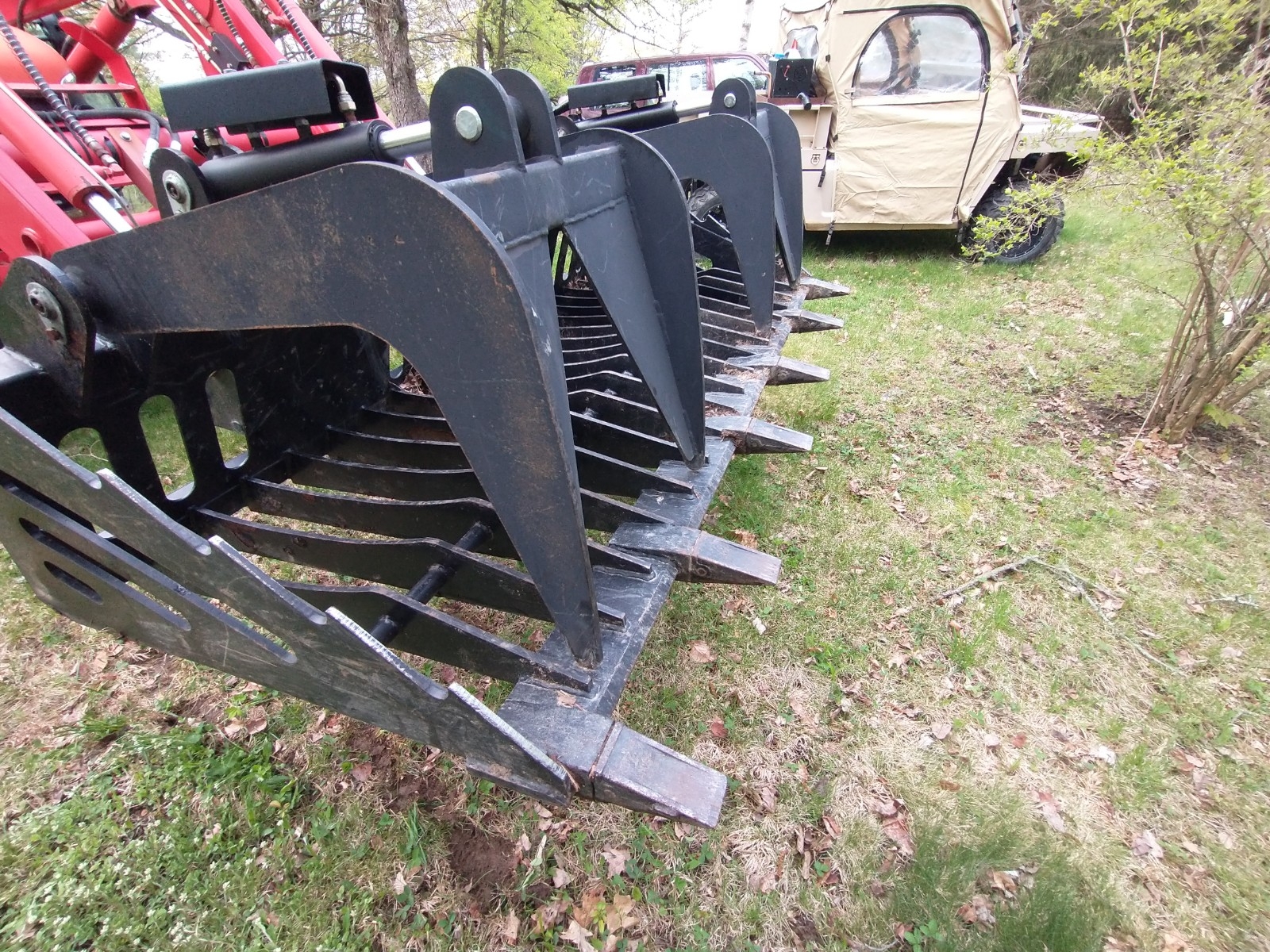

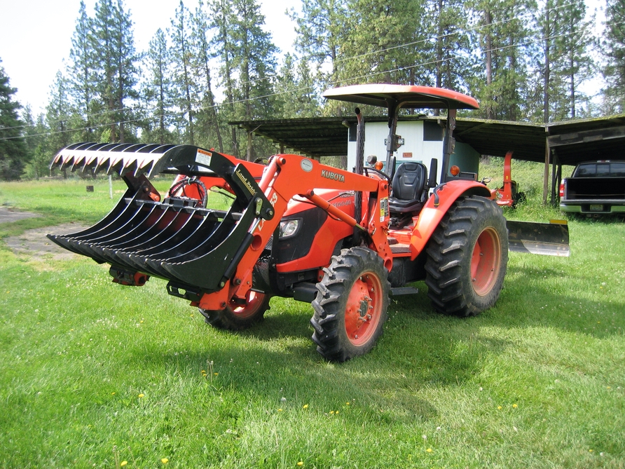

I have the long tines on mine like the internet pic I grabbed. From AE. Use it a lot. Works great. Just couple of things:
- single lid works well for me. never yet needed a double and I do work similar to you. Simple. less to maintain / break maybe?
- draw back of long tines is when moving some type of brush (and with serrated teeth at the tip). I can be a pain once and a while dumping the load. Need to use full down curl and shake sometimes but still manageable.
- long tines work well as I like to compact / crush my brush piles down before carrying away and long tines gives nice flat long bottom to do this. I move a lots of brush from my wood lots to winter burn piles so the tighter the load the more I can move faster. I think longer tines move more brush faster.
- longer tines are nice when you want sort of a pallet fork affect. Carrying rocks, bigger stumps, etc.... I can get UNDER the item and lift curl back and often don't need the lid down. Relies less on lids for saftey / holding stuff in place with the longer tines.
personal preference as both make short work of lots of stuff. This pic is a dble lid mine is a single lid though. Just noticed double lid has more coverage across entire grapple where single only cover about middle half. Nver noticed before but again never had a yearning for anything more than my single lid doing my kinda stuff.
Yeah, that definitely looks like it would be handy. I haven't come across any skid steer models that seem to have that.

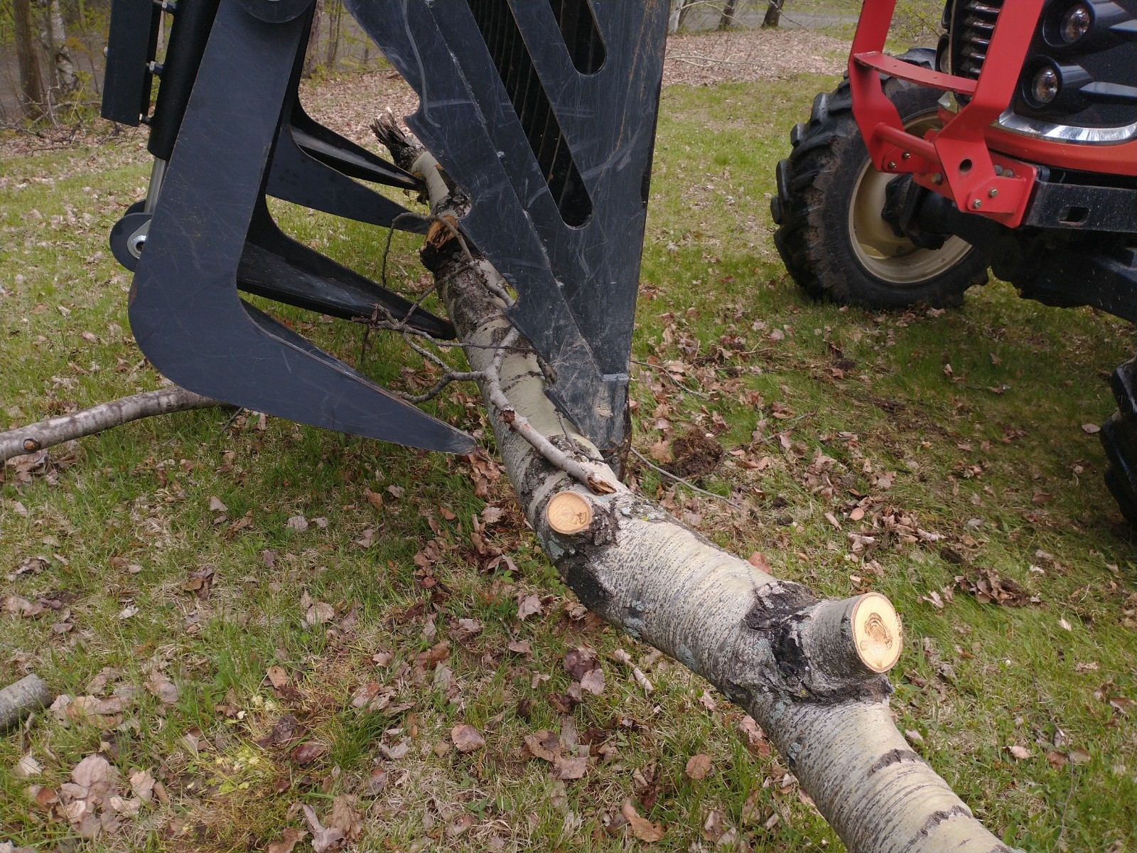

Here are a few pictures of my grapple;
You can see in these pics how far ahead of the grapple clamps the teeth are;
To grasp a log or pile of brush the grapple has to be rotated all the way down and back towards the tractor for the grapple clamps to be able to grasp any item. If you are pushing up against something trees or what ever to push material back into the bucket you can get a decent load otherwise it is a pain.

You've got a rock grapple, if you want to pickup limb you need a root grapple or debrie grapple. Rock grapples are much heavier due to more support for heavy rocks and debrie. If you're digging these are heavier but beware you need to watch your cylinders. That first picture you have you cylinder fully extended and it you hit something you'll break or bust the stops. It take some experience to properly use each type grapple. A clam grapple with easily grab but it takes more hydraulic pressure for the lid to hold. A debrie grapple you slide the bottom of the unit on a flat plane into the debrie and most of the work is in the lift. The claws keep the material from pulling back out of the bucket. Personally I don't like your unit unless you are clearing a field of stones and such and it would be great.
/ Brush Grapple vs Root Rake Grapple #18
Yes, it is a rock grapple. In the third picture it is not quite fully extended.
We have not had much luck with it picking stone either our ground is heavy with lots of rocks and unless it's too dry and over worked you pick up as much dirt as rocks. It's good on the larger rocks 20-30 pounders and larger. I've had over a 1000#s in it before I've got decent hydraulics.
/ Brush Grapple vs Root Rake Grapple #19
That design looks more like a skeleton bucket with a lid to me.
This is how mine is shaped. It's got big holes so not great for rocks at all. The sides are open though so it dosnt squeeze logs out.
