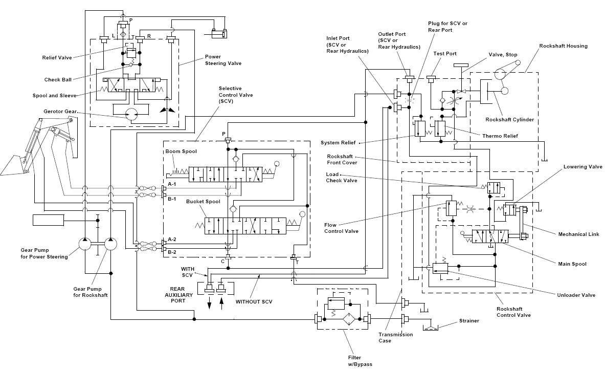

The 790's, as well as most of JD's smaller compact tractors where made by Yanmar in Japan to JD specs, that is why they are so simular.
   / Question regarding old thread/ 790 Hydraulics #12
790 hydraulic schematics.
