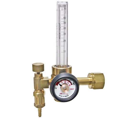

Bob you can use the CO2 in Mig welding, I am not sure what connector that tank has on it, it could be CGA 320 and a normal MIG mix tank would have CGA 580. what regulator do you have? is it a CGA 580 fitting.? You normally don't use pure Argon for MIG, you normally use Mig mix. which is 75% Argon and 25% CO2. Co2 gives more splatter, and slightly deeper penetration. A lot of guys do use it instead of Mig Mix because it is cheaper. Of course you don't use O2 or oxygen at all.. wow that would be dangerous.:shocked: and not at all effective. The whole idea of a shielding gas is to shield the weld from oxygen and nitrogen in the air by displacing it with the inert gas. Of CO2 is not exactly inert. You normally use Pure Argon for TIG welding. See if your regulator and the cylinder fitting are compatible. Also I think your flow meter reading are different for CO2 vs Mig mix.

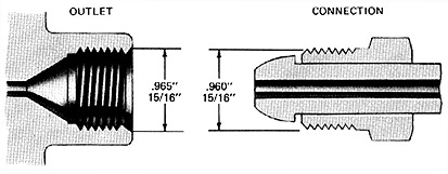

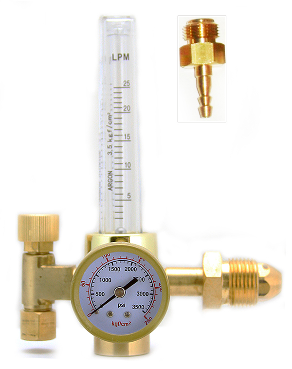

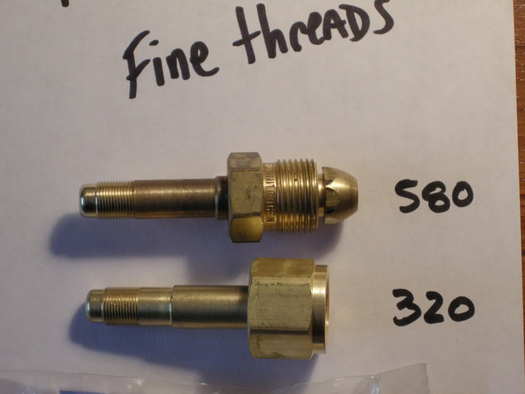

here are some pictures, maybe this can help
here is a drawing of a CGA 580 fitting, the female Tank is on the left and the fitting is on the right. cga580.jpg
The here is a CGA 580 regulator/flowmeter, like you would buy on ebay.. notice the Male threads and rounded sealing face.small CGA 580 flowmeter.JPG
here is both a CGA320 and a CGA580 fittings that would mate up to thier respective tanks.. Notice the CGA320 fitting is female and the tank would be male.CGA 320 CGA580.jpg
Finally here is a CGA320 regulator/flowmeterCGA320 reg flowmeter.JPG
Hopefully you have a CGA580 regulator/flowmeter and that tank is CGA580, but I cant see it well enough to know. All I am saying it would not be a good deal to buy a tank that does not match your regulator..

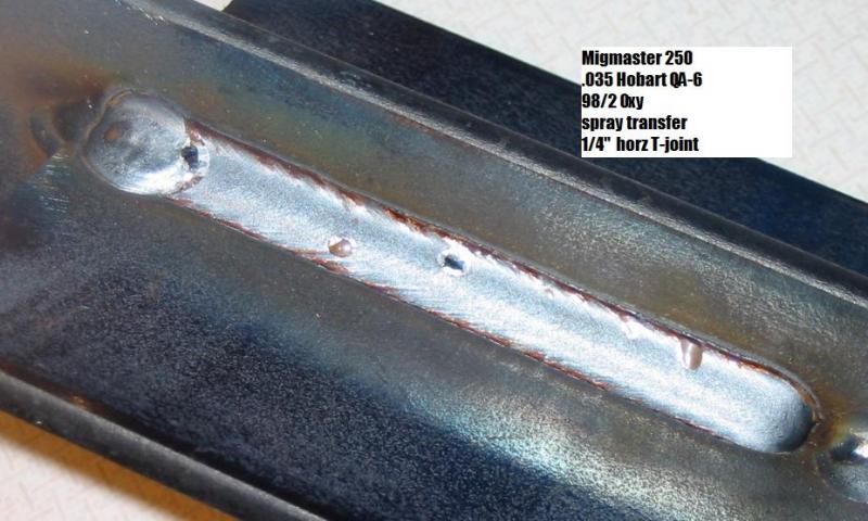

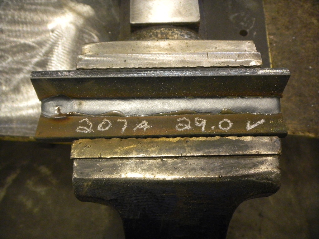

Actually 98% Argon, and 2% oxygen is a very good mix for spray transfer welding. You still need a machine that can get into the high 20s for volts though.
   / Questions about a tank for my new Mig Welder... #9
I don't believe Bob is going to be doing a lot of spray transfer with his little 110 volt Mig. though:)
   / Questions about a tank for my new Mig Welder... #10
Oh, I didn't see that part:eek:. Lot of guys come onto the welding forums thinking they're going to build bridges with their 110-volt Mig welder.:D
