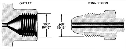

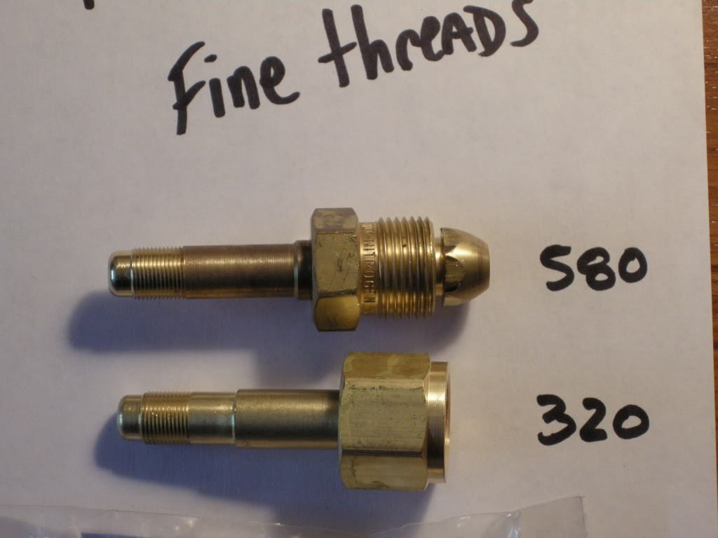

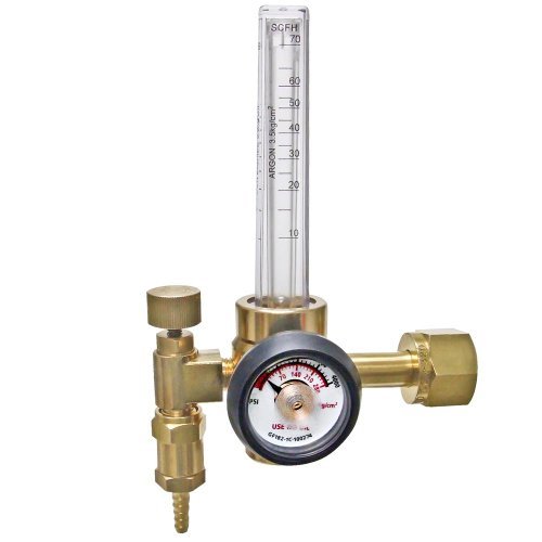

here are some pictures, maybe this can help
here is a drawing of a CGA 580 fitting, the female Tank is on the left and the fitting is on the right.View attachment 338246

here is both a CGA320 and a CGA580 fittings that would mate up to thier respective tanks.. Notice the CGA320 fitting is female and the tank would be male.View attachment 338248
Finally here is a CGA320 regulator/flowmeterView attachment 338249
Hopefully you have a CGA580 regulator/flowmeter and that tank is CGA580, but I cant see it well enough to know. All I am saying it would not be a good deal to buy a tank that does not match your regulator..
James K0UA

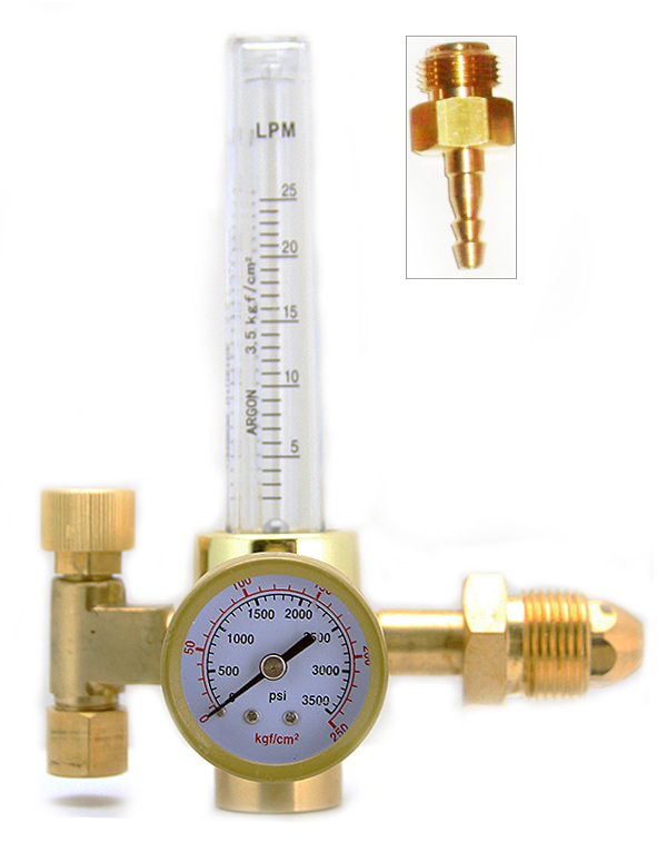

I just checked James and based on the pictures you sent ...I do have the CGA580 - It has tow guages on it with a dial in the middle the outlet on the back is male and so is the one on the side..the one on the back goes to the tank and th side must be for the plastic gas line which I can't find now...darn it...I know I had it and I just looked in my shop and did not see it so ...I hope that is not hard to find...I remember having it ...it was a small dia. clear plastic hose rolled up...geeez. anyway thanks for the pics...now I can call him and know what I'm talking about ...a little...LOL

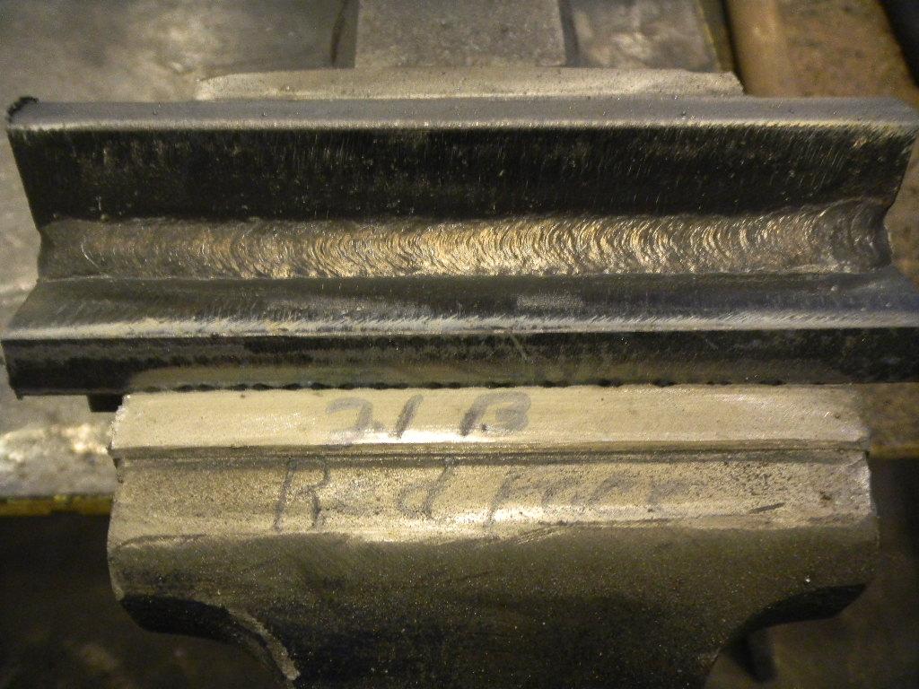

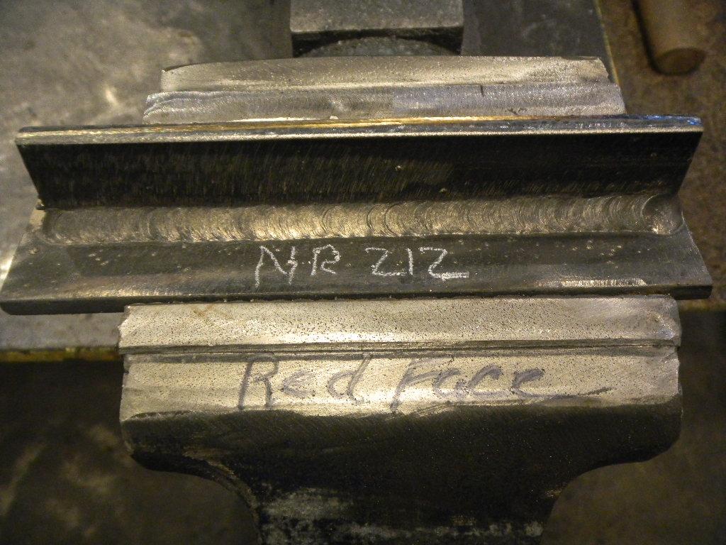

I've only played with one 110-volt Mig machine, so I really don't have any experience with them. But I have lots of experience with flux core self shielded wire. I think you would be surprise how many buildings, and bridges are welded with flux core self shielded wire.
Here are a couple of my flux core welds. I don't think they look to bad, besides isn't that what paint is for?:laughing:
