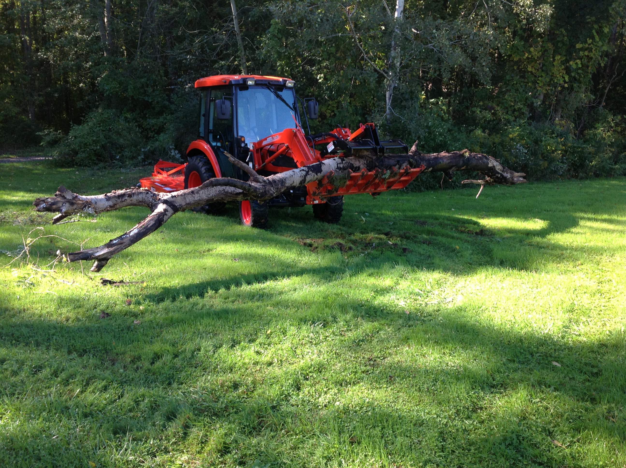

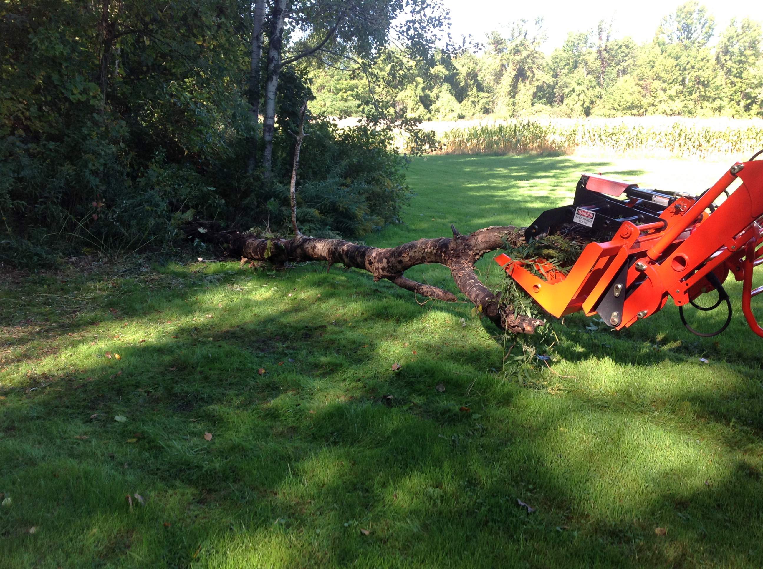

I had been wanting to pull out this log for a while and wondered if the grapple would do it. I was surprised how easy it came out!
View attachment 281871View attachment 281872
Dave, your grapple looks strong. Also looks like you are having fun with it. Wish I had mine. I was piling up debris by hand today. The 4N1 bucket is great for lots of things but not for picking up scattered debris.
   / questions about choice of root grapple #114
Reminds me of a proud cat that just caught its prey. :)
