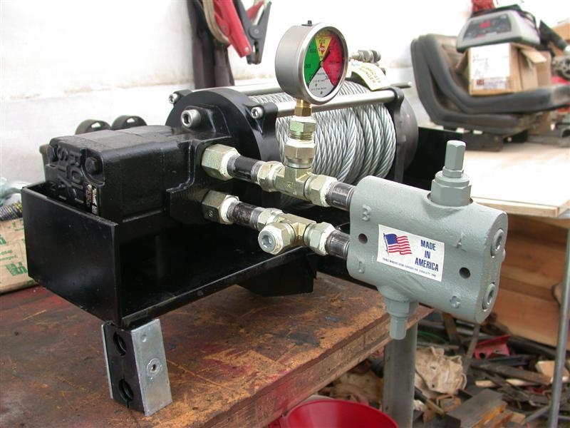

The Char Lynn catalog shows 3000 psi cont, 4500 int for this motor. I have one hooked to a Vickers hydrostatic pump on my garden tractor. Works great.
   / Questions about hydraulic motors for a front mounted shredder build #13
You are right, I found the data I was looking for.

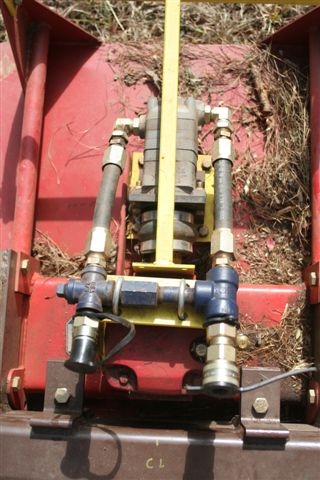

Tractor will flow about 16 gpm at 2770 psi, the skid will flow 21 gpm at 3000 psi.
The AUX valve and the Tractor FEL valve will have their relief valve set , so the double relief valve is an extra protection.
The rpm on the cutter driven by the skid steer will run at a 21 GPM flow rate, and the tractor will run the cutter at a 16 GPM flow rate.
Blade tip speed will change a little.

The tractor spec says open center hydraulics. The remotes on the front of the loader are operated through an electric diverter valve from the bucket curl circuit. So, is the joystick FEL control an open center valve? I am a little concerned about the flow rate through those valves. Is there a convenient way to check this? If necessary I have a set of remotes at the back of the tractor with full flow that I could pipe up to the front to run the brush cutter.
Not sure yet about the aux control valve on the skid, but sounds like you are confirming that the cushion valve plumbed at the motor will add some protection from hydraulic shock when the control valve is suddenly shut off or if one of the blades meets the "immovable object". Are we on the same page?

Yes, to same page.
