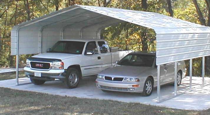

The correct answer is YES!
OP said he wants to build a very inexpensive shed that will just be used for firewood once he builds his new garage. He has been given instructions on how to build an expensive roof for a home which is not what he desires.
With a roof only 12' wide it is perfectly permissible to screw the panels directly to your rafters as long as your rafters are secure and do not need any extra 2x4 bracing which would probably not be needed on a roof that small since your rafters will only be 6' long unless it is a single sloped roof and then they are only 12' long.
The trick to it is to run the metal panels horizontal on the rafters instead of vertical. As long as you have enough slope on the roof it will be sturdy and not leak. It is best when running panels horizontal to use low rise panels and not R-panels.
Most of the small carports and sheds sold in our area have the metal running horizontal as in the image.
If you use metal siding it may be run horizontal also as long as the walls are braced properly.
Your firewood will remain dry and safe with much less expense. :)

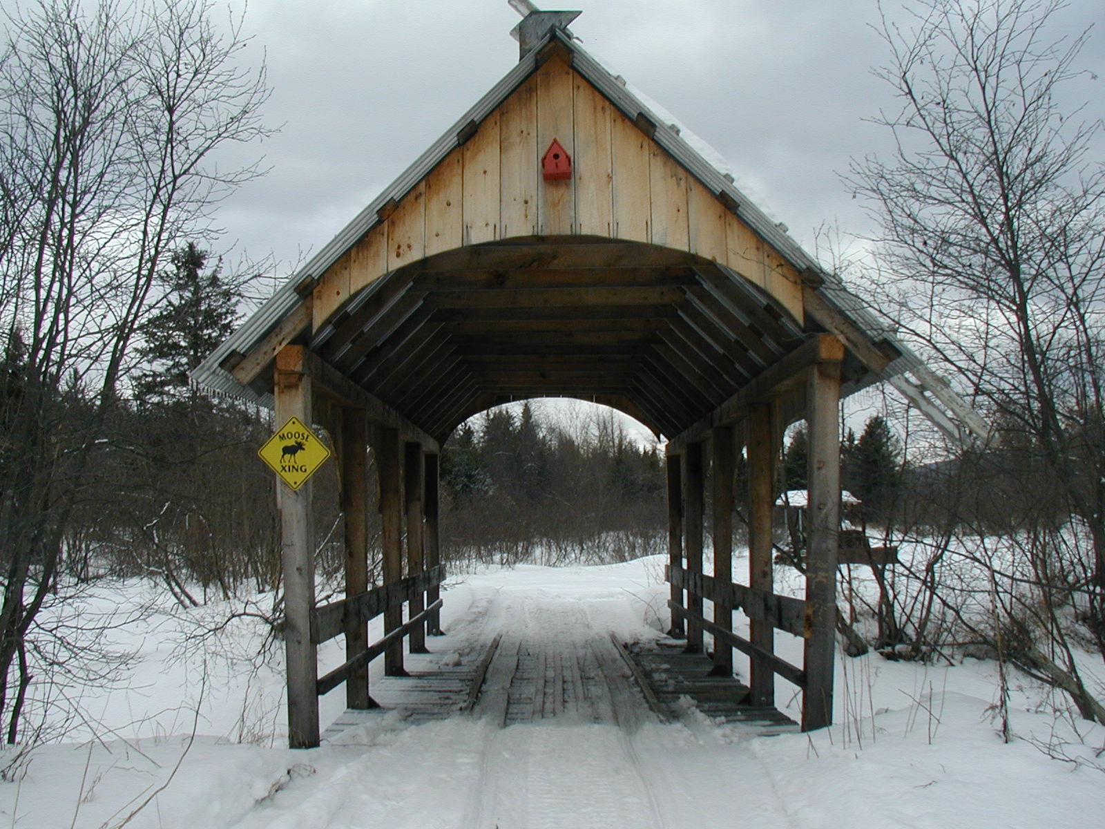

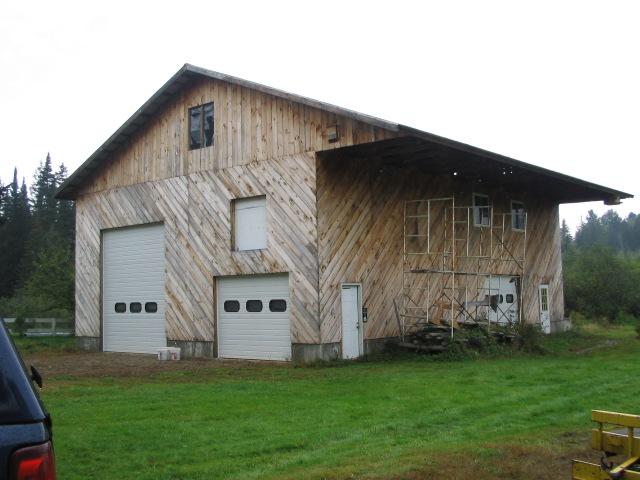

Don't underestimate the snow in your area. It doesn't cost a lot the build a good shed. Build your own trusses with 2x4s -24" OC, 6" or 8" pitch. Whether a cheap building falls on snowmobiles or woodpile it will be a total loss. The size of the purlins depends on span & spacing. Excess span a/o excess spacing will result in sagging/buckling ultimately reducing longevity. Money saved by spreading the purlins can be wasted if you have to walk on the roof & it gets damaged. Especialy important when ice/snow falls from one roof to another, ie from a main roof onto a leanto. My barn has 50' trusses spaced at 40" with 2x4 purlins spaced 24", 5/12 pitch. It will & does hold 2' of dry snow. My bridge has 2x4 rafters 24" oc 12/12 pitch &1x5 purlins 24"oc & no snow accumulates on it. In all cases the metal roofing is attached with gasketed screws.
Tallyho, With all due respect - your carport wouldn't last past the first lake effect snowstorm in the OP's area. Take a look at their snowfall numbers & compare to LA. NWS Buffalo Climate Information - Buffalo Monthly Snowfall (2000s) MikeD74T

The image I posted was just to show how horizontal roofing is run. His building must have much more pitch in a heavy snow area and also he is making it out of wood with rafters on 16" centers. 26 gauge metal on 16" centers with a good pitch should be sturdy enough.
