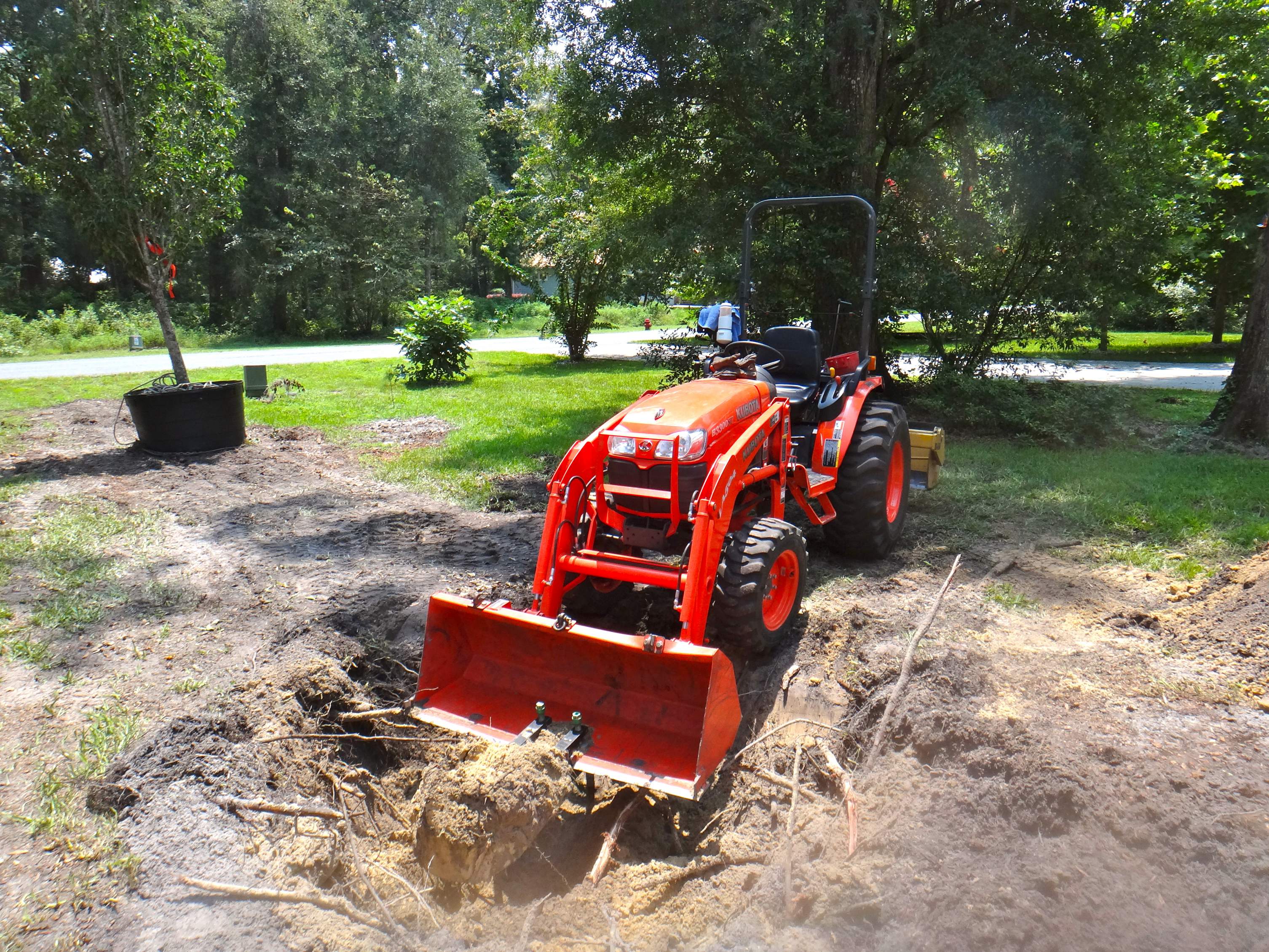

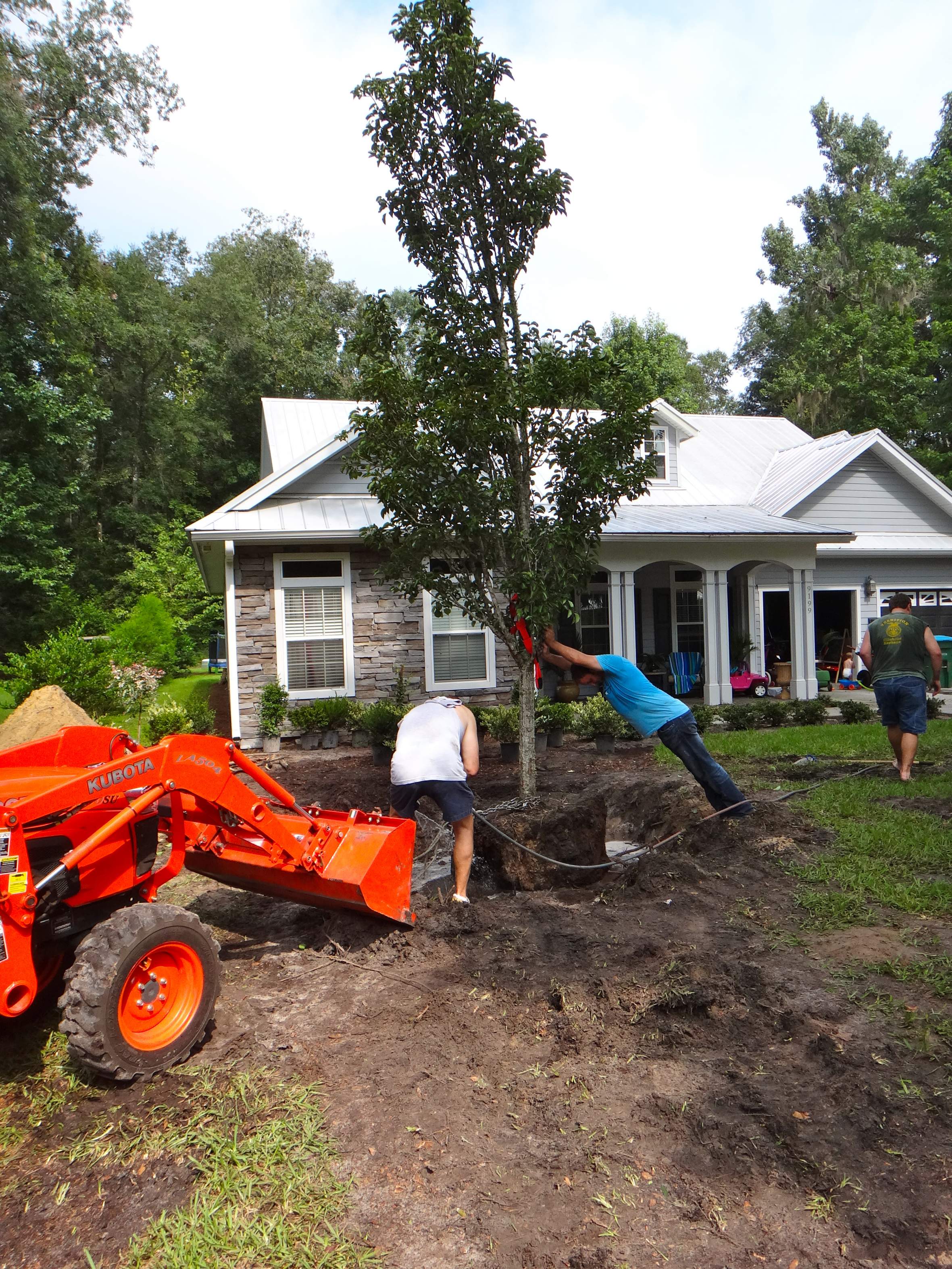

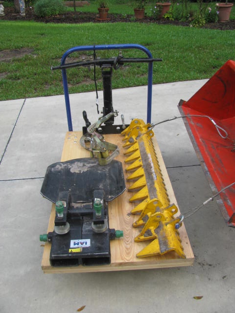

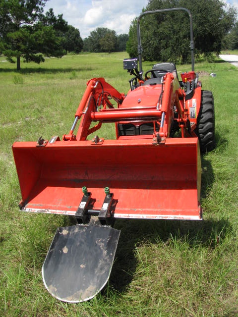

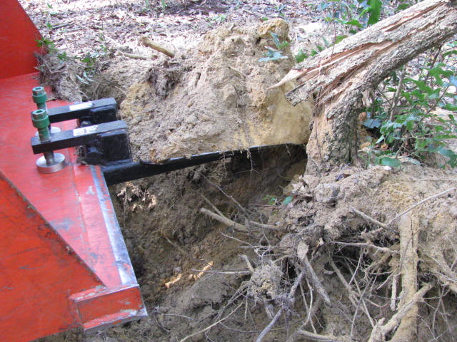

If you are going to do this for a living, consider a Kubota "Grand L" in the L series. The refinements on the Grand L's and much better, unimpeded operator's station will add to your productivity.

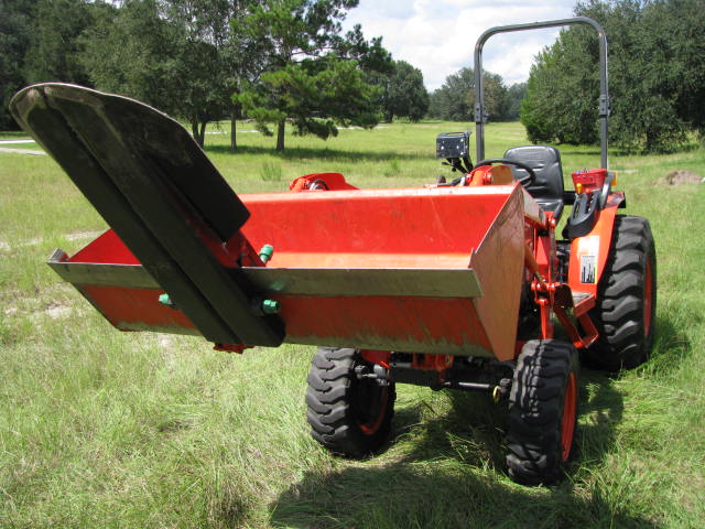

A bucket spade may be all you need for tree planting. Best clamped on optional SSQA heavy duty bucket.
LINK: Tractor and Skidsteer bucket spade shovel

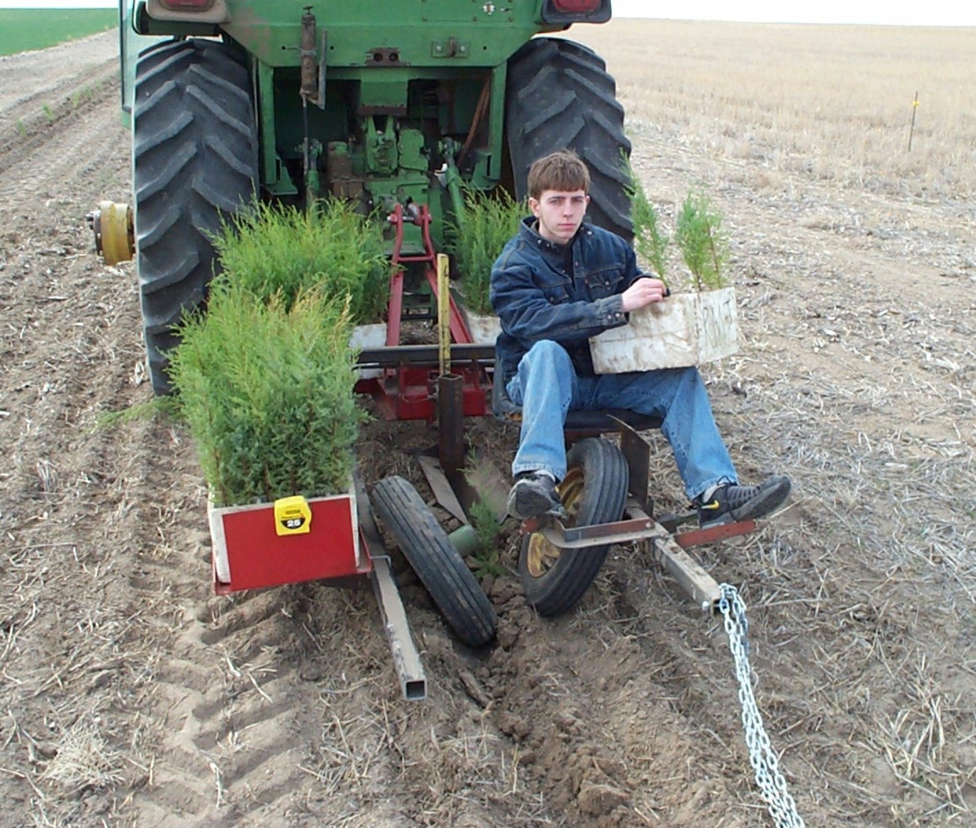

Here's what I mean by a tree planter.
Thanks everyone for your help so far.
/ Questions about purchasing first tractor #9
LOL!! That would have been my dad's idea of a tree planter too. :D He was really good a figuring out new and creative ways of keeping me and my brother busy.
With that clarification, it sounds to me like either the L3800 or L3901 will work just fine for you. I'd suggest driving both of them as much as possible, and decide if the extra features of the L3901 are worth the extra cost.
