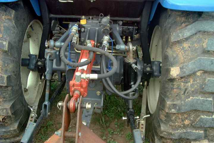

I disagree with that as a blanket statement Mad. My first remote on my tractor was $500 and the remaining two were less than $225 each. This is a stackable assembly with factory levers and hard tubing to the fittings with all mounting hardware for an easy bolt-together installation. I took 1-1/2 hours to install the whole thing with removal of the right-rear tire. I didn't have to plan, draw schematics, make a parts list, find vendors, prototype, assemble, or any of the other things that add cost to a DIY job. I just ordered the pre-engineered setup, installed it, and went to work. I think if you had done this job, you would not make a blanket statement like that. I know all New Hollands and other brands are not as easy, but on the Class III Boomers, TC35/40/45, I don't think you can beat the factory setup for cost or convenience.
I'm attaching a picture of my remotes when I was fitting up my tilt cylinder and before I got the CCI toplink. You can see how neatly the kit fits on the rear of the tractor and the stack of remote valves is visible by the right wheel. I have since also run a set of 1/4" hoses up to my rock bucket grapple. So, the three remotes for less than $1000 total are installed and allow me to run TnT and my grapple. They also are factory units with parts support and the ability to be worked on easily at any NH dealer. I think there's a lot of value in that. /forums/images/graemlins/cool.gif

I second Jim's remark as we also installed a set of 3 rear remotes on our Class III machine. Everything right down to the stickers for the controls was in the kit and it all went together without a hitch. I wish all my projects were just that easy.
