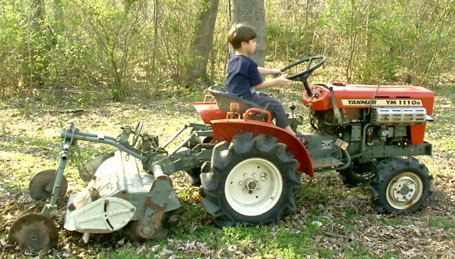

There is a definite difference in size between the 1100 or 1300 and the 1301, 1401, 1510 size tractors. Even smaller than this is the YM1110D (of which I have two...see above post).
I found that my YM1301D is almost too big to use for mowing our lawn. With the tiller on the back, it is too long and not manueverable enough for tilling my tiny garden. It is also almost too big to plow snow from our driveway.
The YM1110D is the perfect size. I put a 42" snow blade on it for this past winter and it worked great. I plan to fabricate a 42" belly mower for it, but that is another project. The YM1110D is no bigger than a reasonable sized garden tractor, and very maneuverable.
For your purposes, I think I'd get a YM1100 (not 4x4) with a tiller. The YM1100 has a differential lock, and with the high lug (rice paddy) tires, it will get plenty of traction with the rear wheels. It will easily handle a 4' finish mower, but would probably not be as maneuverable as you want with the finish mower on the back. The YM1100 is the Japanese version of the made for U.S. YM135. The YMM45 (45" wide) was the OEM belly mower for the YM135. There are still a few knocking around out there. If you can find one, you would pay about $400-$500 for it complete in good condition.
Just for your reference, I have attached a photo of my YM1110D with my son (5 yrs) tilling the garden.
