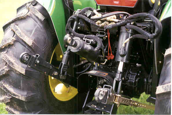

I was reading another post here at TBN and noticed someone talking about the top and tilt functionality they had installed. What exactly is top and tilt used for and how does it work? I know this might sound ignorant, but I would rather ask a dumb question than none at all! /forums/images/graemlins/blush.gif
Thanks to all!
   / Questions about Top and Tilt... #2
<font color="blue">What exactly is top and tilt used for and how does it work? </font>
See pic attachment of my top and tilt. Top and tilt are hydraulic cylinders that provide variable movement to 2 points of the 3PH. Top link can be extended or contracted depending on the type of attachment one has hitched. For example, a tractor with top and tilt hitched to a bush hog will allow the operator to tip that bush hog in a downward fashion to provide a closer cut on banks and slopes (when backing over them). Similarly, the tilt function is the side cylinder that controls the right lower lift arm. This can be extended or contracted like the top cylinder. Using the aforementioned example, one can cut more evenly across steeper slopes when tilting the bush hog at a slight angle.
Top and tilt is also useful with other implements such as a landscape rake or back blade, when one wants to angle the pitch of the tines to permit greater dragging or digging forces or when leveling sloped terrain. Others at TBN have also found TnT to be useful with box blades.
I have found the top function to be more useful than the tilt function, but both have their merits under varying conditions.

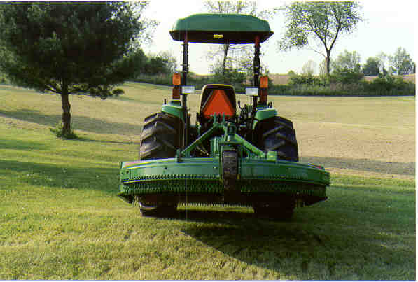

GreenMtnMan...
<font color="blue">how long have you used your Top and Tilt? I'm new to this but was told by the dealer it was mostly used for box blades so I just repeated what he said. </font>
I've had mine for over a year. Yes, many top and tilt users use TnT with their box blades. This is something I don't have but it's on my shopping list for a future purchase. I've used mine for bush hogging (a small amount) and for raking (to a great degree). See pic attached of my MX6 when top cylinder is in contracted position.
<font color="blue"> I've got a question for you - there is a bracket that connects the top hydraulic cylinder to another bracket on the back of the tractor. Is there ever a reason to disconnect that bracket? It seems to me that with bracket in place it would interfere with raising and lowering the 3ph. </font>
Yes, definitely remove that bracket. I've bent mine twice like a pretzel /forums/images/graemlins/shocked.gif when I've raised the 3PH and didn't realize how close that bracket was hanging just above the top cylinder.
...Bob

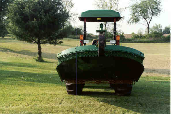

   / Questions about Top and Tilt... #8
....and here is the MX6 when the top cylinder is in the extended position.
...Bob
   / Questions about Top and Tilt... #9
....and, finally, here is the MX6 when the top and tilt cylinders are both in the extended positions.
...Bob
