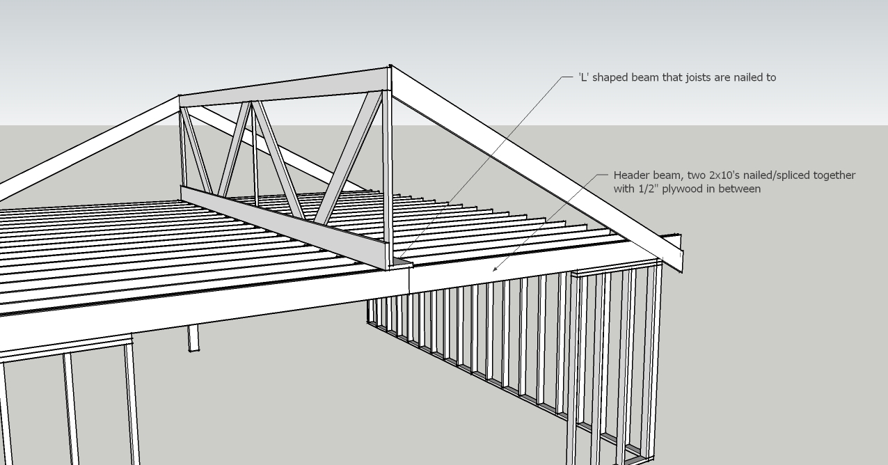

I used Google SketchUp to make the drawing. I omitted all the roof rafters, because I wanted to show the 'W' type of truss I was wondering about. My house was built in 1968 & I don't know if that type of ceiling/roof construction was the method at the time, or if that was the way my contractor did it. Whatever the case, it's been fine for 41 yr's.

I build garages, additions and homes for a living. Just one question: When you say "W Truss" are you referring to the ridge pole being supported by the W-shaped ridge pole props?

Yes, the 'W' truss I'm referring to is supporting the ridge board. I've included another view showing those supports and also another view of the 'L' shaped beam the supports and ceiling joists are nailed to. Again, I've omitted the roof rafters in order to see the 'W' support & 'L' beam.
That's nothing unique. The problem is, a lot of framing carpenters omit this type of angle brace in favor of a few simple vertical ridge pole prop.
Your "W" configuration ridge pole prop is nicely done and will keep the ridge pole straighter and stronger than vertical ridge pole props.
