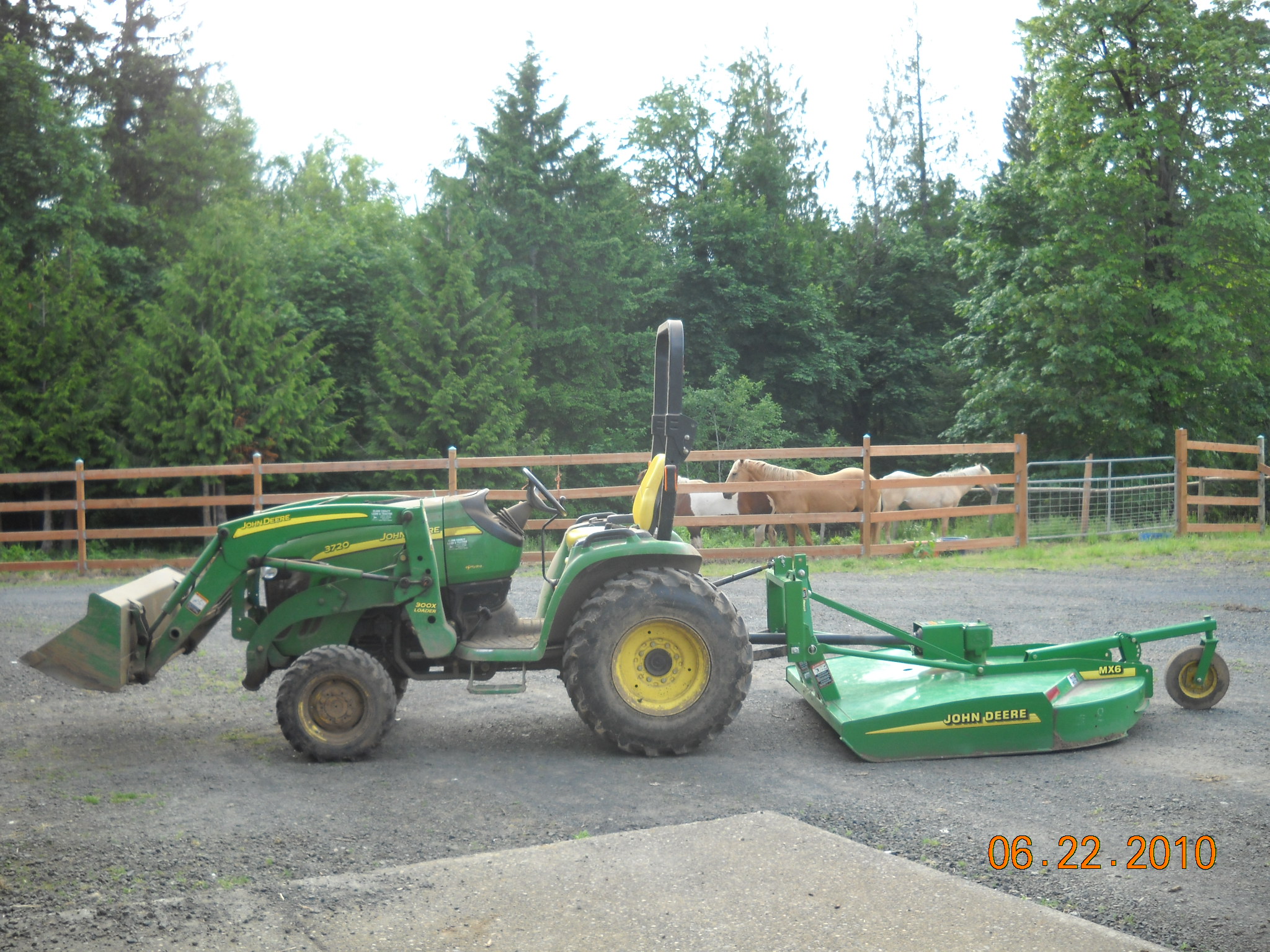

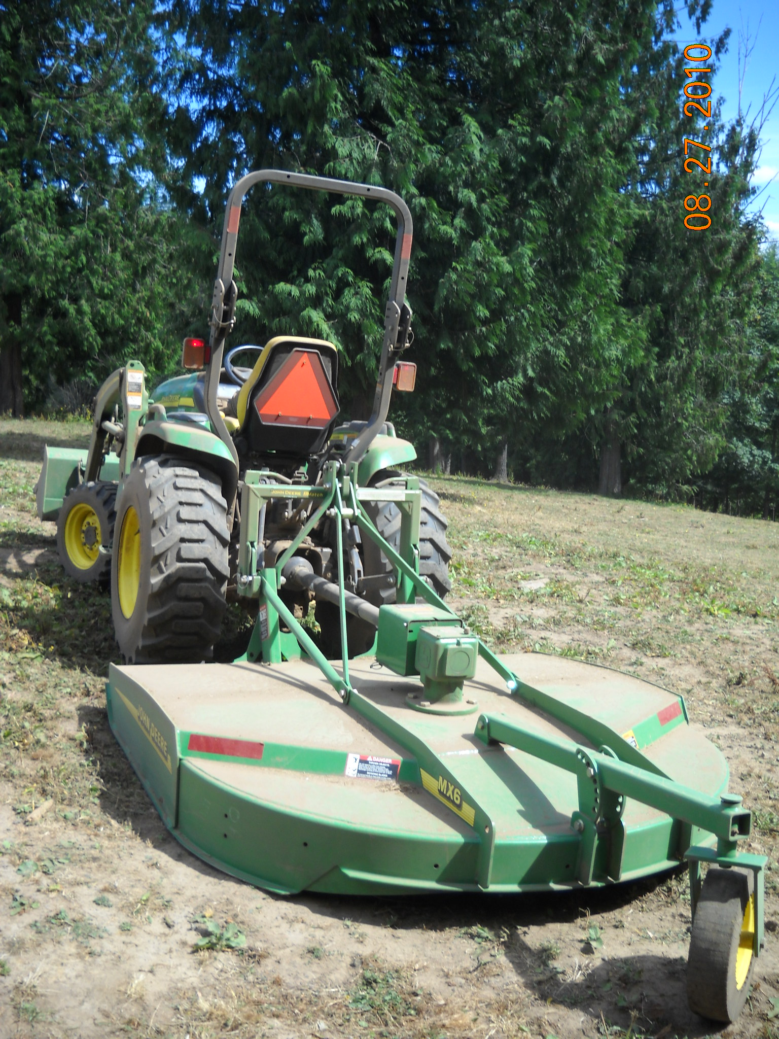

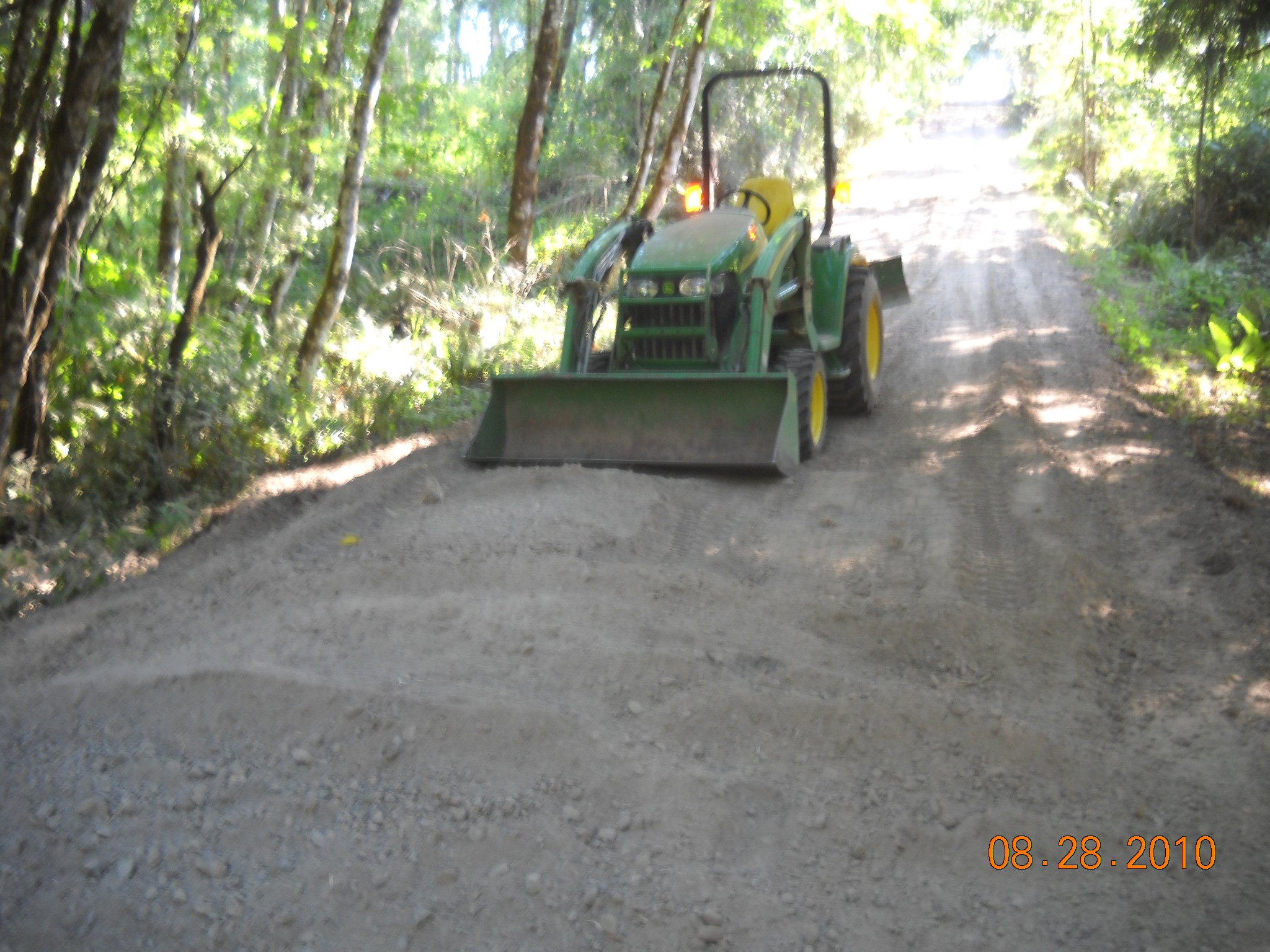

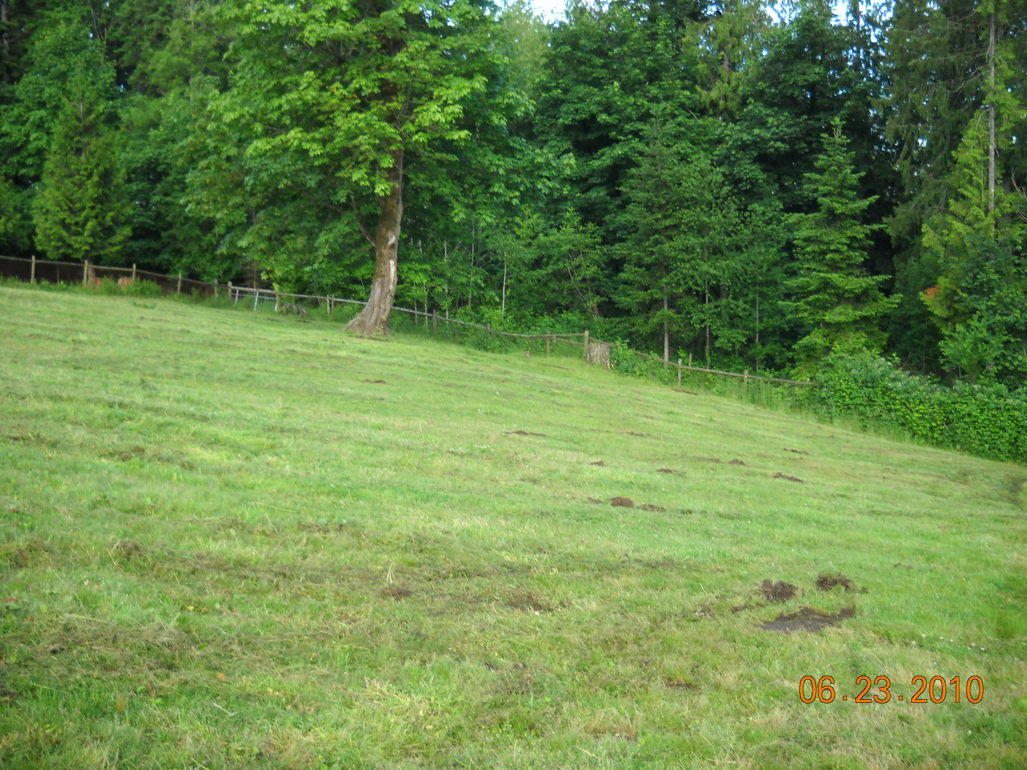

With my dad's 3720 I have found it very tippy on hills. When ever I mow I have to go straight up and down the hill. The R4's are very good with load capacity and hold up well. We run an MX6 mower on the 3720 in thick grass and it runs it pretty good, although if you hit something and the mower slows down a bit, the tractor will shake for a while as the MX6 gains speed again. The 300x will not lift a ton of pellets out of my Dad's truck but it will lift 2000 pounds of natural stone just high enough off the ground to move but when it is not ballasted it will not. The cruise control is nice but we don't have the feature where you can press a button to feather a speed change so the stop is rather abrupt. With the load match, from my experience the load match has no effect in C range but it is better in B range. Over all, it is a great tractor, with proper ballast and equipment, it will do most everything.
