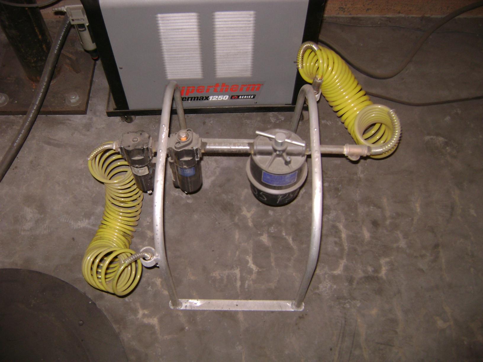

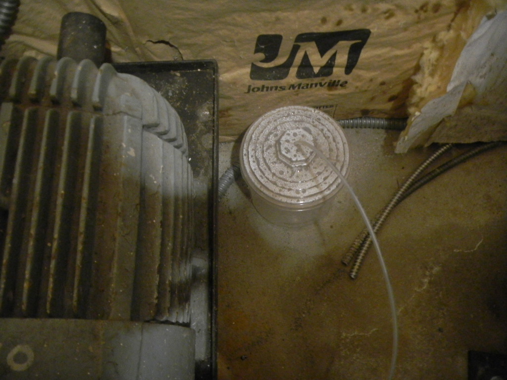

The IR cooler has an automatic drain also. I use a Motor guard filter system also.

   / Questions for TBN members who own plasma cutters #14
Hypertherm is the brand you want. It meets your criteria and is the 妬ndustry standard in a lot of ways. They also have figured a way to bump voltage a bit from most others so it will cut more for a given amp draw- you will have to dig deep in the specs, watch some YouTube videos or call them to fully understand how it痴 done.
Dead on right. Great machine. You want clean dry air but other than that, not fussy. They will cut it, rusty, dusty, dirty, cast, or rolled. I recently tore apart an old damaged square grand piano and liked the intricate cast design in it. I cut all the unwanted cast iron away with my PC and had not problems doing it - even though the thickness was above the posted maximum for my machine.
