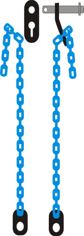

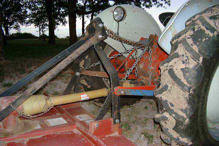

David, I don't know about your Kioti's lift, but there is a very simple way to limit the lowest point to a fixed height and still allow the lift to be raised when needed for transport. It involves using chain from the toplink pin on the tractor to the pins on the lift arms. The chain attached would look like this photo of my old Ford. In addition to the photo and illustration, here's a link to how to make a set of chains. I found mine at a dealer, but I don't think they are common.
EDIT: In the photo below, my toplink is replaced with a chain, but the lift limit chains work equally well with a rigid oem toplink.

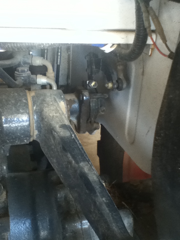

Jim from his last post, it appears that the 3pt is not dropping unless the lever is moving, and the lever is moving on its own. Of course you could slide the little lever limiter stop up the lever channel and screw it down and that would prevent the lever from moving down on its own. but he needs to figure out why that lever is moving on its own anyway.

When I was bush hogging the lever was shoving down the little twist lock. I could not get it tight enough.
Where the heck is this nut for the lever! Do I need to take the console apart?
David
   / Questions/Observations operating my 3pt Hitch - Won't stay up! #38
You may not be able to see the nut, but you should be able to reach up from underneath and feel it with your hand and put a wrench on it and tighten it up.
Now that I think about it, you might be able to tighten the nut up just by putting the wrench through the lever slot in the console. :cool:

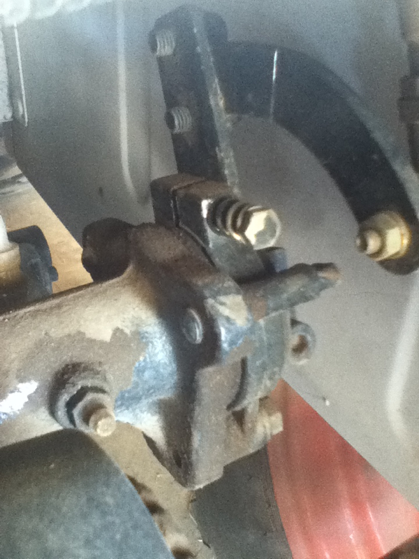

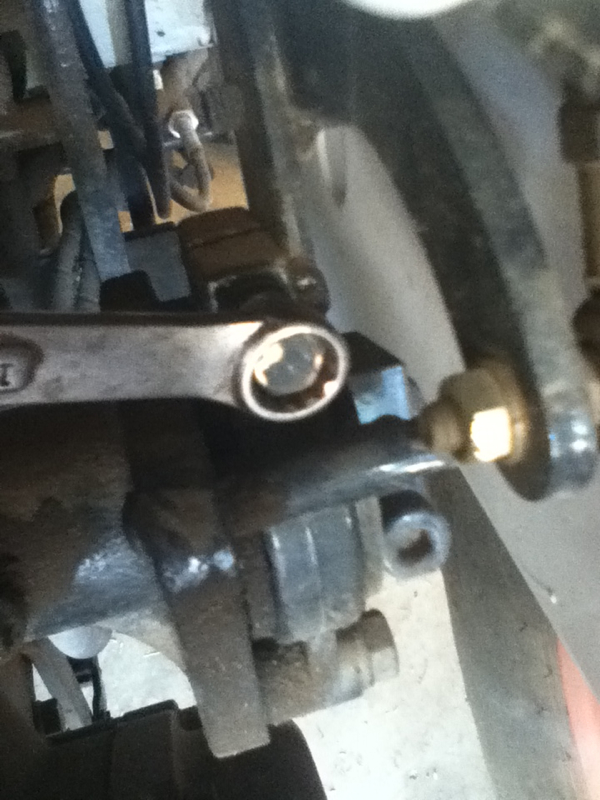

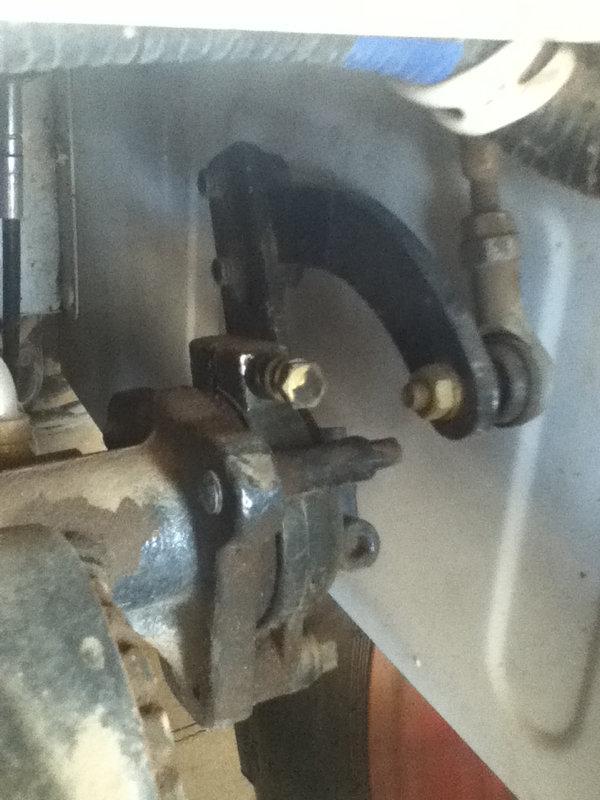

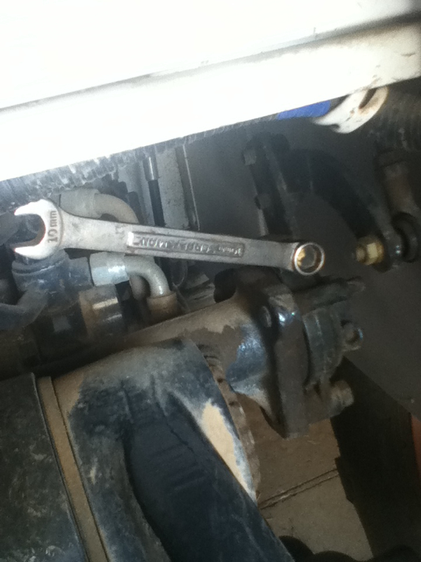

I had that problem on my bobcat. There is a tension nut with a spring mine is a 10mm wrench! Try clockwise tightens and just get it to a perfect firmness,

David, this seem on the right track to me, Our tractors are different than these photo, bacause we have draft control and the Bobcat does not.. so there are 2 of these 10 mm cap bolts, and they are not as easy to get to as this one either. You will need a 10mm socket and an extension to get to it. You will want to tighten the one on the right as you look at the linkage and valve axle assembly from the back of the tractor, If you notice carefully there is a compression spring under the 10mm cap bolt. Observe how the position control is the center axle shaft of control, and the draft is the outer shaft when you tighten down on that collar, it should squeeze down on that shaft that the position control is attached to and give it more drag. What worries me though is you say the position control requires some force to move it toward the down direction now, indicating there is drag now. and you said that even by moving up the little thumb nut stop device in the path of the control was not enough to keep the control lever from moving down.. That bothers me a great deal. because the combination of the position control drag and the thumb nut stop, would be considerable force, in the region of 30 or more pounds of force? Maybe? Please confirm. what you find.
