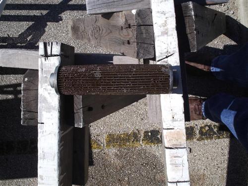

"I've always run it with the valve almost closed in order to slow the drop rate and keep it from slamming the ground."
I'm sure that's your problem. Keep that valve completely open ccw, and control the drop rate with the little red handle under the seat.

With the big knob fully open it still sounds as if the pump is starving at high RPM's
   / Questions on 2020 #30
Did you clean the hydraulic screen? Do you have the correct hydraulic filter?
Danny
   / Questions on 2020
#31
Yep, cleaned the screen, and have proper filter.
I tried to reach up in the hole and clean the inside which had some sludge looking stuff, couldn't reach it all. Wonder if it picked up some more stuff and partially stopped the screen again????

</font><font color="blue" class="small">( Yep, cleaned the screen, and have proper filter)</font>
Guess I didn't have a proper filter /forums/images/graemlins/frown.gif /forums/images/graemlins/frown.gif /forums/images/graemlins/frown.gif
Just on a lurch I put the old filter back on and it works fine now /forums/images/graemlins/laugh.gif /forums/images/graemlins/laugh.gif
I guess the NAPA 1229 just didn't have enough flow for it. /forums/images/graemlins/mad.gif /forums/images/graemlins/mad.gif

I guess we all had better do some checking. That NAPA filter is on a bunch of tractors.
   / Questions on 2020
#35
</font><font color="blue" class="small">( I guess we all had better do some checking. That NAPA filter is on a bunch of tractors. )</font>
They may work on a bunch of tractors, or I may have gotten a bad one, but it is quiet and quick at all rpm's now. I even mowed about a half acre to test it. I don't have to worry about moving my FEL over on it now. (That is after it gets a nice paint job.)
