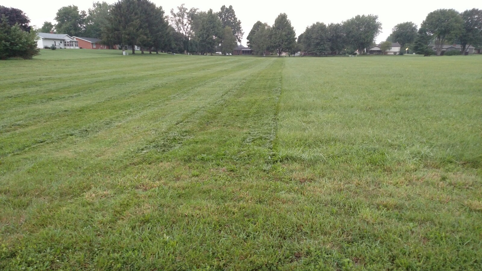

This kind of stuff I can regularly mow at 5-6 MPH with ease
And this is basically a yard that got mowed monthly. (13 acre yard). Just too heavy for a ZTR, But extremely light for a rotary cutter. IT was ~12" tall stuff, cutting down to ~5". This was WOT, pedal to the floor, M range. Couldnt ask for a better cut...

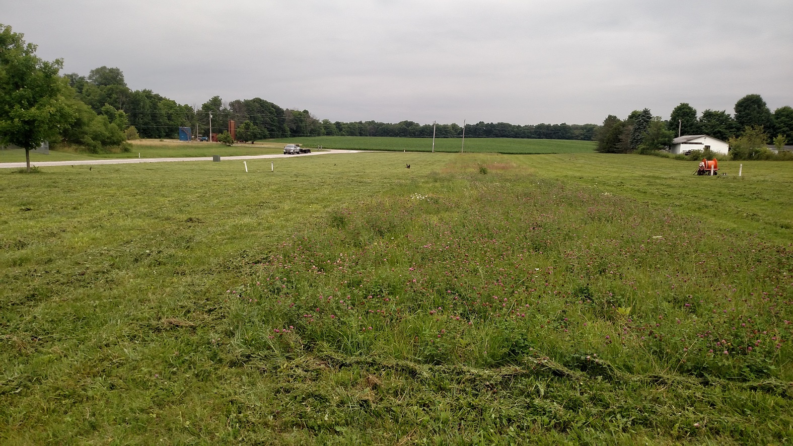

Just some of the regular stuff. All mowed ~7MPH
This is where I start to slow a but for quality. This was ~5mph
