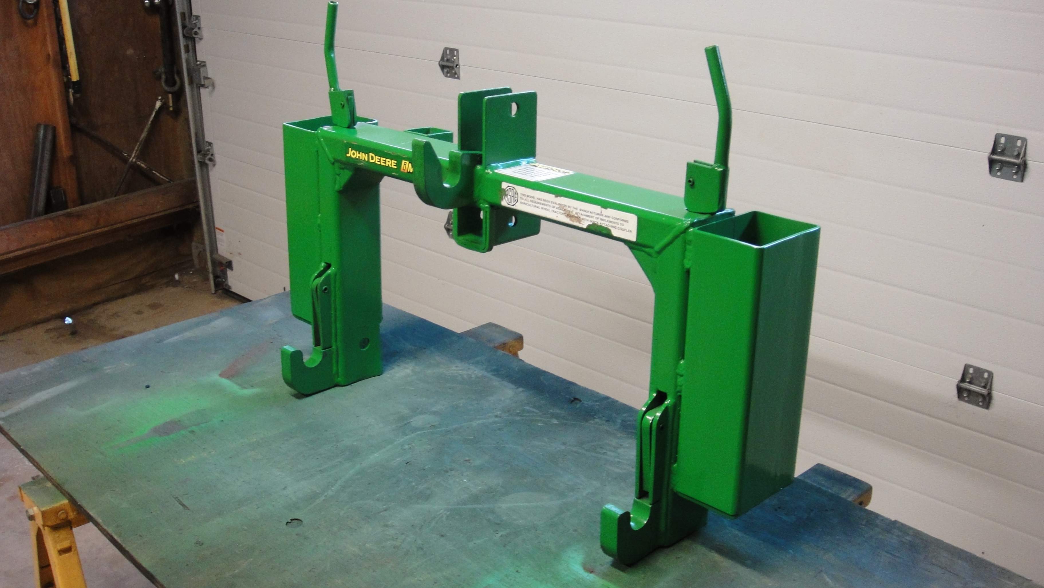

Mine never comes off, Coupled with a HTL it is so easy to engage implements, don't even have to stretch to far to reach the locking levers.
When I first got my tractor I thought I wouldn't benefit from a QH, and didn't get one for 2 years. I would not be without one now.
I've got a mis match of several different brands and ages of implements, so it took some modding, but so well worth it I don't even think of it as a hassle in any way.

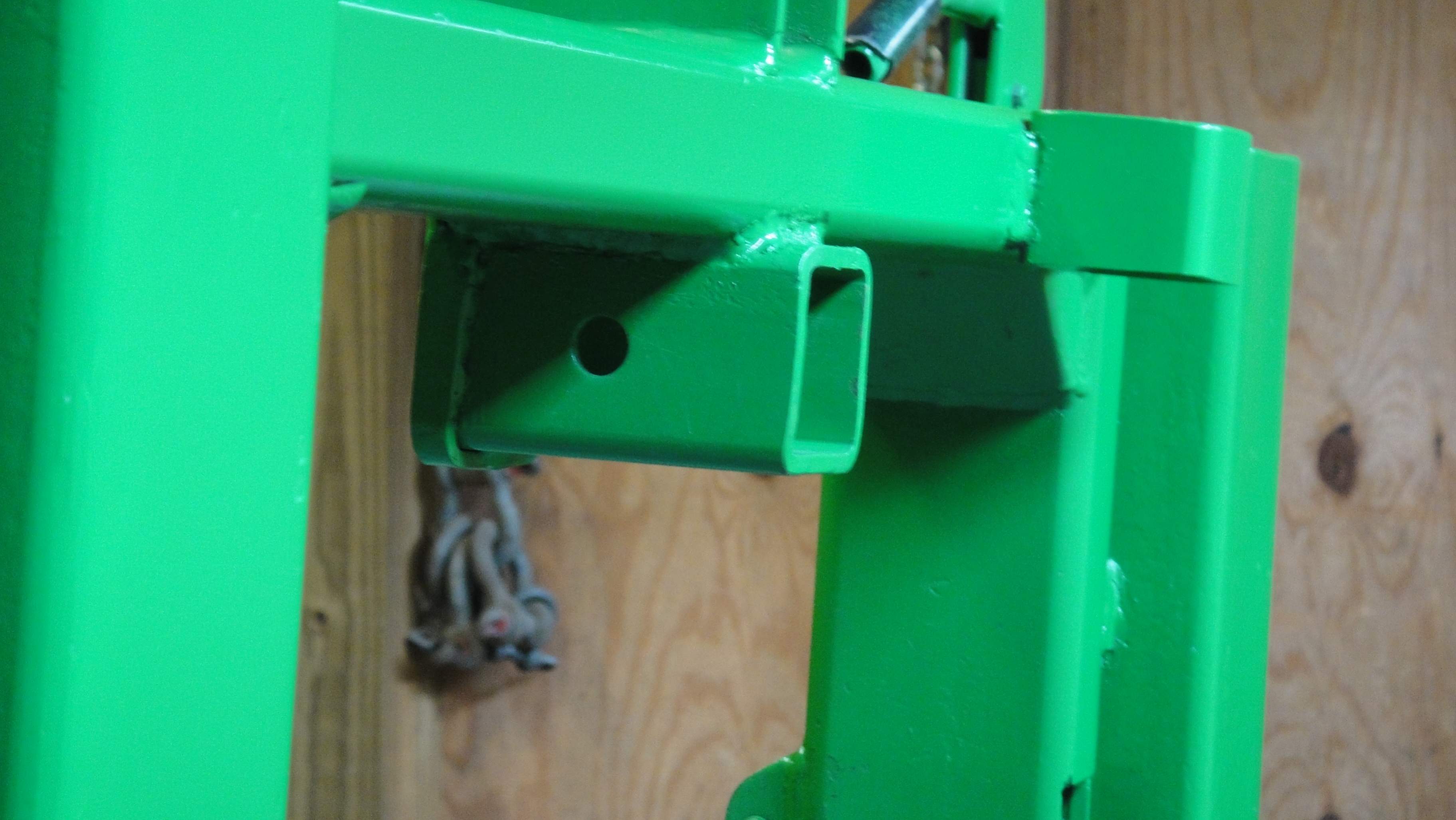

I put a receiver tube and some stow boxes on mine recently.
JB
where can I find the receiver tube or did you build it..?
I would like to try this on mine....thanks :thumbsup:
Harbor Freight has them for around 20 dollars. You do have to weld them on.
JB.

JB did you have to cut the top section of the reinforcing collar off so it would weld flat to the bottom of the Imatch..?
found this one at tractor supply
Farm & Ranch Receiver Tube, 6 in. - 1890987 | Tractor Supply Company
Yes, not sure how much that extra pc is needed but I left it on.
You have to cut the length as well, so you might get 2 parts out of that one from TS. (the one in the picture is not 6") That extra ring is to prevent the tube from splitting at the seam, I put the seam up to the area it's welded to, so it could not come apart there.
JB.
